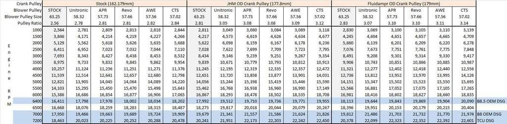

I tossed this in the AZ thread, but I thought you guys might want to see it too. I haven’t included the GMG pulley yet, because I haven’t found the size yet. I’m hesitant to use the flange-to-flange measurement to compare to the others’ measurements from the ribs.
http://i1028.photobucket.com/albums/y350/Danmccarthy23/Audi%20S4%20Blower%20RPM_1_3_2016%20V3_zpsvjxzpjbf.jpg
Fluidampr is in there now? LOL
