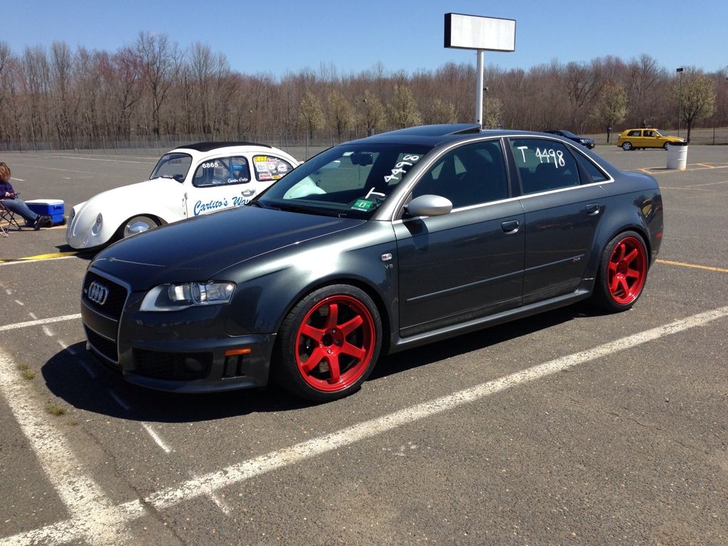

Saki- who’s this?

Spoke to a guy in stands who claimed to have spoken to the owner. Said it had JHM tune and exhaust. I would like to know 100% though since I didn’t speak to the actual owner
That wheel color is a little off…
Someone brave lol. I think it looks badass. Needs some tougher elements though like black window trim and a window tint. I love Volks…wonder what size those are. The ones I see around are always (annoyingly) 18x7.5
Are those winters? edit: they look like PSS maybe.
There is a guy named dufferdude who appears to have a similar looking RS4 in his avatar…however dtoys4.2 just claimed the pictured car as his own. He is from Queens
http://www.audizine.com/forum/showthread.php/535777-Whose-rs4-was-this-at-E-town-Sunday?p=8643739&viewfull=1#post8643739
Was he there lapping or something? Nobody seems to have seen him run the dragstrip.

The car looked ridiculous, my favorite wheels of all time. My guess is 18x10. Tires were PSS 275/35/18 and had a slight stretch. He was running. I personally saw him run once but he missed 3rd and ran a 13.5@105 I believe. My girlfriend saw him run 2 12 second runs though- atleast that’s what she told me.

His name is Sunil. I think Tony knows him. Ironically Tony started the thread asking whose car it is on AZ.
I don’t think he’s serious- if I’m correct that kid Sunil has a slammedddd imola RS4
