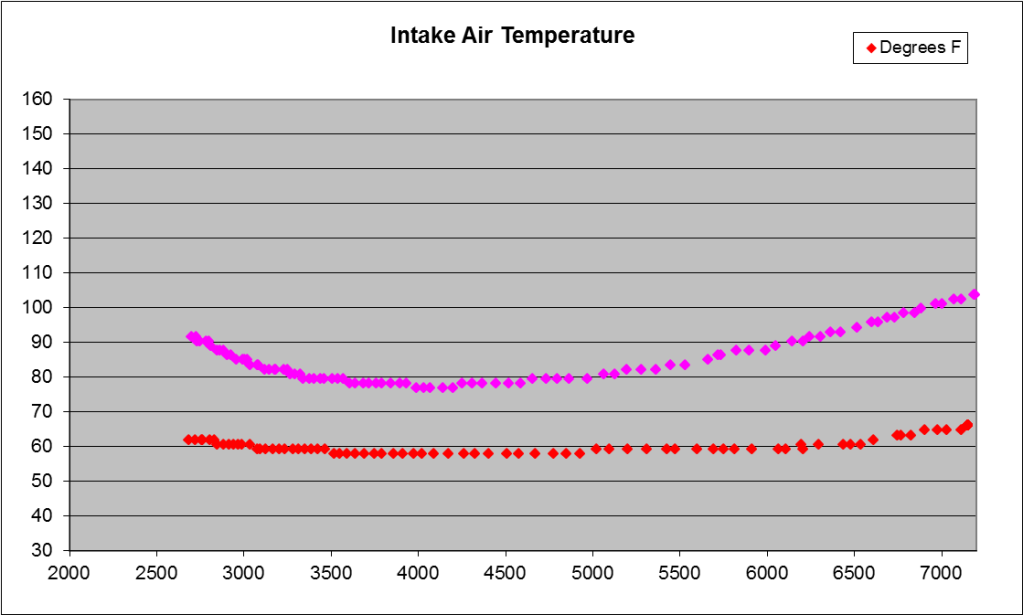

So the upgraded intercoolers made a big difference.
still only at 32 psi now on er’s (red) vs 29-30 psi on ebay fmic (pink)
http://i714.photobucket.com/albums/ww142/judeisnotobscure/77029psifmicvs32psier.png
Yikes that’s a pretty huge difference.
Wonder if conditions or any other factors changed.
Whens he going back?
iat’s were 30*-40* cooler on the run with the er’s :wink:
amazing what a set of intercoolers can do.
Hopefully returning to the track soon… gotta do some exhaust testing.
ebay fmic (pink) vs. Er’s (red)
http://i714.photobucket.com/albums/ww142/judeisnotobscure/770ervsfmic.png
Conditions the same though (ambient temps)?
Conditions the same though (ambient temps)? Notorious vr recently said he didn’t really feel there was a huge diff between ebay fmic and ERs.
Temps should be within 20*
Temps with the er’s should be higher since they were more recent and the fmic logs were done in early april. both at night near Boston.
I don’t believe NVR would say such a thing. The difference is clearly huge.
Response time should be better too with less charge piping. That means quicker re-spool and hopefully quicker 1/4 mile
Wow… nice to see the diff. Now he needs better exhaust :slight_smile:
