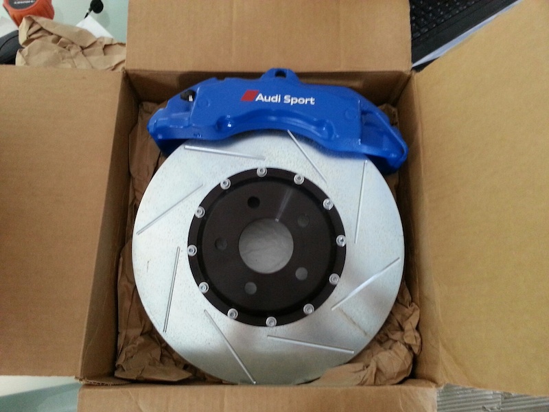

18z calipers with JHM 350mm lightweight rotors for the front

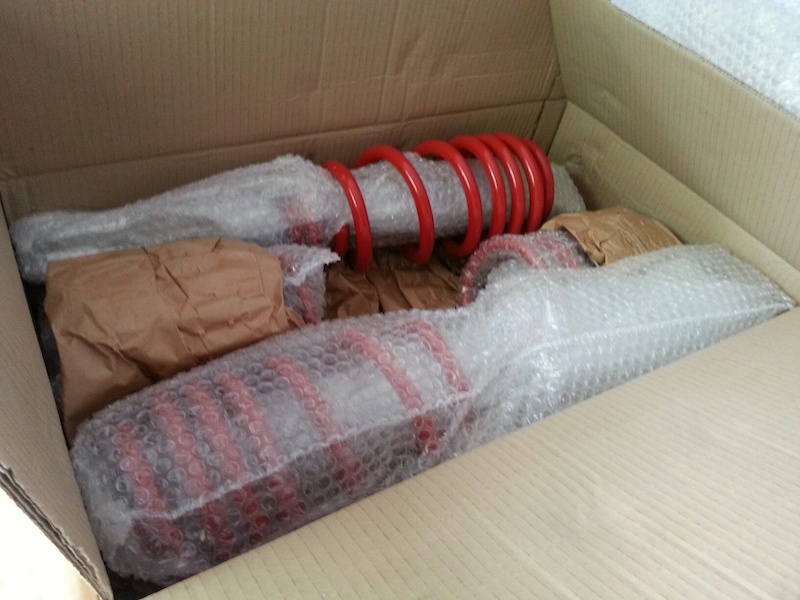

H&R coilovers at an AMAZING price from ECS. Went with the Avant quattro version, although it does not specifically list the S6 as compatible.

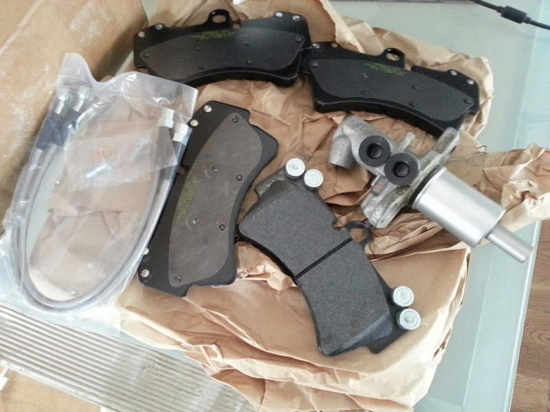

Hawk ceramic pads, SS brake lines, and RS6 master cylinder

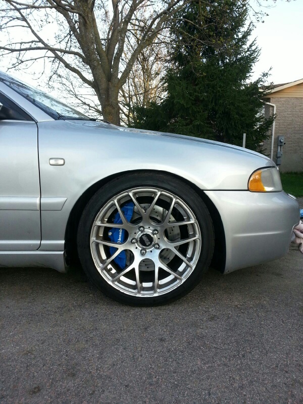

I sold one set of my 17z to a guy with an A4. They look incredible on his car

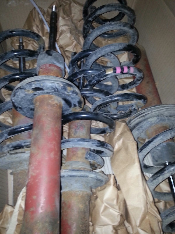

The stock S6 suspension was swapped for H&R coilovers. The springs that were removed from the S6 don’t look too old. I was looking for markings, but all I could find were some pink and brown stripes. Are these the stock C5 sport springs?
