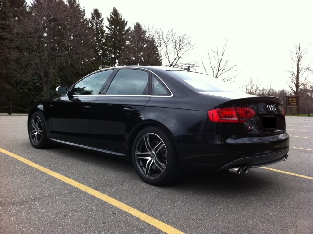

Ill try to dig up a pic somewhere!

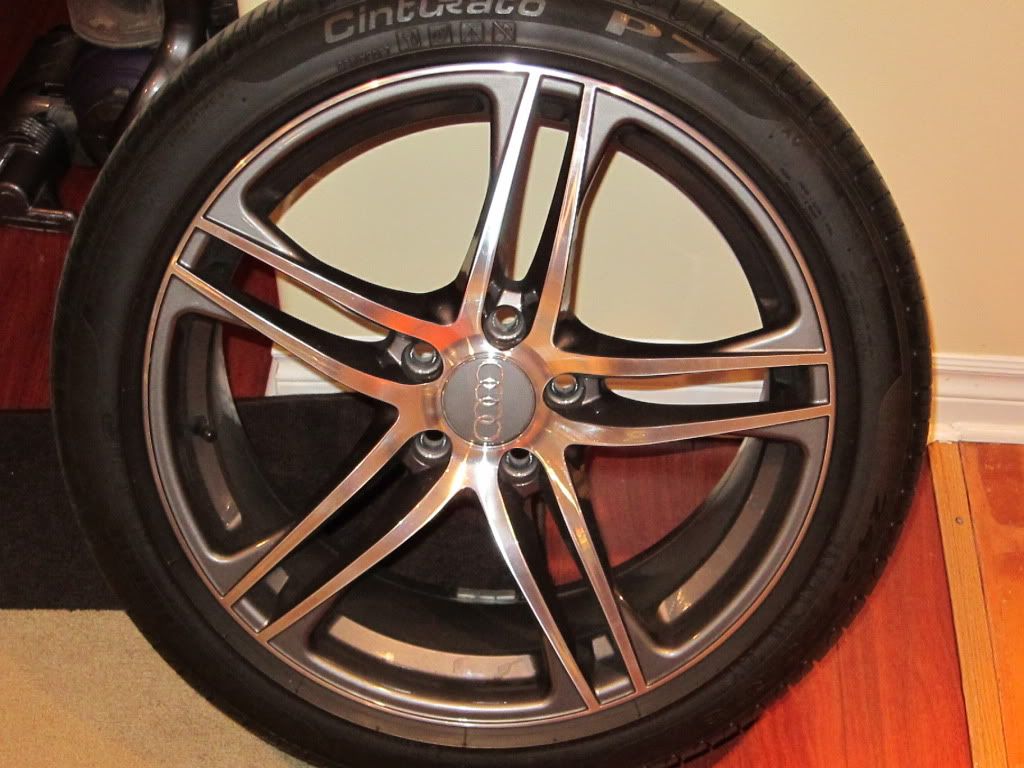

R8 reps 18X8 (or 8.5) 18.5lbs a piece.
17x7/17x7.5 more bitch looking? Might work for me, I’m trying to make my car look less S4-ish and more sleeper
81: Nice, which R8 reps?
Don’t really have any good pics of the rims so these will have to do.
http://i1217.photobucket.com/albums/dd384/81bear1/photo-R8.jpg
http://i1217.photobucket.com/albums/dd384/81bear1/R8_Wheel.jpg
