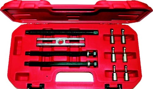

Just ordered one of these.
http://ecx.images-amazon.com/images/I/51XWYII4BzL.jpg
Looks like the balls in that bearing are roughly 11mm in diameter, hopefully this tool works out.
