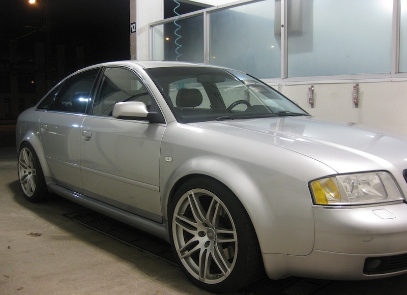

http://gp1.pinkbike.org/p4pb8717608/p4pb8717608.jpg
The car is a daily driver, but I still have some ambitious performance goals. I hope to get the car to low 13s/high 12s. This is the first time I have ever really modded the engine of a vehicle, and I am finding out that things don’t always go as smoothly as planned. After having the S8 parts installed, I expected to be pretty close to completing the engine portion of the project. However, that was not to be the case. Without getting into all the details, there seems to be a problem with one or more of the engine components allowing unmetered air into the system. That is what it looks like at this point, anyway.

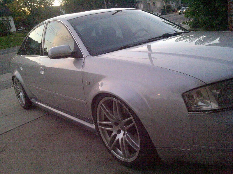

haha nice car. Those are OEM RS4 wheels? OEM RS4 are 9.0 x 19.0 ET29. I would have thought those would be more flush on an A6?
Car looks great. Love the widebody 4.2 A6.
Thanks!
Yup, real OEM RS4s. I actually bought them from the guy that owned the RS4 them came off. First thing I checked when I bought them was the back of the spokes to make sure they said 19x9 ET29.
When I first put them on, my car was a bit higher, and I ran them with 15mm spacers to bring them out a bit. There was a little bit of rub in the back though. I bought 8mm spacers, but had a fitment problem so I never put them on. So right now, they are at the stock offset et29. Here is a pic of when they were at et14 with the spacers
http://gp1.pinkbike.org/p4pb7434658/p4pb7434658.jpg

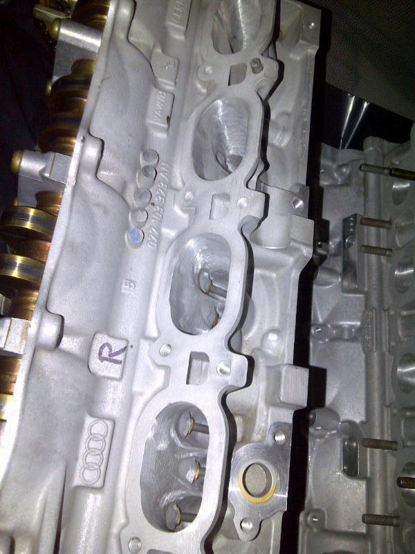

Port and polished S8 heads
when I got them
http://gp1.pinkbike.org/p4pb7344167/p4pb7344167.jpg
http://gp1.pinkbike.org/p4pb7344168/p4pb7344168.jpg
After Gord Bush worked on them
http://gp1.pinkbike.org/p4pb7925549/p4pb7925549.jpg
http://gp1.pinkbike.org/p4pb7925551/p4pb7925551.jpg
http://gp1.pinkbike.org/p4pb7925550/p4pb7925550.jpg
