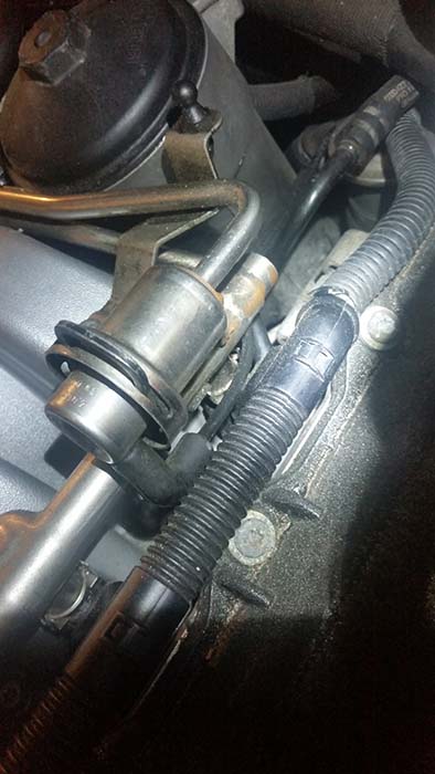

In the picture above it looks like that vacuum hose is between the oil filter and the back of the intake manifold. The T fitting for the secondary air injection is connected so that is a good sign. Can you take more pictures of the area around the intake manifold?

I hope these help
The line from the fuel regulator is going into the rear of the intake manifold, the lines from the kombi valves is going to the front of the block. All of them look newish, and where the lines connect to the kombi valves there is not a clamp as I have seen on my 2.7.
not quite sure why I kept typing kombi instead of Combi or EGR
i think we all know what your talking about.
The fuel reg line needs to go from the reg to the intake. That is how the car knows the fuel pressure needs to rise.
As for the SAI valves or combi valves thats right too. They need to connect to a Y and then go to the front of the motor to the solenoid that controls them to open if its cold enough

Did you trace the line on the fuel reg back to its original spot on the front of the car for vac. If that regulator vac line isnt right the fuel pressure isnt going to rise right and your car is going to fall on its face and loose power.
Those factory lines can crack easy and cause a lot of issues. Sounds like your finding out each step of the way that there are a few issues. Vac lines are usually a big cause of most headaches.
