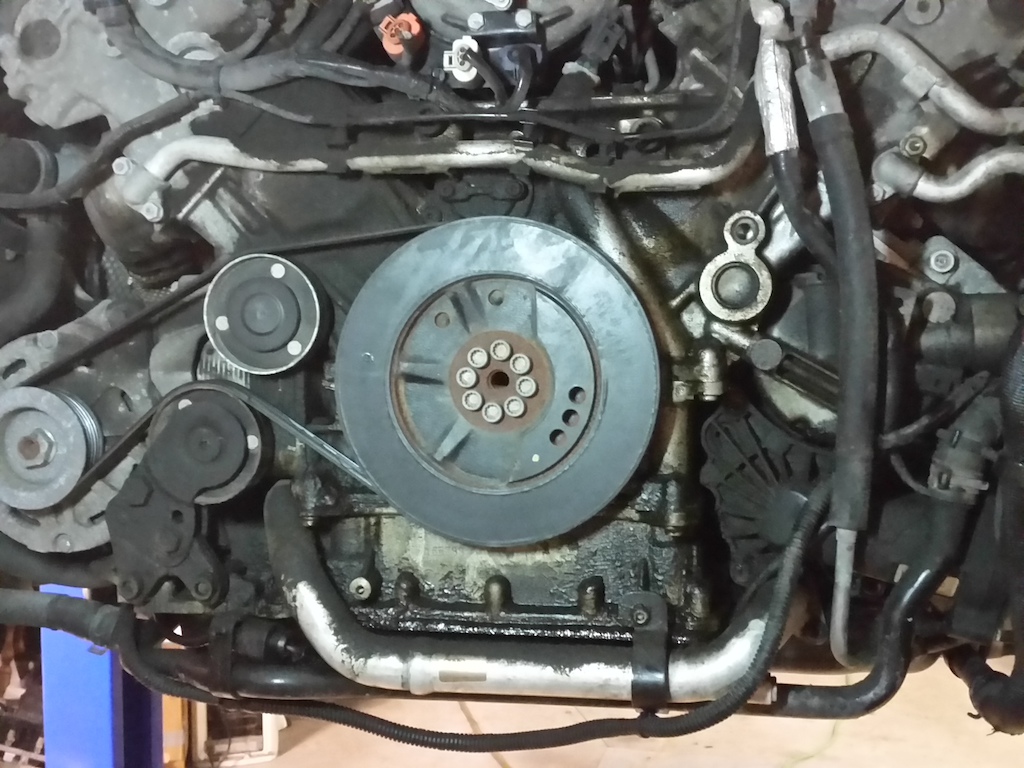

Looking for a picture of the front of the engine. The bentley manual I have doesn’t have a good diagram of it and I would actually rather see an actual picture of the front of the engine.
Here’s the details on the leak:
It’s intermittant, and only when the engine is at operating temperature. Does not leak while car is parked, does not leak (or appears not to leak) while the car is running. It basically spits out oil from somewhere when the engine is cranking. This car has 120,000Km on it (75,000miles)
Checked the oil pans, but oil is coming from higher up then the lower oil pan… about mid way up the engine block.
I am leaning towards crankshaft seal or oil pressure switch. I have some more troubleshooting to do, but if anyone has had an oil leak like this I’d like to hear what your story was with it.

My intuition points towards the crank seal… but oil appears higher then that.

I have a hard time now thinking it’s the oil pressure sensor, but I will just have to take the front end apart to know forsure.
I’m also contemplating if it would be the valley seal, but don’t know what the bare block looks like. Oh well, it’ll be a bit of a research project.

Higher than the crank seal - that is strange because all of the oil lines & connections are towards the back - unless you have totally filled up the valley with oil :slight_smile: Lift the back of the car and see if more pours out?

Any chance you can sneak us a pic of what your looking at or see. The big one is usually the valve cover gaskets leak. They tend to leak heavy in the lower section where the oil pools and drains down. Anything you can show pics wise would help.

All I can think of is the same as Justincredible has said. There’s not much else that can leak from that point.
I had a similar issue in the fall.
Turned out on mine it was the seal at the base of the Oil filter pedestal where it meets the top of the motor. It pissed oil out only under load and filled the valley. The valley has drains running to the front of the motor making it look like thats where the leak was.
If you have the intake manifold off check those seals.

The fact it doesn’t leak other then when running and even then its intermittent, and the height of the oil leak and it being from the center of the engine.
