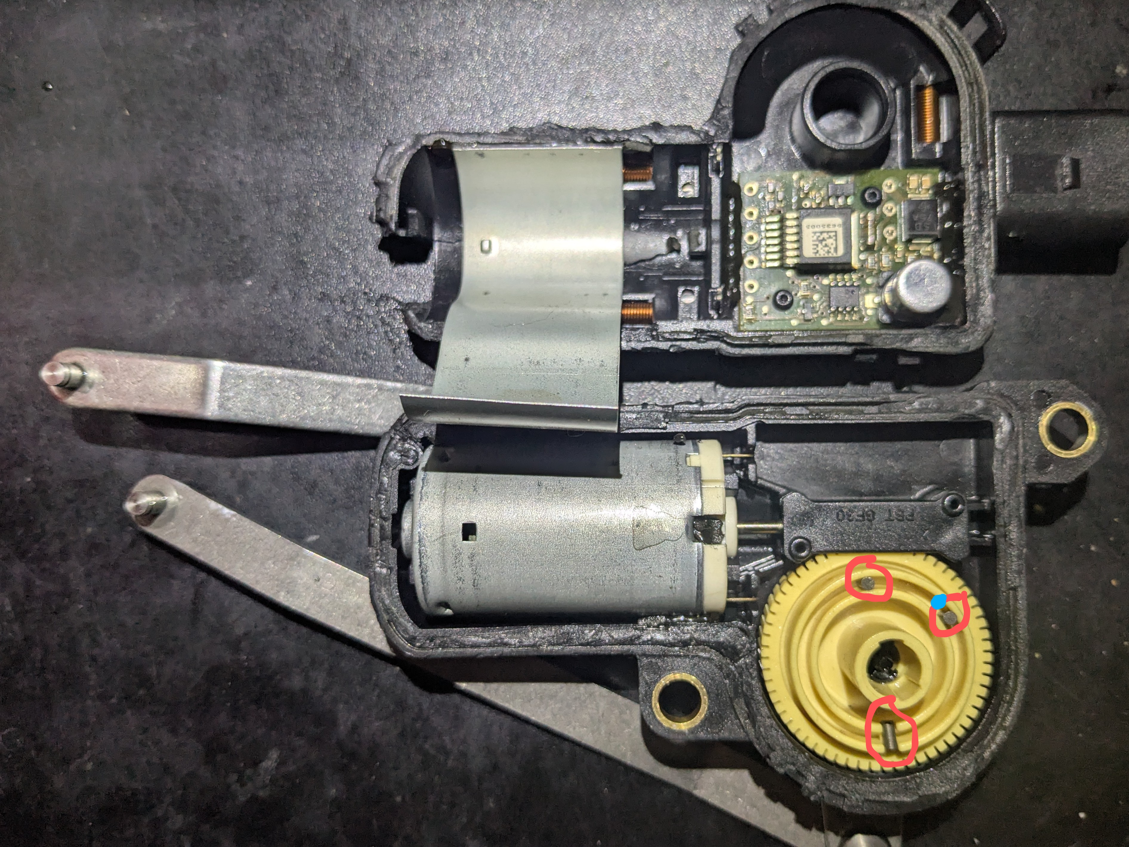

So car runs perfect but for some reason getting p2007 intake runner stuck closed bank 2 implausible signal / upper limit exceeded which gives an obnoxious engine light. I have loosened the manifold checked flap movement, wires, new position sensors, position sensor spacers, failed 142 adaption, still get code. So I took the flap motor off and opened it up. There are 3 locating magnet dowels internally on the gear, when I first opened it 2 were directly next to each other one slightly leaning on the other. Also looked like it moved inside the track to where it was. Has anyone ever opened one and or has pictures of the internals to verify these pin locations? Also where are people buying these it seems like they do not manufactured them anymore.

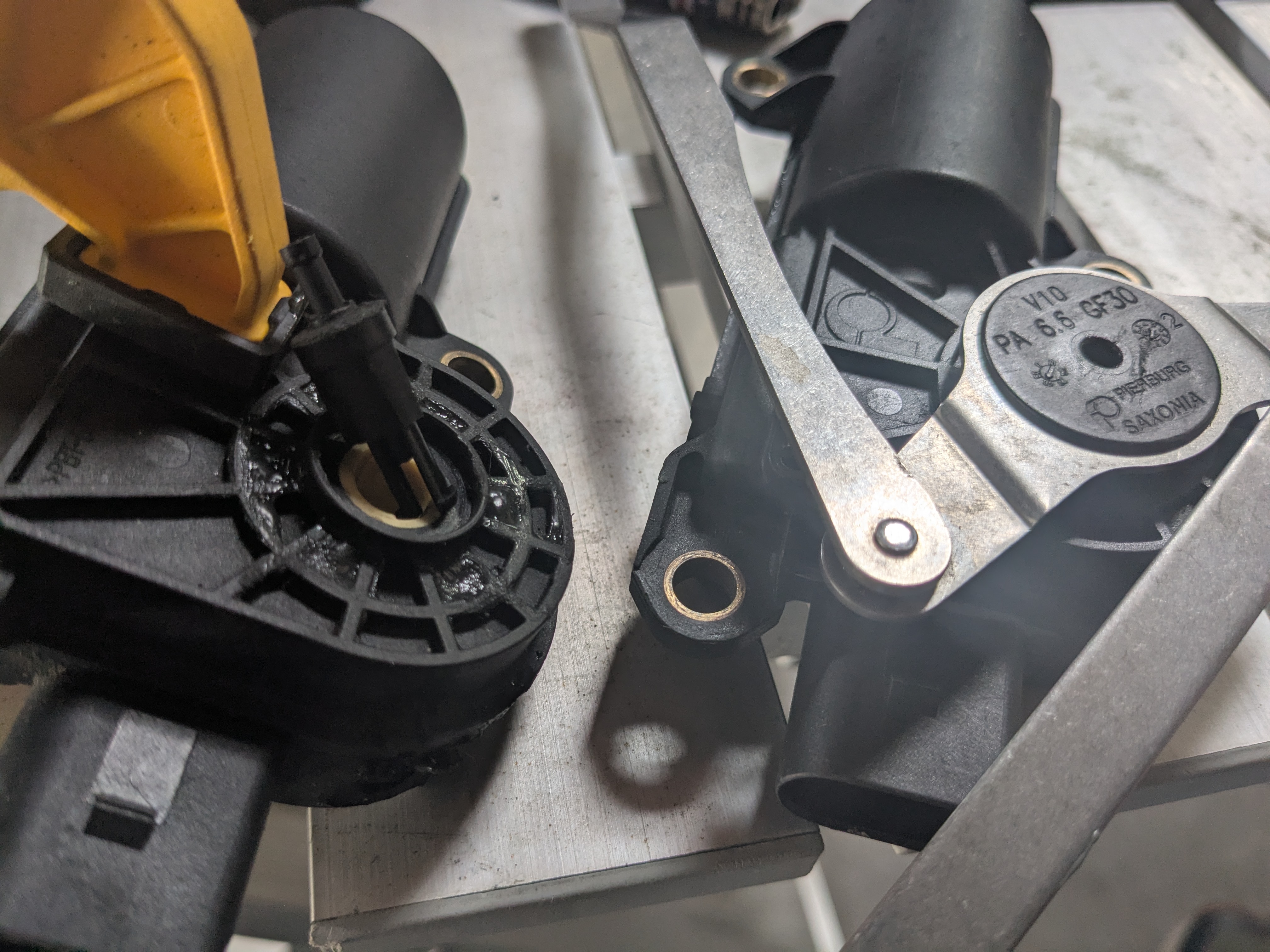

For future reference for people as these are no longer manufactured abundantly, both upper and lower actuator motors are the exact same, the only difference is the arm installed on it. It is possible to crack them open. Once there facing the gear side, with a straight pick push the center locking dowel out, you can then push the tabs inward and push the entire arm assembly off them and change them out.
