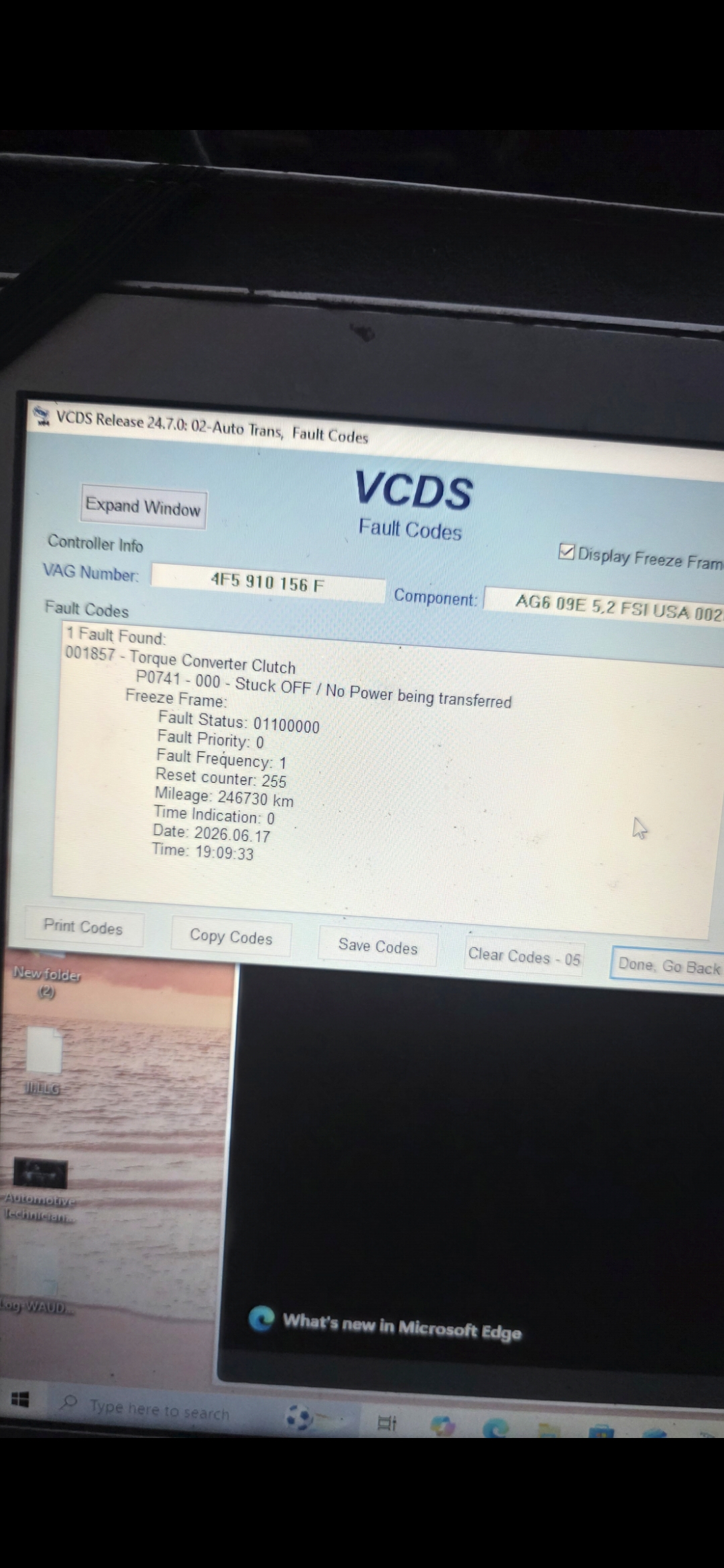

Hey guys so recently I just got this code about the torque converter which is stuck off/ no power being transferred. I did clear and change the fluid 2 times hoping for some miracle and sadly nothing.
What are my options? Im guessing ill have to change the trans? The trans in the car is a khd and I do have spare trans which is a jms.
Does the car drive? If yes, check for torque converter slip in VCDS. Maybe only TC solenoid failed?
It does drive and what would I be looking for on the slip on vcds? Also prior to this code Its been slipping because i would feel it when i drove but whenever the trans would get warm id say around 75c it would occur and i did change fluid a couple times due to that but now It seems to be constant ever since the code has came. Since the code came i changed fluid two times and no luck.
