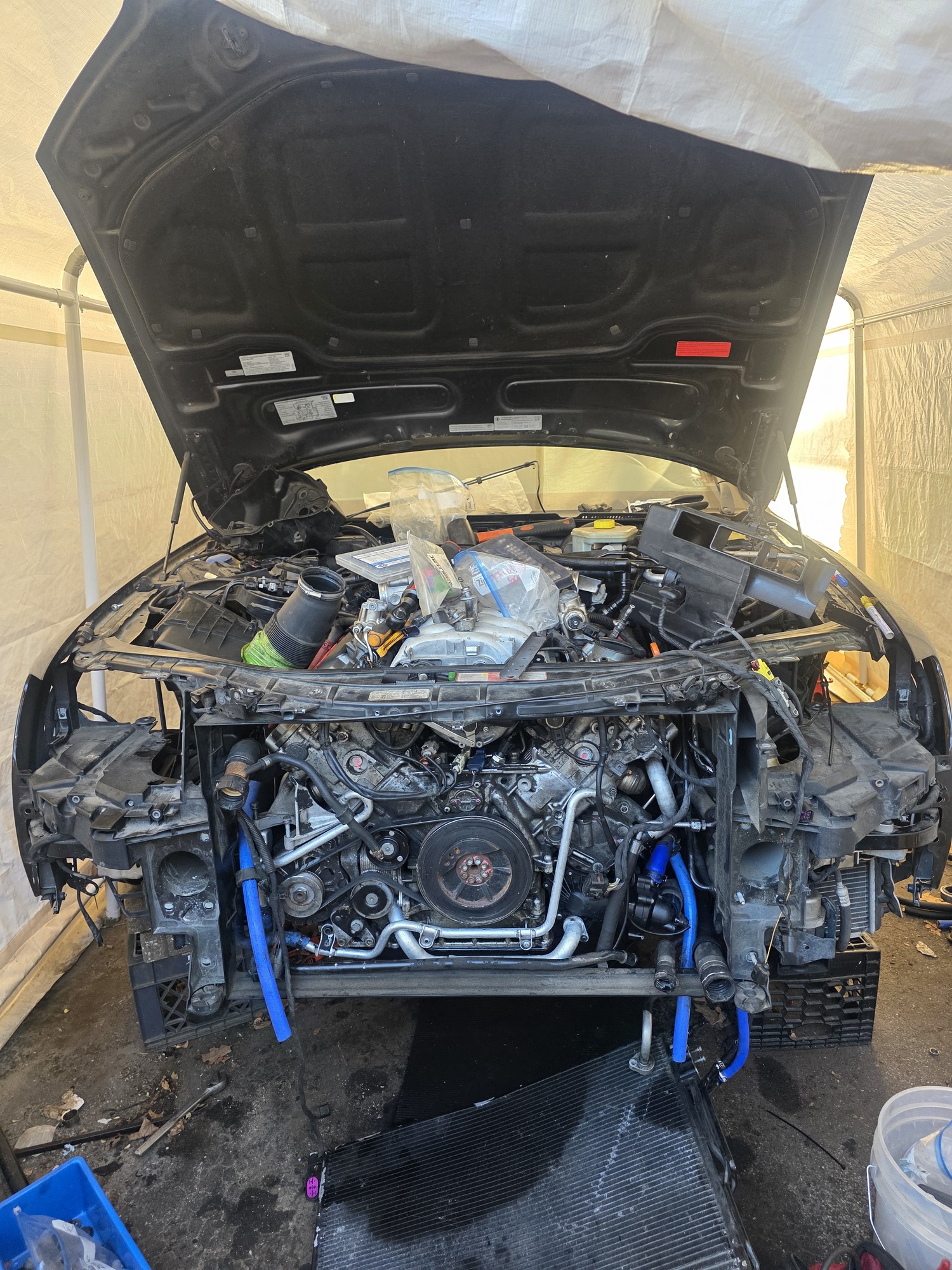

Forgot about this haha. I ended up changing the engine
My current progress in my lovely harbor freight canopy
I re did the entire timing since engine was out the car. Good thing I did since the timing guides were worn a bit. I also changed that inner spark plug gasket the one where you have to remove the cams. Engine definitely runs I just need to figure out where all these air hoses go. I did reseal the injectors and used a ultrasonic to clean them as well as a carbon cleaning. I am going to change the condenser so dont mind it lol. I just hooked up the power steering hoses to have it starting
Great work. Love the hobo freight for the temp tools stuff. Might not be the best for ever but it’s the right choice for right now LOL
