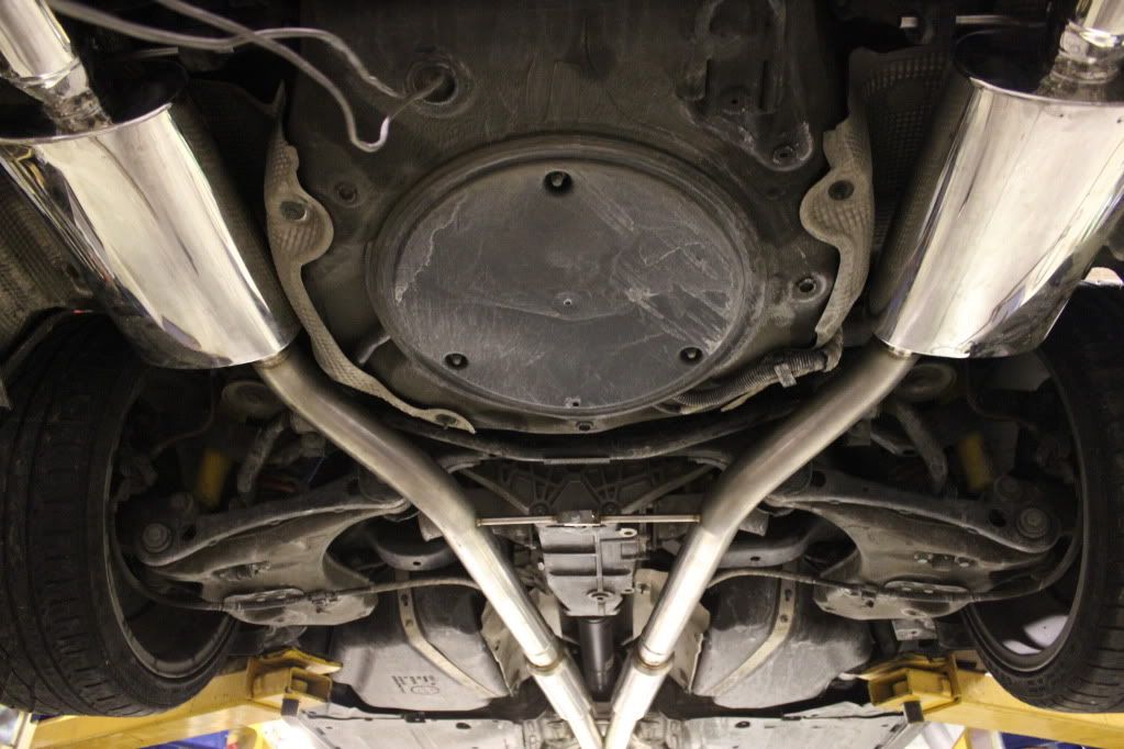

So the simple question, will it fit? Yes.
Does it fit perfectly? No

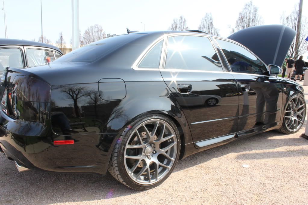

This is because the B7 obviously comes with dual exhaust where as the B6 is single tips. However, it really doesn’t look that bad and it really grows on you. The biggest issue to me was that the B6 tips do not sit perfectly centered in the opening of the B7 valence. The tips tend to sit slightly off-center towards the outside of the openings (i.e. towards outside of car).
However, with the bigger opening in the valence, it really shows off the polished mufflers and gives a great rear profile aggressive look because of this. This is why it grew on me so much. The look of the big B6 tips, and the polished mufflers just looks stunning. The problem was that the back of the mufflers hit the spare wheel well when you tried to push them in any farther to center them, so there was no way to fix this issue.
Well, after I decided to run over a 18-wheeler tire and have it screw up my front & rear bumpers, it was time for new toys and complete the look. Yes that’s right, DTM bumpers with dual openings for the rear valence to fit the B6 catback perfectly!
