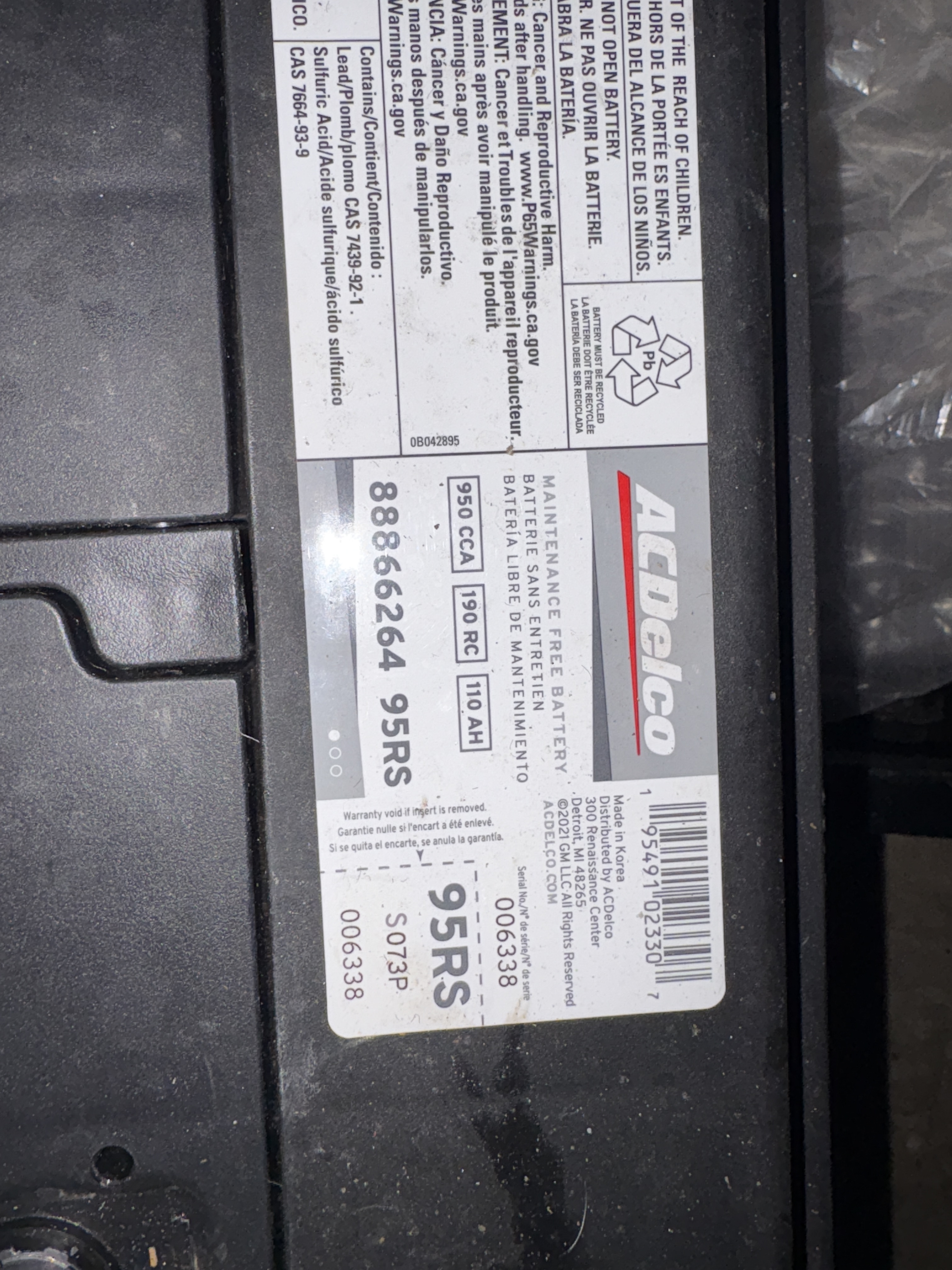

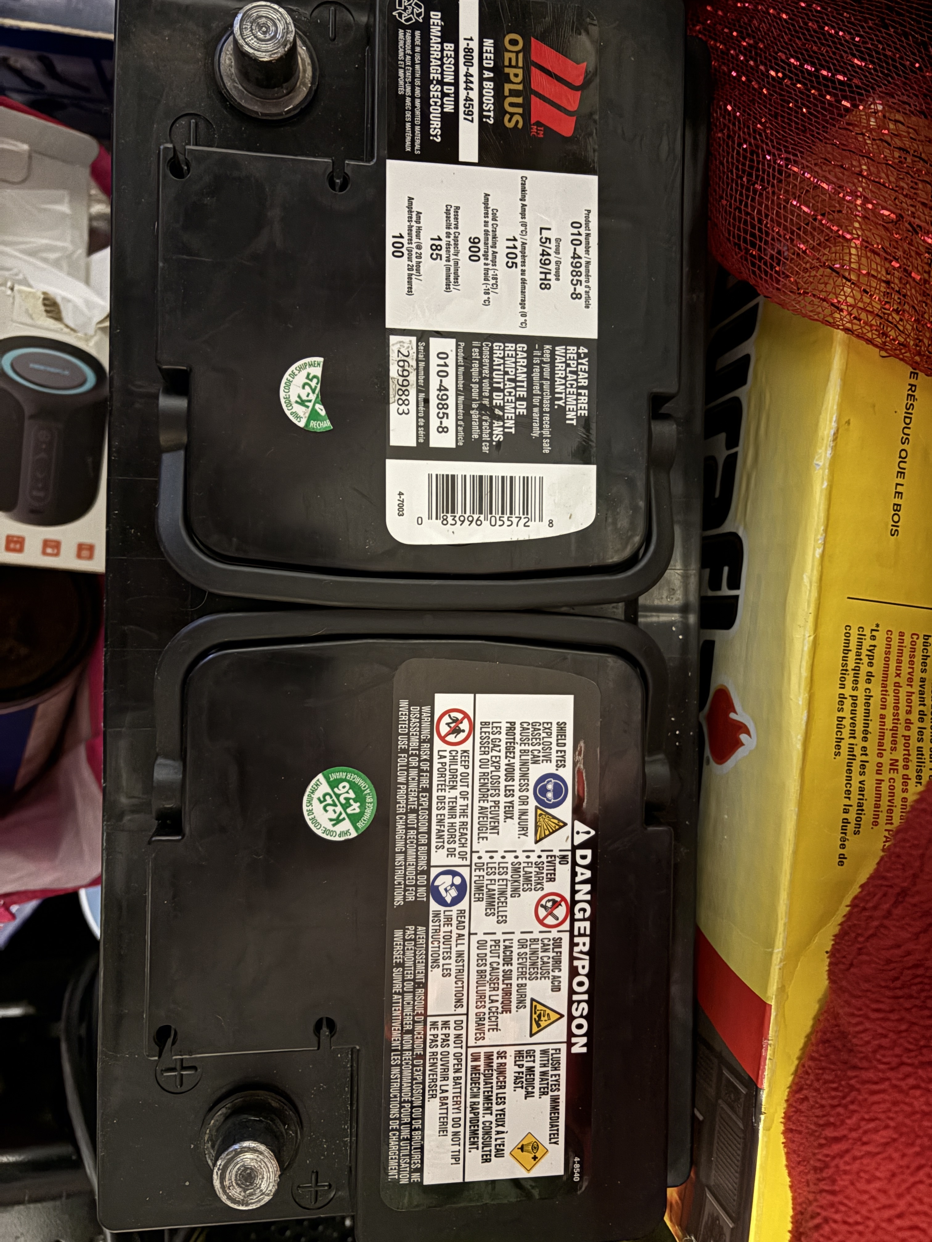

Old battery is flooded lead acid and new one is AGM, so theres indeed a difference…
Old battery is group 95RS and new is group 49, but the physically appear the exact same size.

And battery Ah goes from 110 (old) to 100

Now, there isn’t a code made for a 100Ah AGM battery, the closest one would be the ones for a 105Ah batteries, and these are: 4L0915105 / 000915105CF
Either of them should work.
As for the serial number, and vendor code, they don’t really matter. You can set any vendor.
For serial number, I personally use xxDxxMxxxxY - the date I install a new battery, replacing “x” with day, month, year etc. It coincidentally is an ideal lenght (serial number has to be 11 digits/letters)
