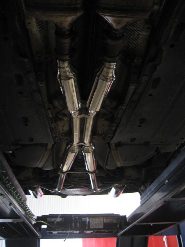

Heres a pic i found of it underneath that you could actually tell.
http://i39.photobucket.com/albums/e157/DanB412/IMG_2931.jpg
I’ll get a pic of mine today after class
Definitely not a crossover in that pic, lqmeh. That’s actually SoCalNoS4Avant’s car.
Here is a pic of the B7 system. Not sure what to call that?
http://www.kmdtuning.com/images/uploads/STaSIS%20Motorsports/B7%20S4/stasis_SE121-E10-01-00.JPG

It’s pretty interesting their design, slip fit to DP’s (guessing maybe that portion is supposed to be welded), then V bands (which is a very nice design feature), then slip fit at the rear axle (you’d think they’d charge a bit more and go with VBand again, no?). And after using good stainless and 2.5" piping, you’d think they’d have a crossover in there, but they clearly don’t.
OP your definitely on the right track with your mods. In the last six months I have done all those and what a difference they make. I went with trexturk dp’s and also have a Stasis exhaust. With the stasis exhaust, the “resonance chamber crossover” IMO helps but its not a true X. If you look closely at the welds the “crossover” section is probably 4 inches long but only an inch or so wide where the pipes meet. Here’s a couple vids of the catless pipes with the stasis.
