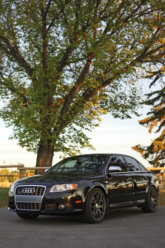

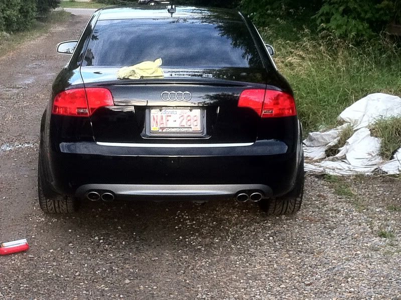

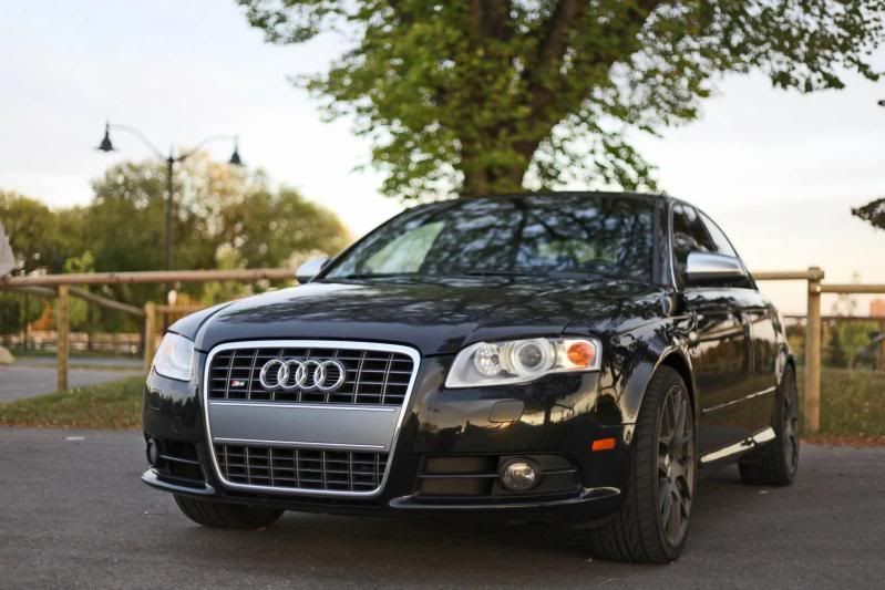

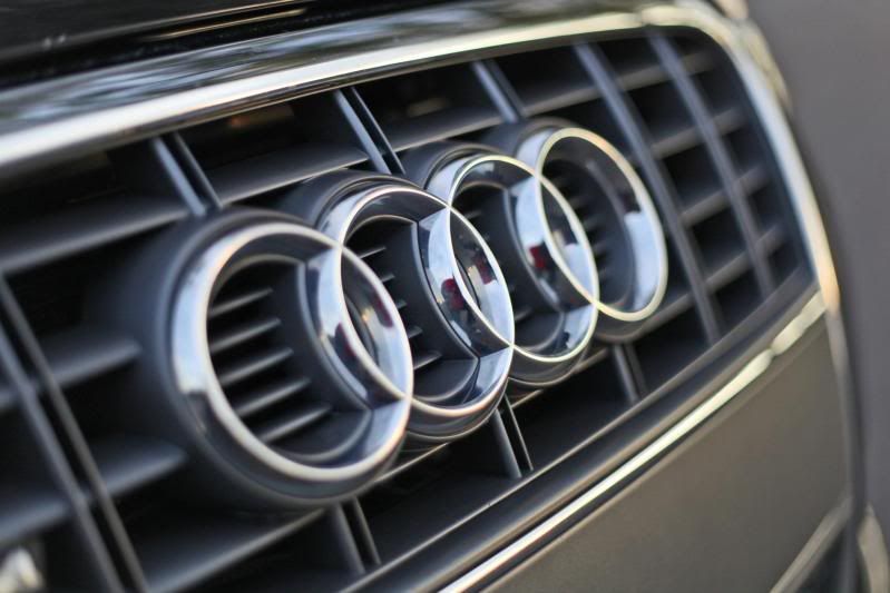

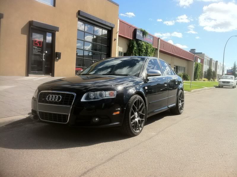

Now seeing as how pics are being demanded, I will oblige…
On to the pics!
This is the day I got her, straight to tunerworks to order exhaust!
http://i32.photobucket.com/albums/d35/Trebz14/Day1.jpg
After Tunerworks it was straight home to de badge and clean up that assay :wink:
http://i32.photobucket.com/albums/d35/Trebz14/Debadged.jpg
A week in and the tail lights get some loving (thanks to Shadow Tint)
http://i32.photobucket.com/albums/d35/Trebz14/Tinted.jpg

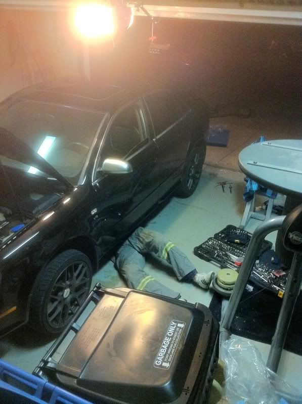

Finally I got a call from Tunerworks saying a fancy package had arrived for me. Exhaust install!
http://i32.photobucket.com/albums/d35/Trebz14/Install.jpg
And here is a few pics of the current state of the car!
http://i32.photobucket.com/albums/d35/Trebz14/S4.jpg
http://i32.photobucket.com/albums/d35/Trebz14/front2.jpg
http://i32.photobucket.com/albums/d35/Trebz14/Front.jpg
http://i32.photobucket.com/albums/d35/Trebz14/Panoramic.jpg
http://i32.photobucket.com/albums/d35/Trebz14/Tightass.jpg
http://i32.photobucket.com/albums/d35/Trebz14/Straighton.jpg
http://i32.photobucket.com/albums/d35/Trebz14/Badgeitup.jpg
