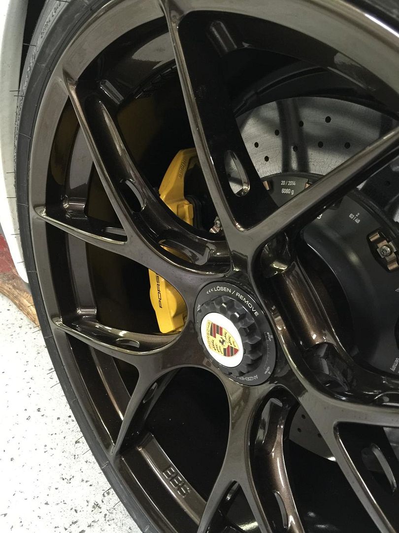

It’s a contingency plan in case I use ceramic brakes on track and they change my life. The unsprung weight diet package would also include BBS FI-R in 19x9 @ 17.2 pounds. That’d drop 54 pounds by my count. Probably not worth it for $25k. Just comforting to know it is possible.
http://i1204.photobucket.com/albums/bb419/MIALPERT/DBD16674-A57D-4D36-839A-CE7E457BF681_zpsushncvhj.jpg
Going from your heavy"ish" flow formed bbs wheels to a lightweight forged option would have tremendous benefits IMO Plus, saving weight on a wheel will be more beneficial than the rotors. Hell, if you are really gonna dump money like that, might as well figure out how to pick up a set of CF wheels the GT350R is coming with from the factory. They are torture testing them in the conti challenge series, where I believe they won last weekend at mosport.
