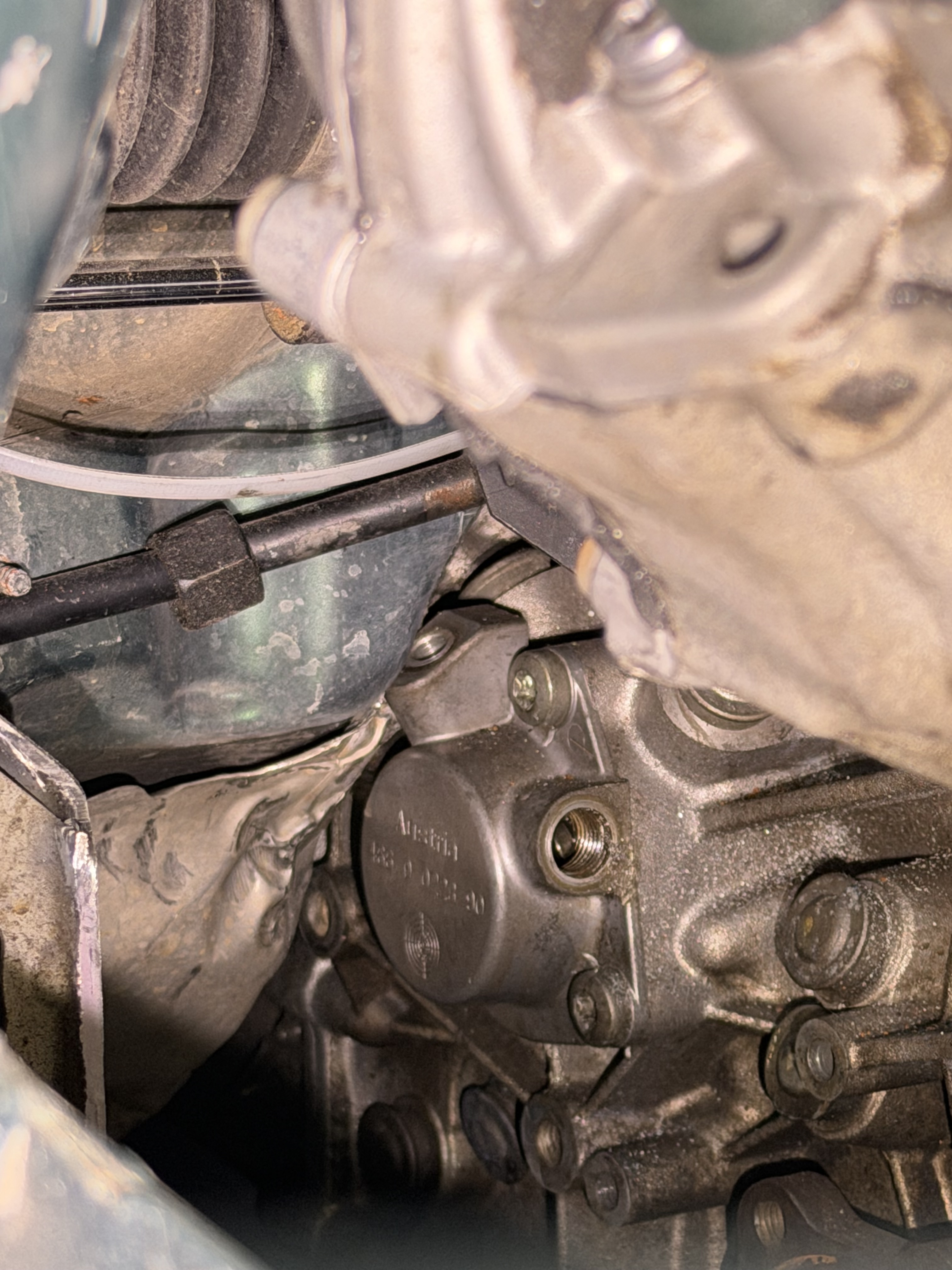

And last update for now is getting the crank position sensor hole and starter lined up. Had to grind down a little bit of the starter casting, but fits up well! Its part number 079911023D from a B6/7 S4.

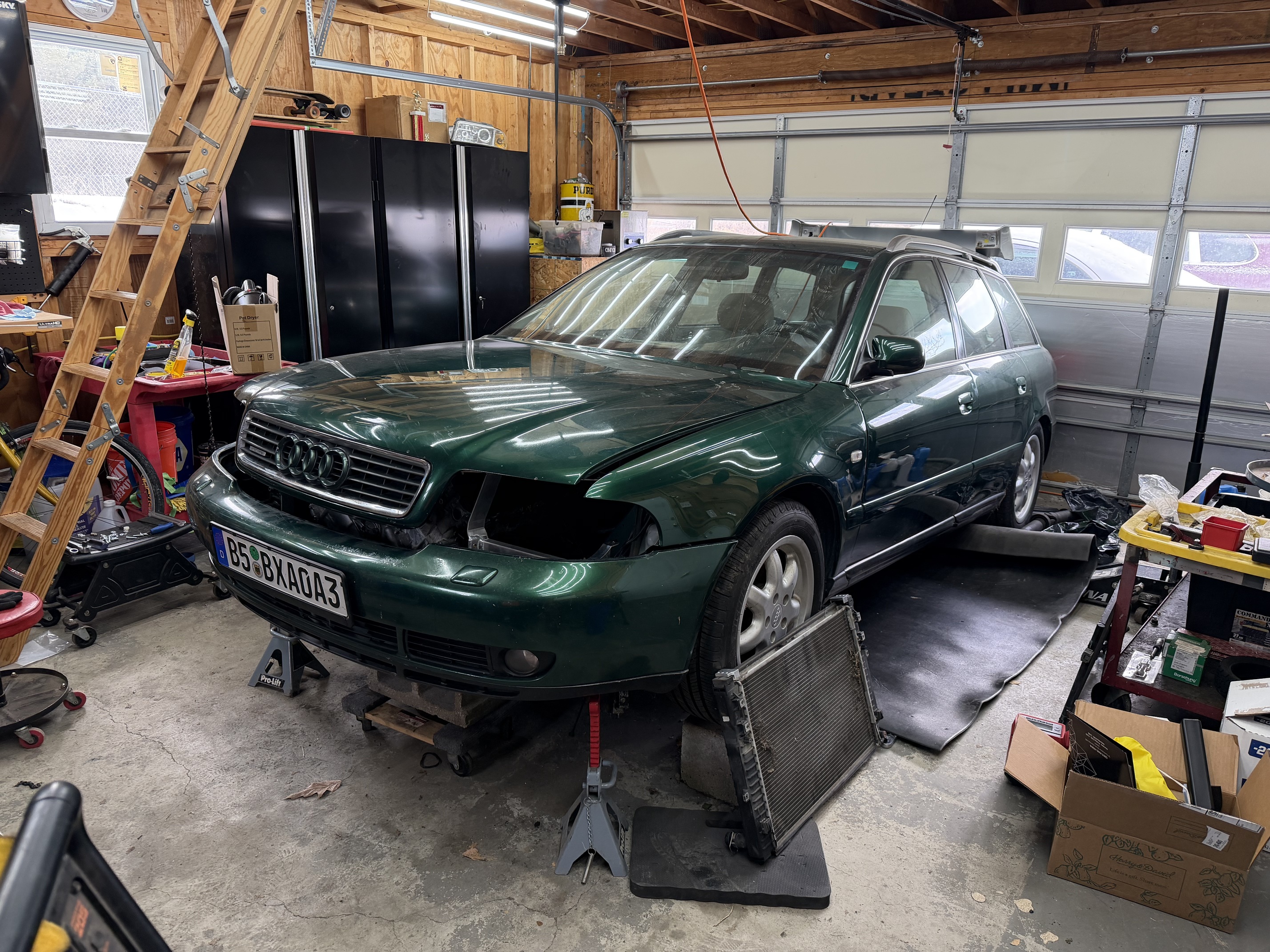

Drivetrain pulled, officially a roller now.
Next steps, clean out bay, pull ancillaries. Carbon clean the v10, then test fit!

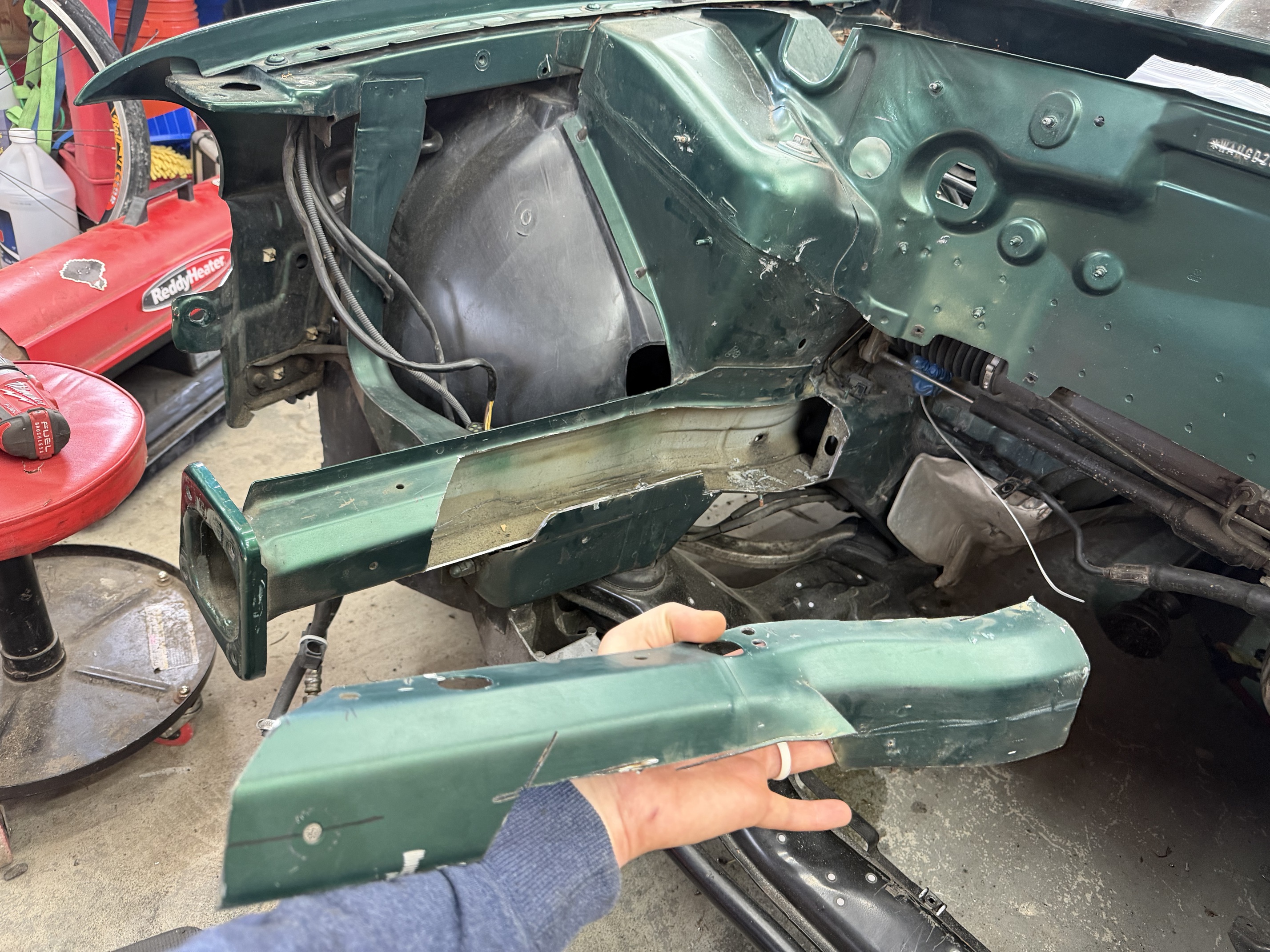

Framerails are less than 50% interference, cutting, boxing and adding some bracing would do the trick

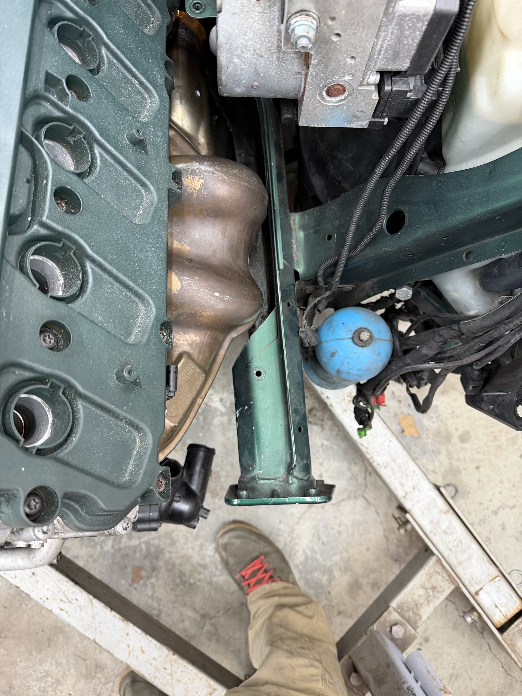

Obvious header modifying after the collector. Will be a squeeze around axles.
The framerail to trans tunnel area may require modification. It looks this way on both sides. Hmm

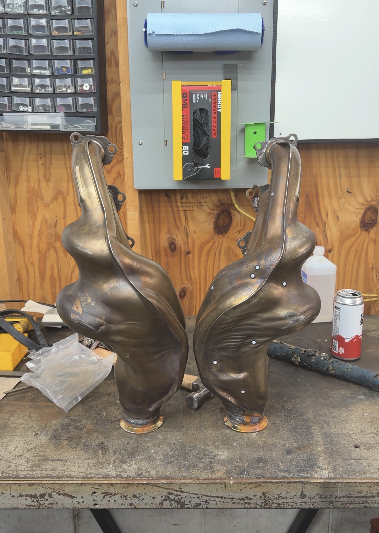

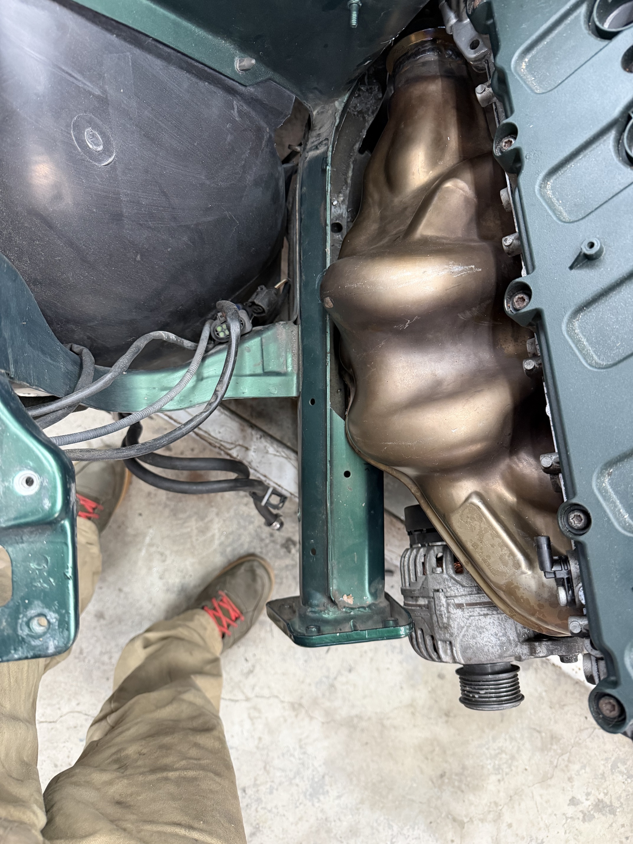

I called a few audibles on the headers. The r8/huracan ones are just too mugh to modify for fitment and theyre not a true 5-1 sollector. I was going to spend the time to CAD/mockup some 5-1s but a great deal fell in my lap for some 5-1 5.0 Gallardo headers. Some modifications required. I had to gap the exhaust flange about 2mm between each runner, mod a few flange bolt locations, and add a v band at the end all while not turning them into a piece of wavy bacon.
Then came the cutting. Fortubately I had the CAD models to get a great estimate of what needed cut. Once I have things where they will lend for good, it all comes back apart and boxed in with some 14 GA steel, plenty strong.

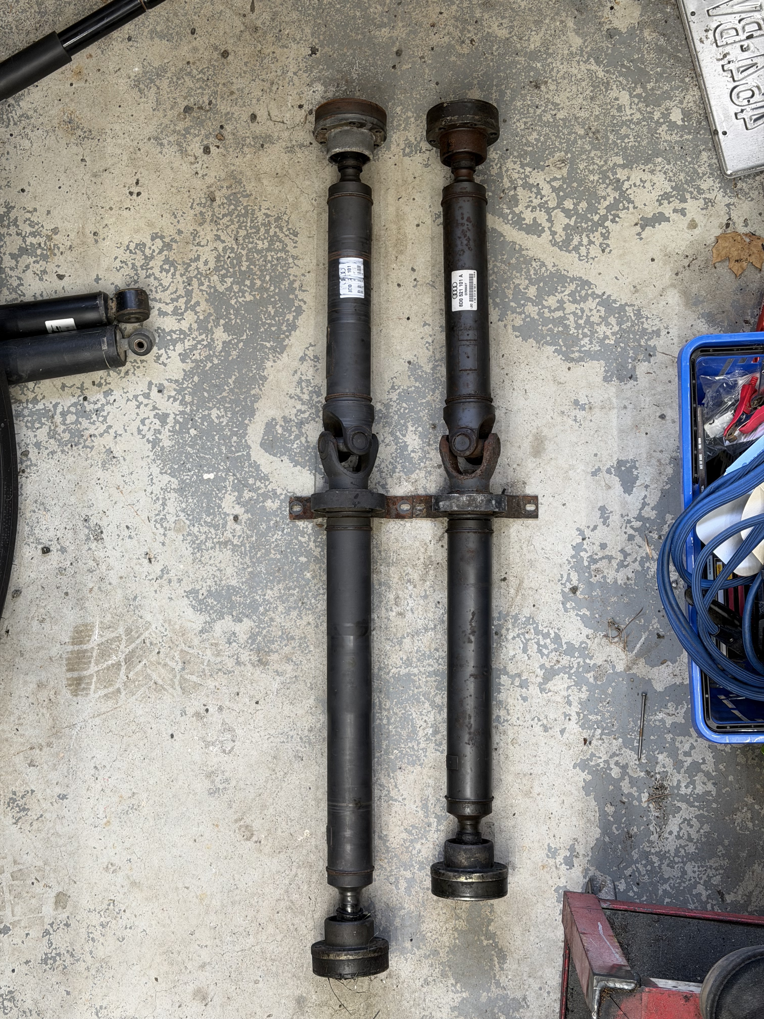

I was having a difficult time deciding where my main reference point to build off of would be. A B5 S4 auto driveshaft is 3" shorter than my 2.8 manual one. This is where I decided to start.

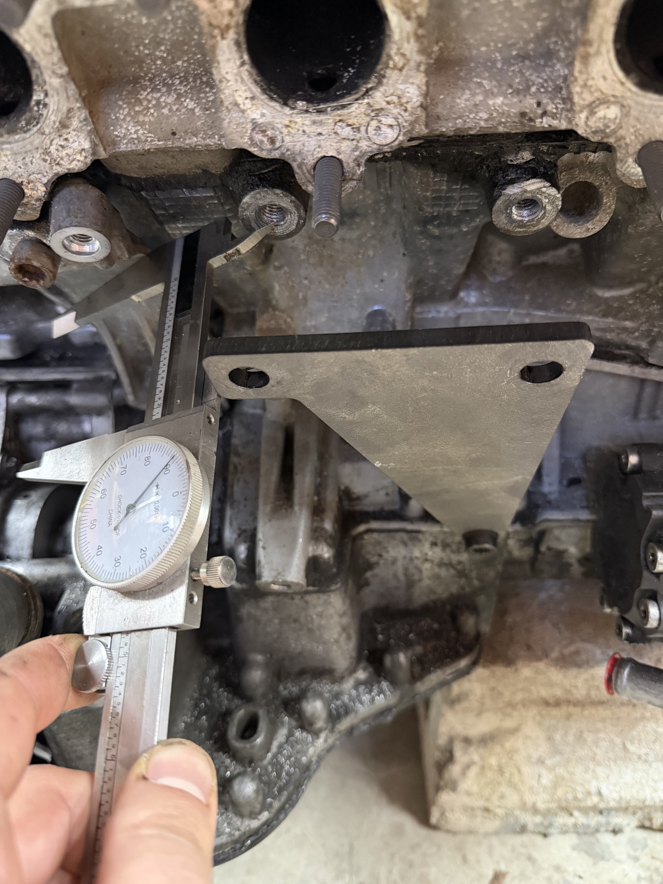

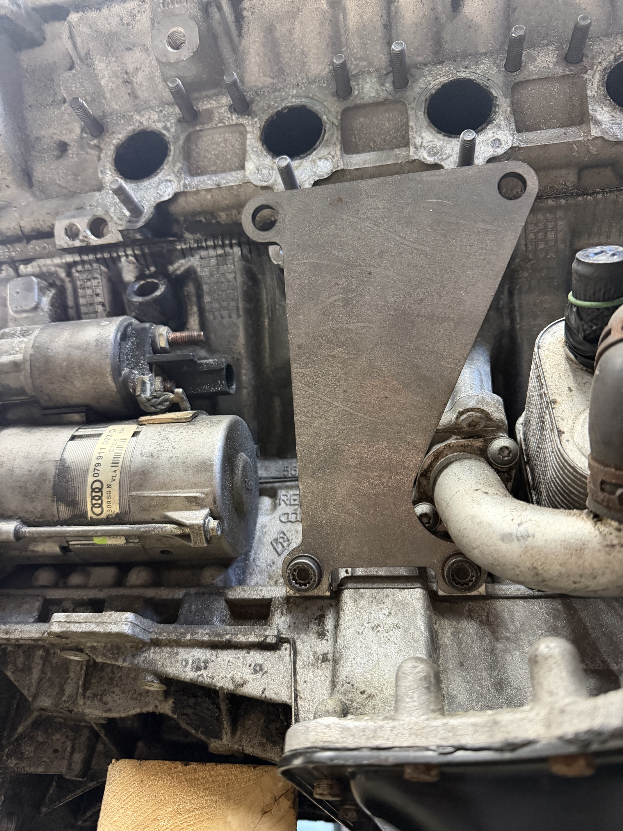

A few new engine mount plates compliments of Martin Harp.

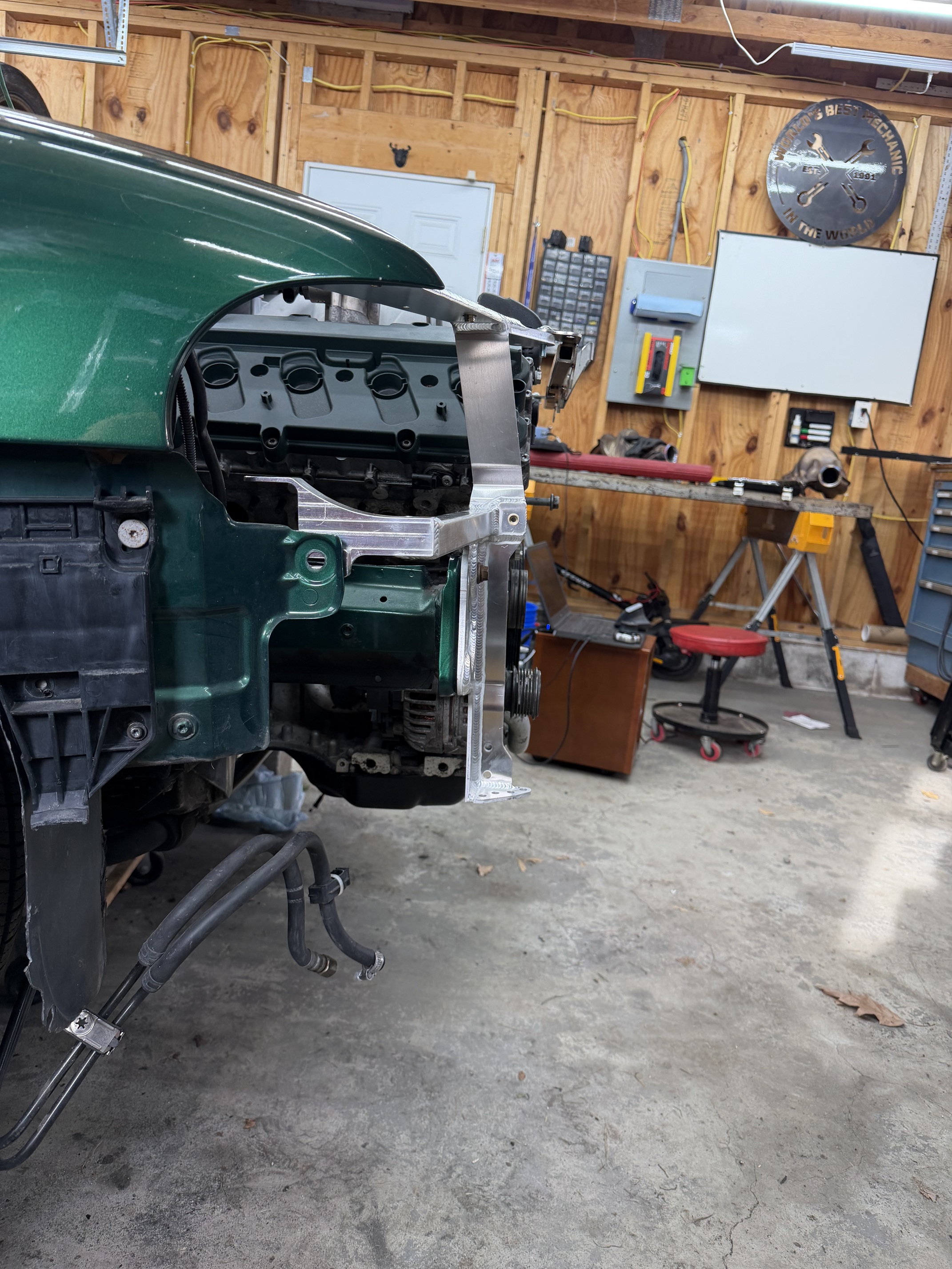

Here’s where were at for the year end mark. I am determined to drive this to shows and meetups this year. Using the B5 S4 auto driveshaft (3" shorter) I have a few contact points, some minor some not. all resolvable.

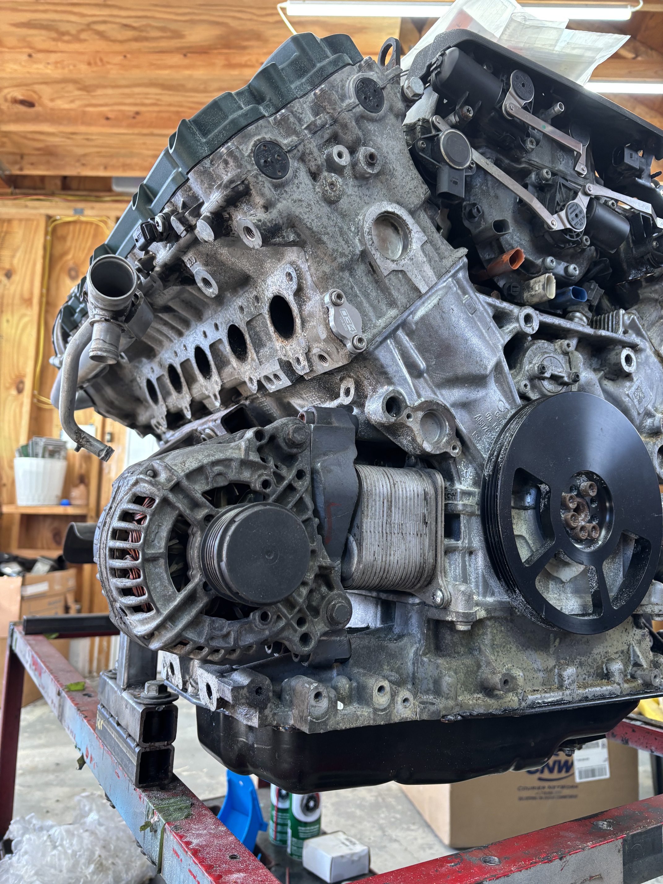

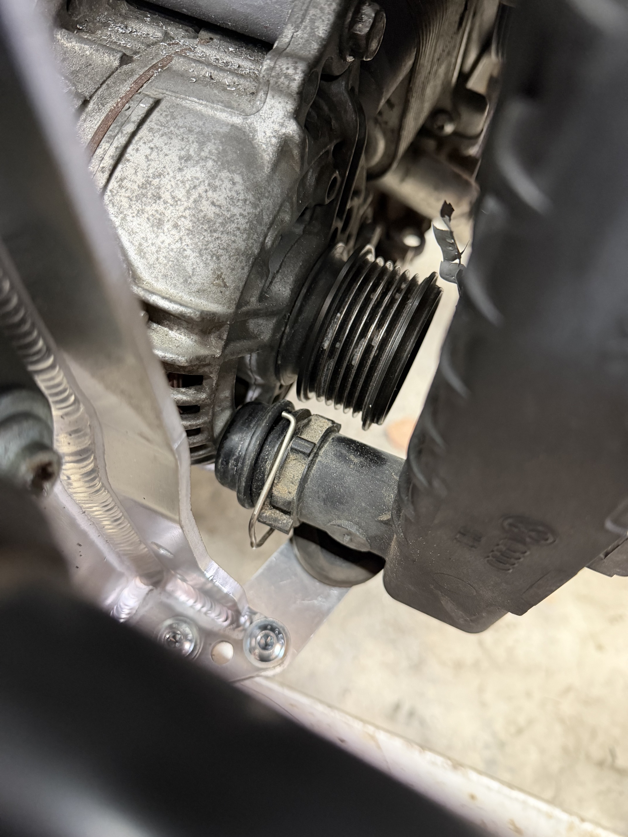

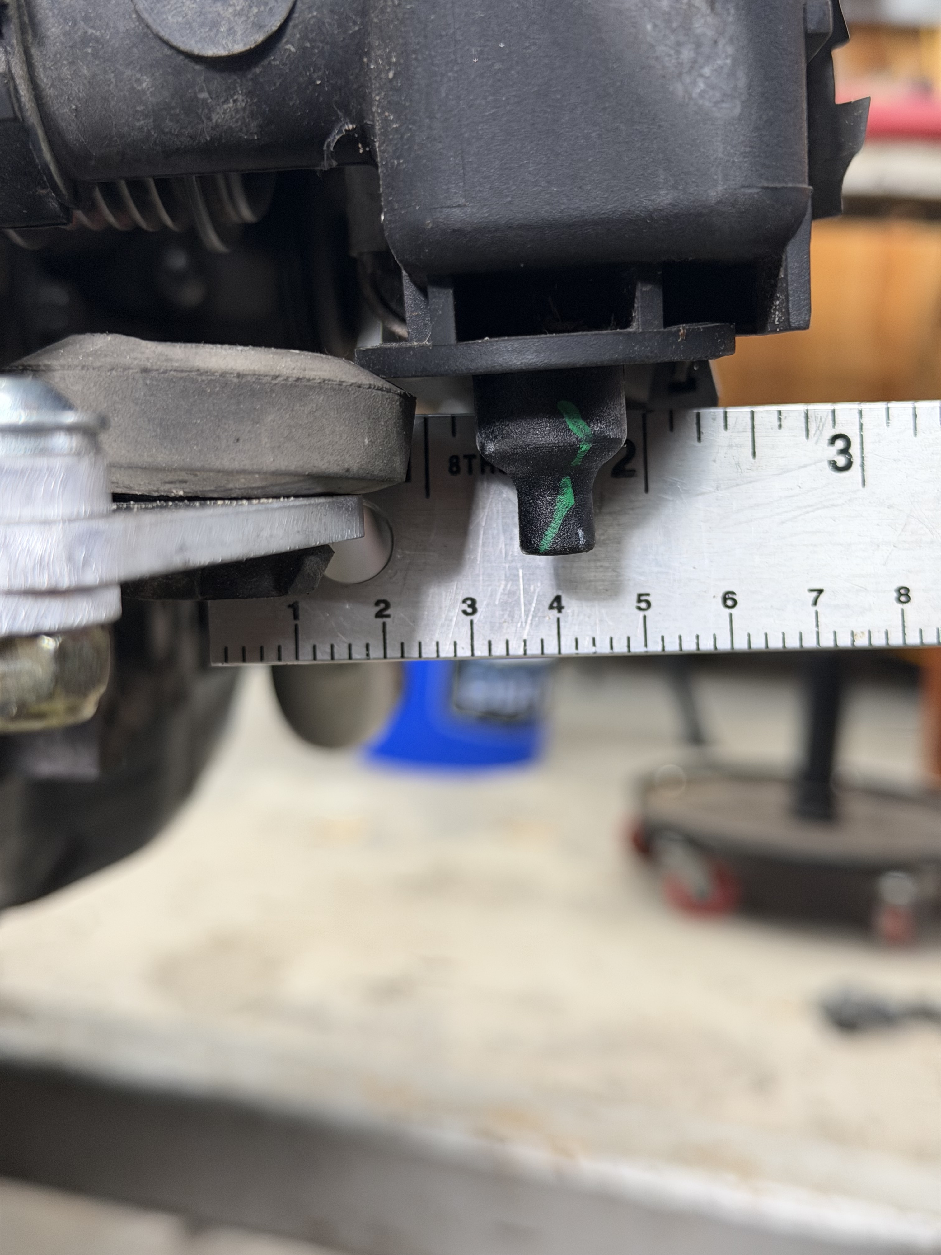

1st one is the big one. with GVB’s core support, this setup clashes right down by the rad support and alternator. The lower line hookup hits the face of the alternator. I measured 40mm gap with this contact, between the radiator support and where the radiator sits. Realistically this is about half before the pulley gets to become a concern. So a few options now:
  1. Shorten driveshaft 20-40mm, lose some valuable coolant plumbing area behind the heads but gain front clearance
  2. push the radiator out and fond an alternative hood latch.
  3. somewhere between…shorten driveshaft and get an aftermarket rad with a different outlet hose orientation.

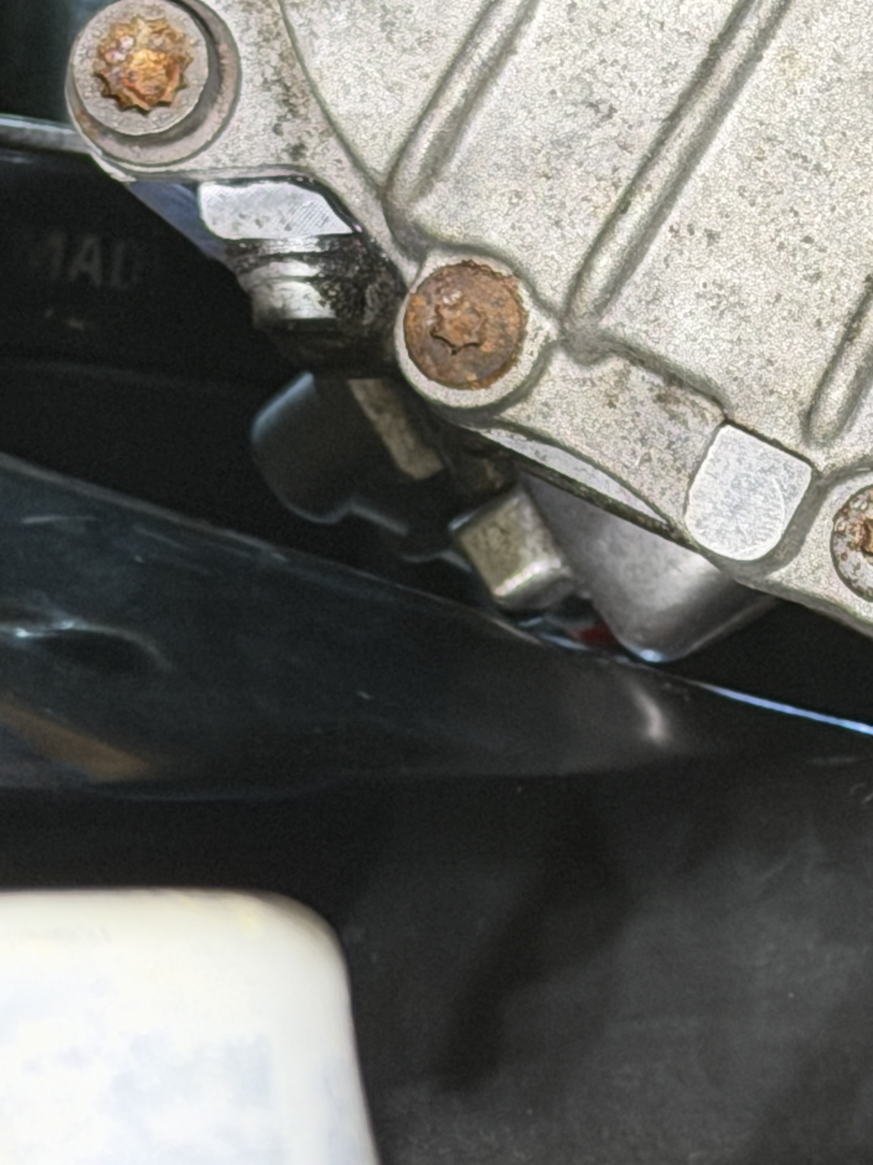

    Trans cooler in/out lines hitting tunnel. nothing a little hammering or notching wont fix.

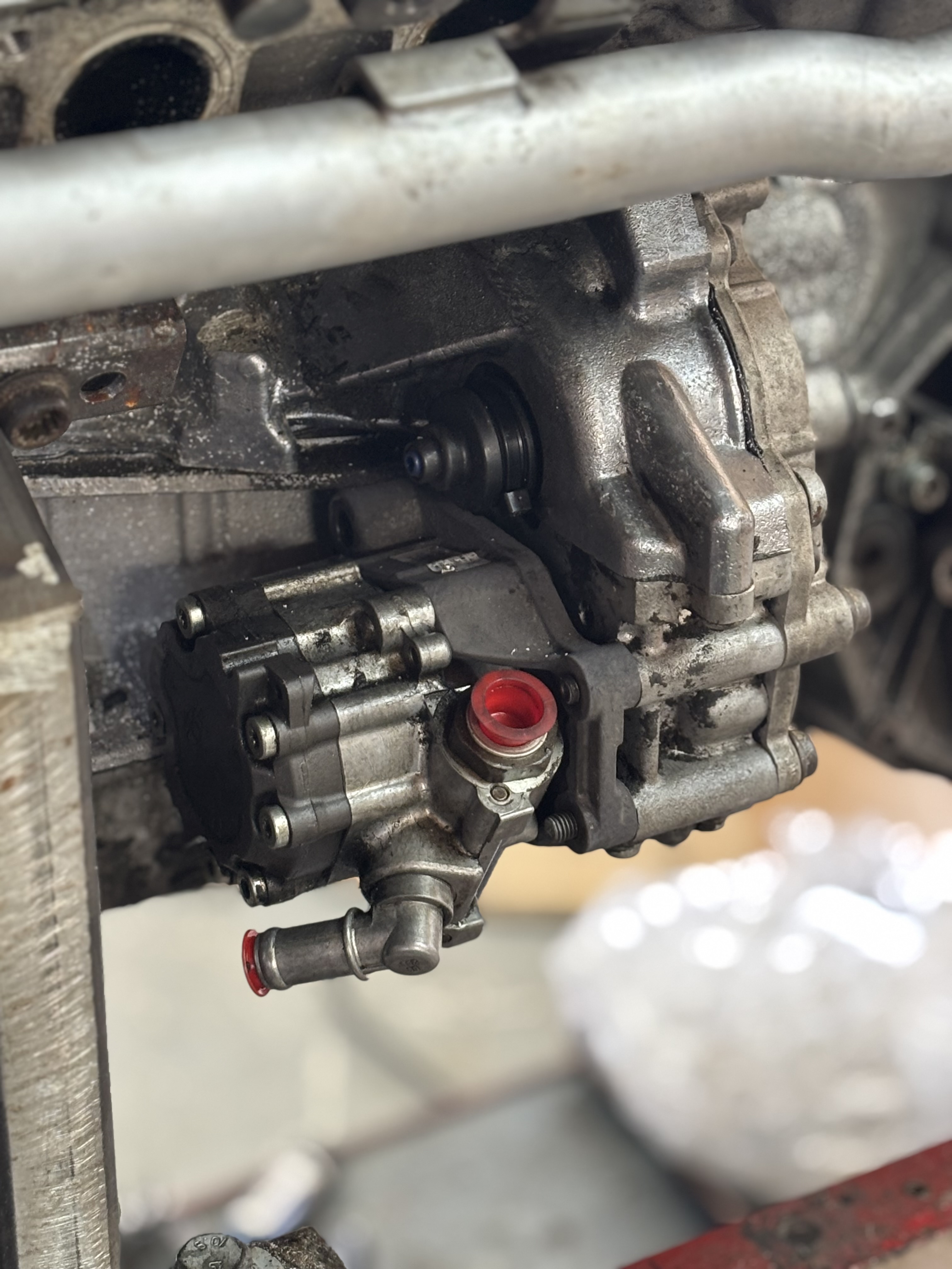

    The power steering pump has a much better orientation thank stock, but seems to be bottoming out on the subframe. Notchy notch and patchy patch will do.

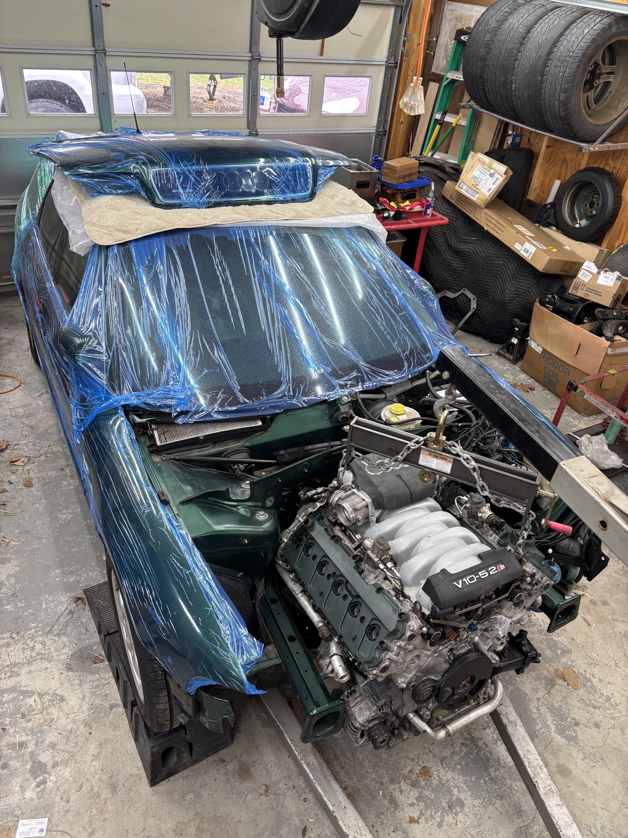

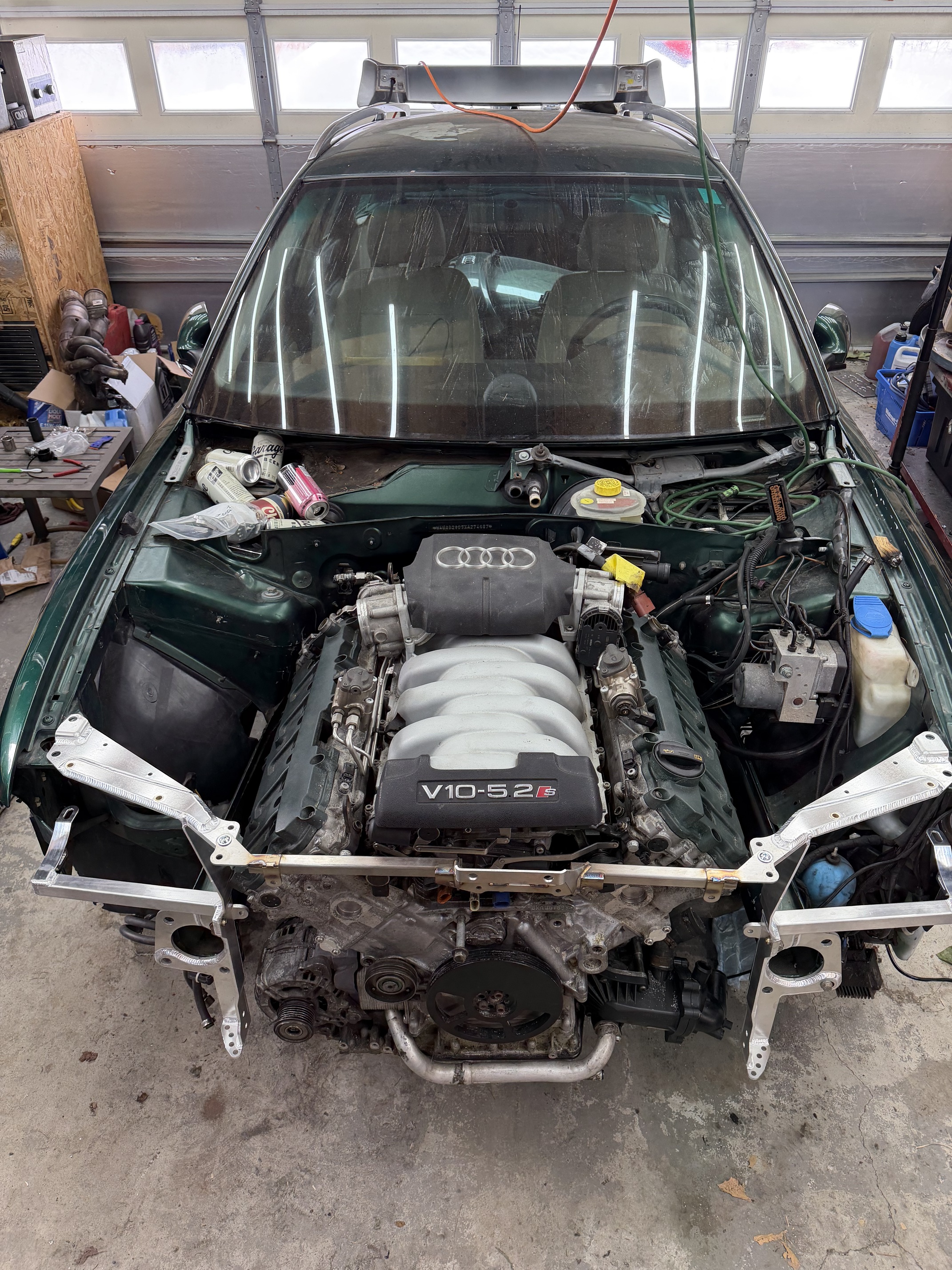

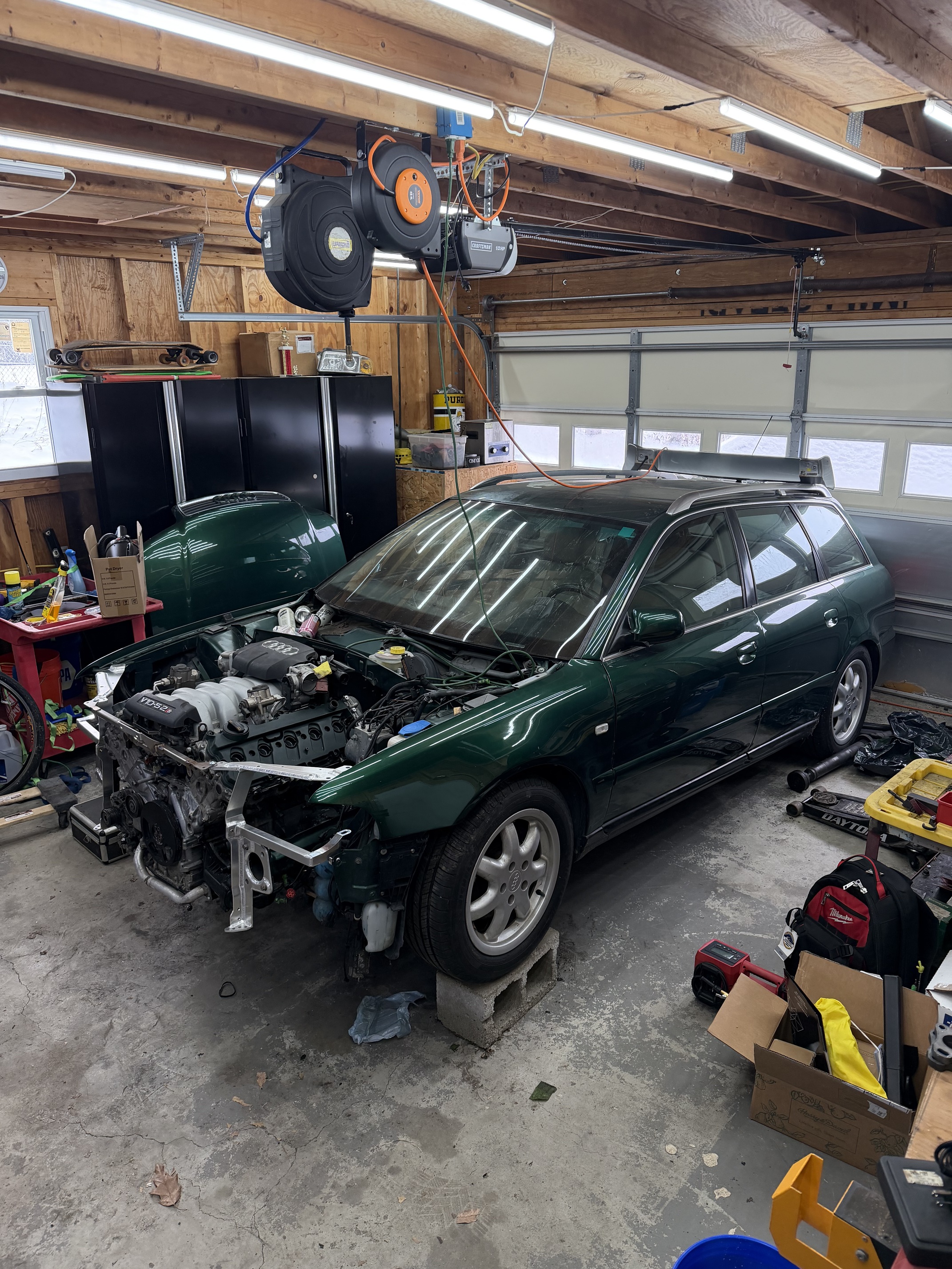

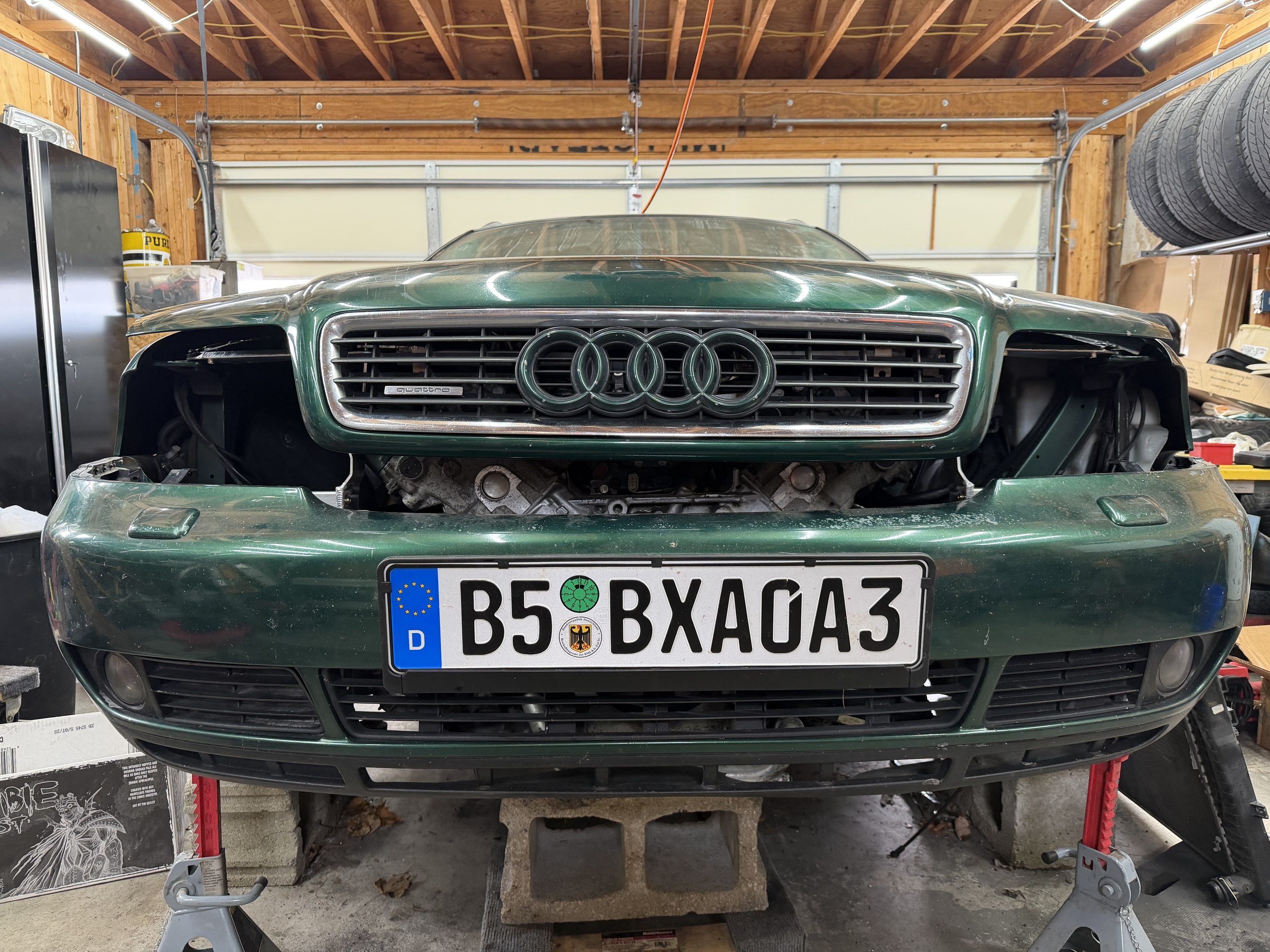

    So here’s where we are. The bumper and crash bar fit with everything behind it. the hood latch rests on the intake manifold. its tiiiight but thats the fun part of this build. Throwing this on a big cozy engine bay would’nt allow me to excersize my grinder and welder liberally. I noticed I’ve lost some clear on the roof and bumper. will have to address once its a roller. More to come!
