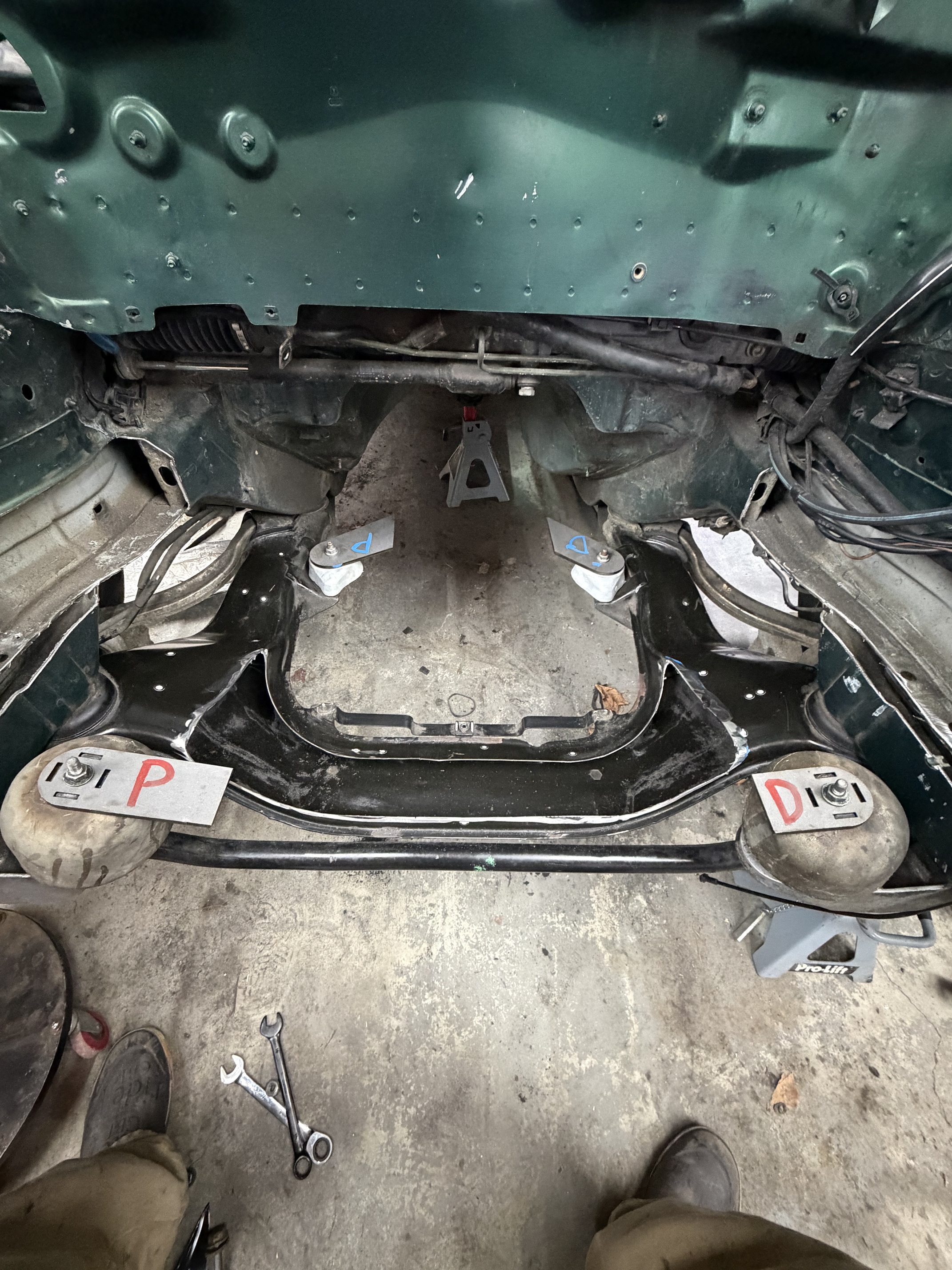

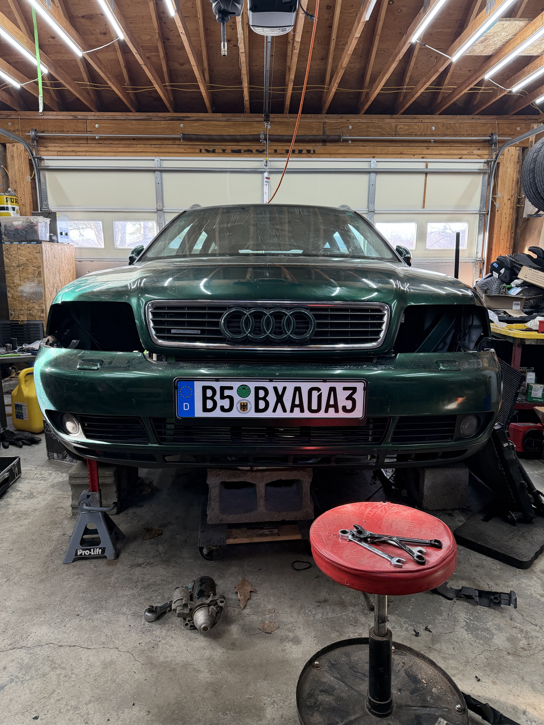

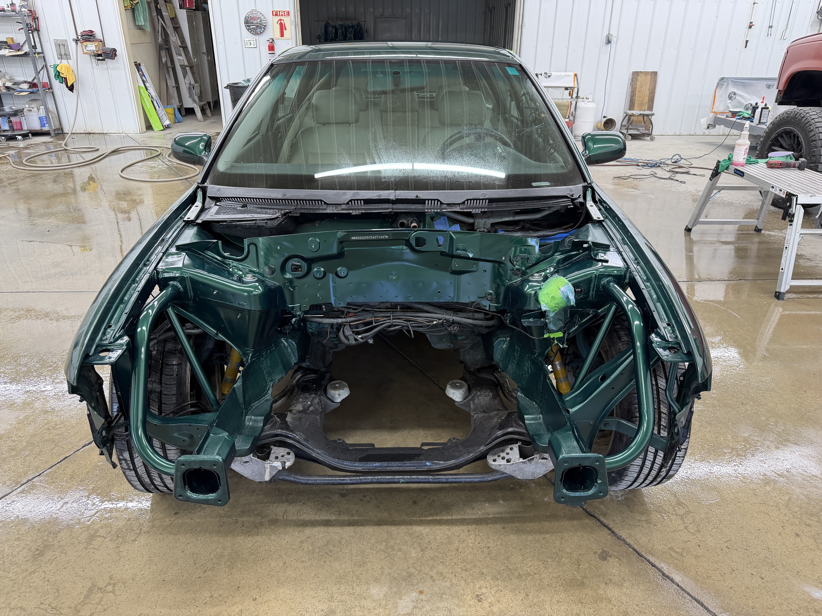

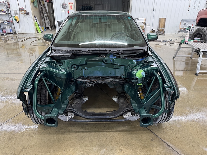

Thanks Dave! I made the hood shut by using a b6 s4 radiator where the inlet/outlets are swapped (high side on passenger side). This still leaves about 20mm of clearance from the radiator yo pulleys as well. Just need to fabricate mounts now, then it should be a rolling chassis.

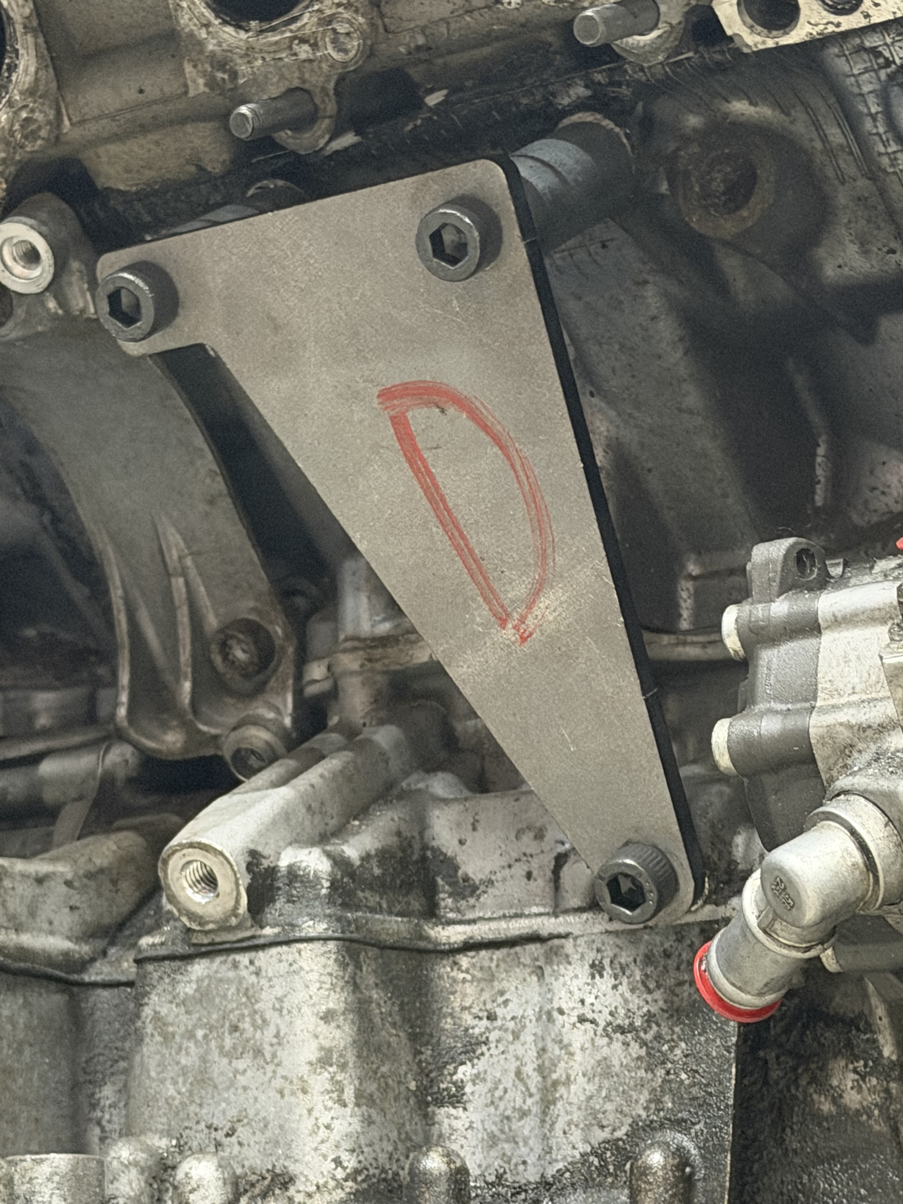

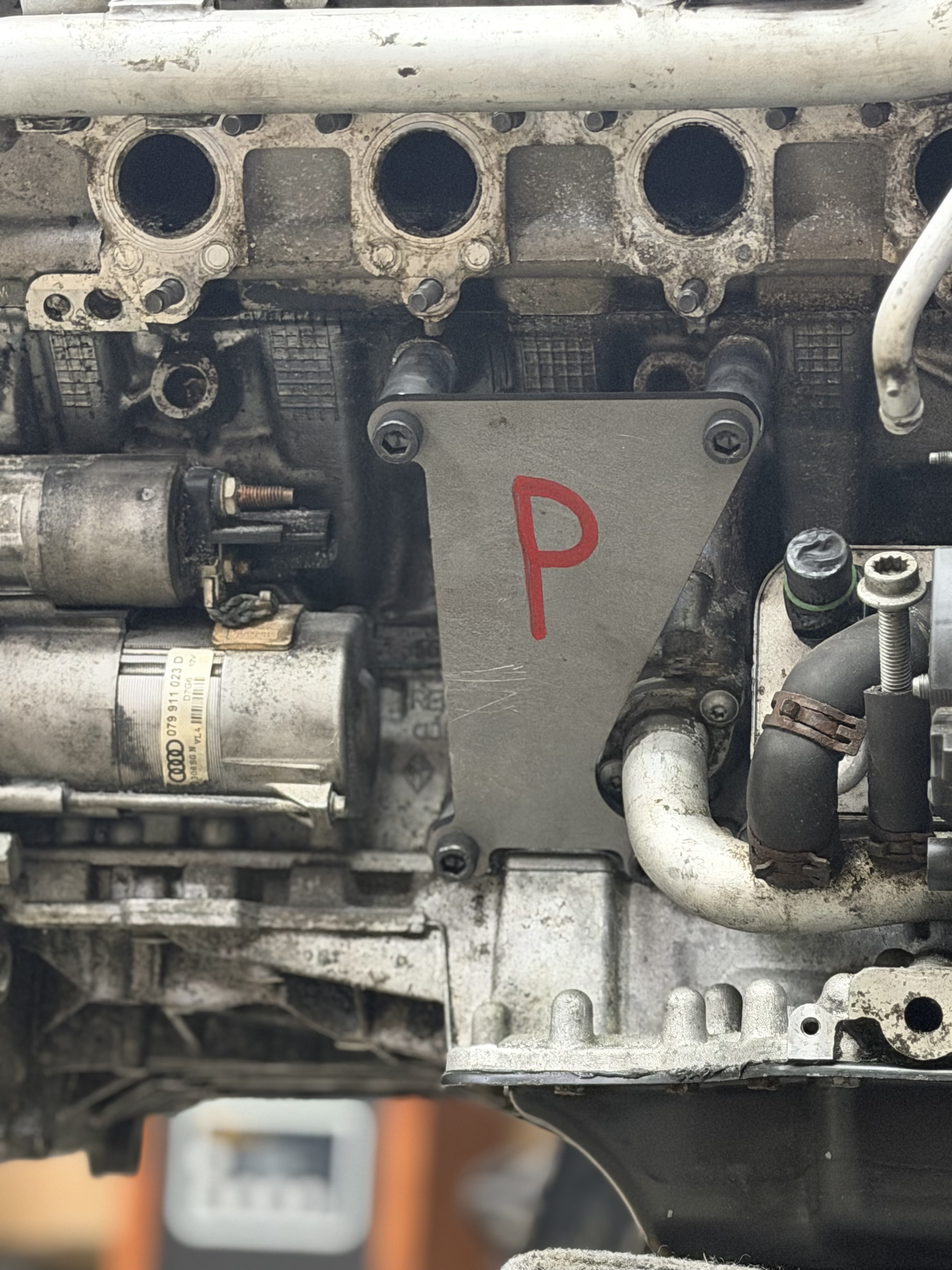

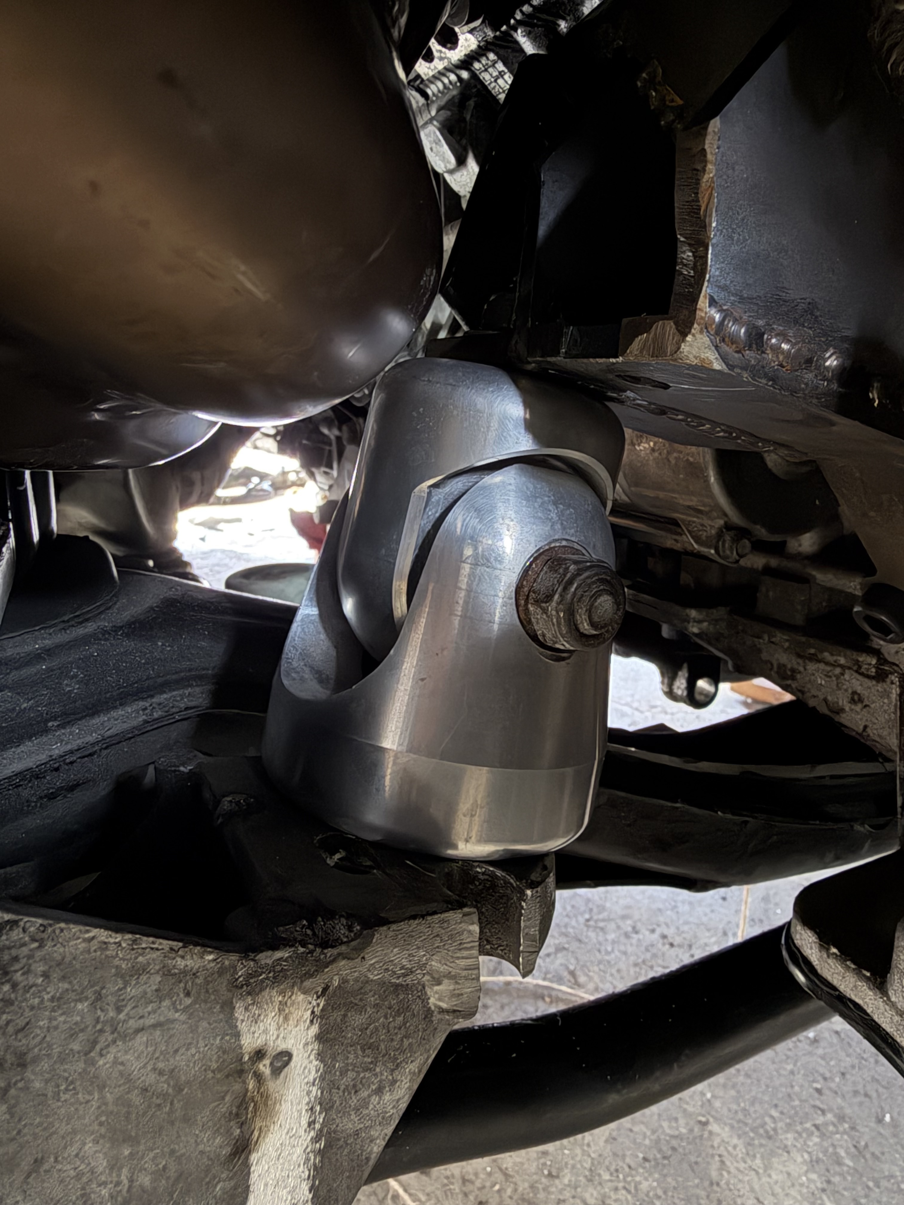

Eng and trans mount plates in place…another test fit with headers will secure the final resting place. Sendcutsend is an immense helper for stuff like this

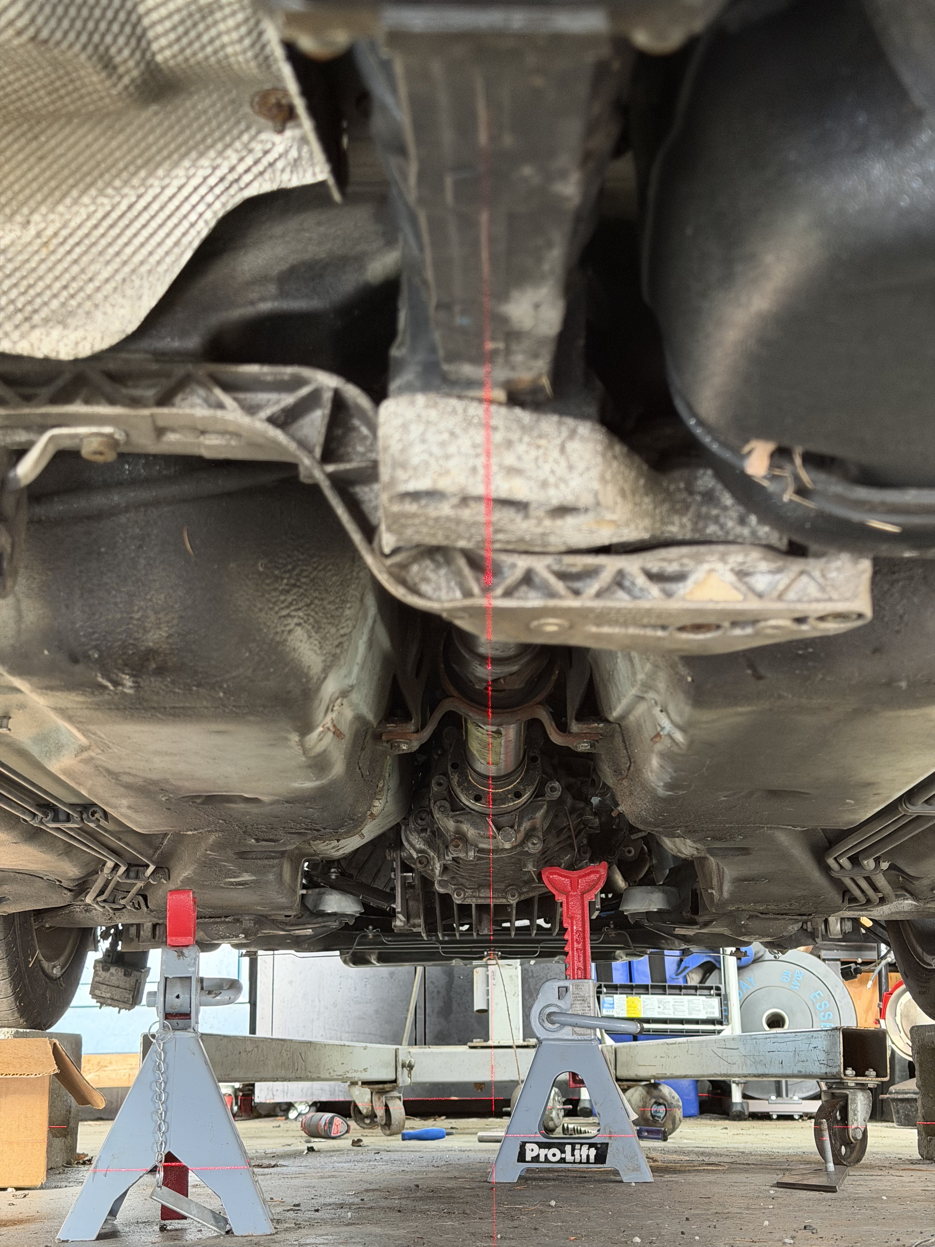

Interested to see the outcome of the driveline fitting

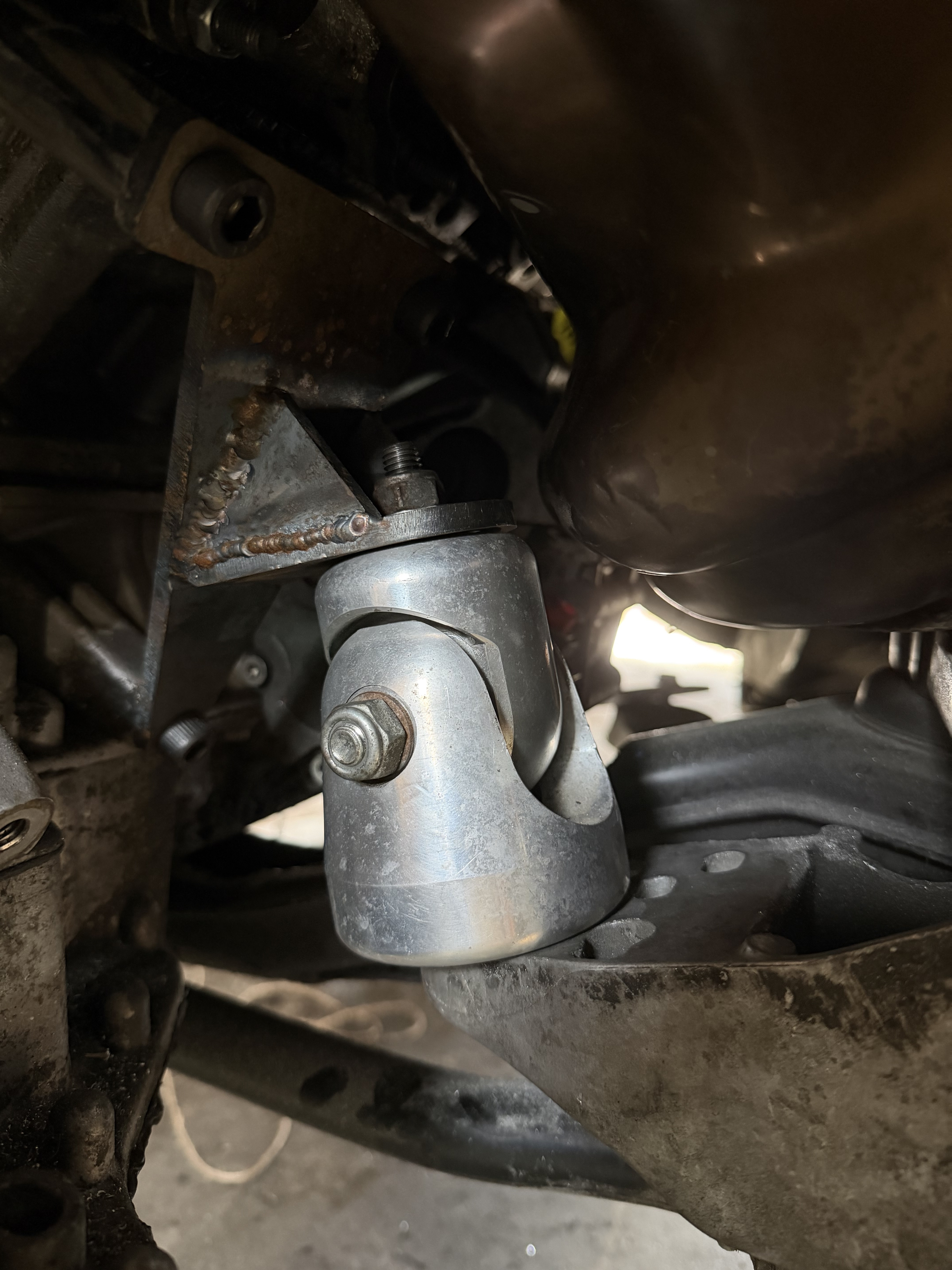

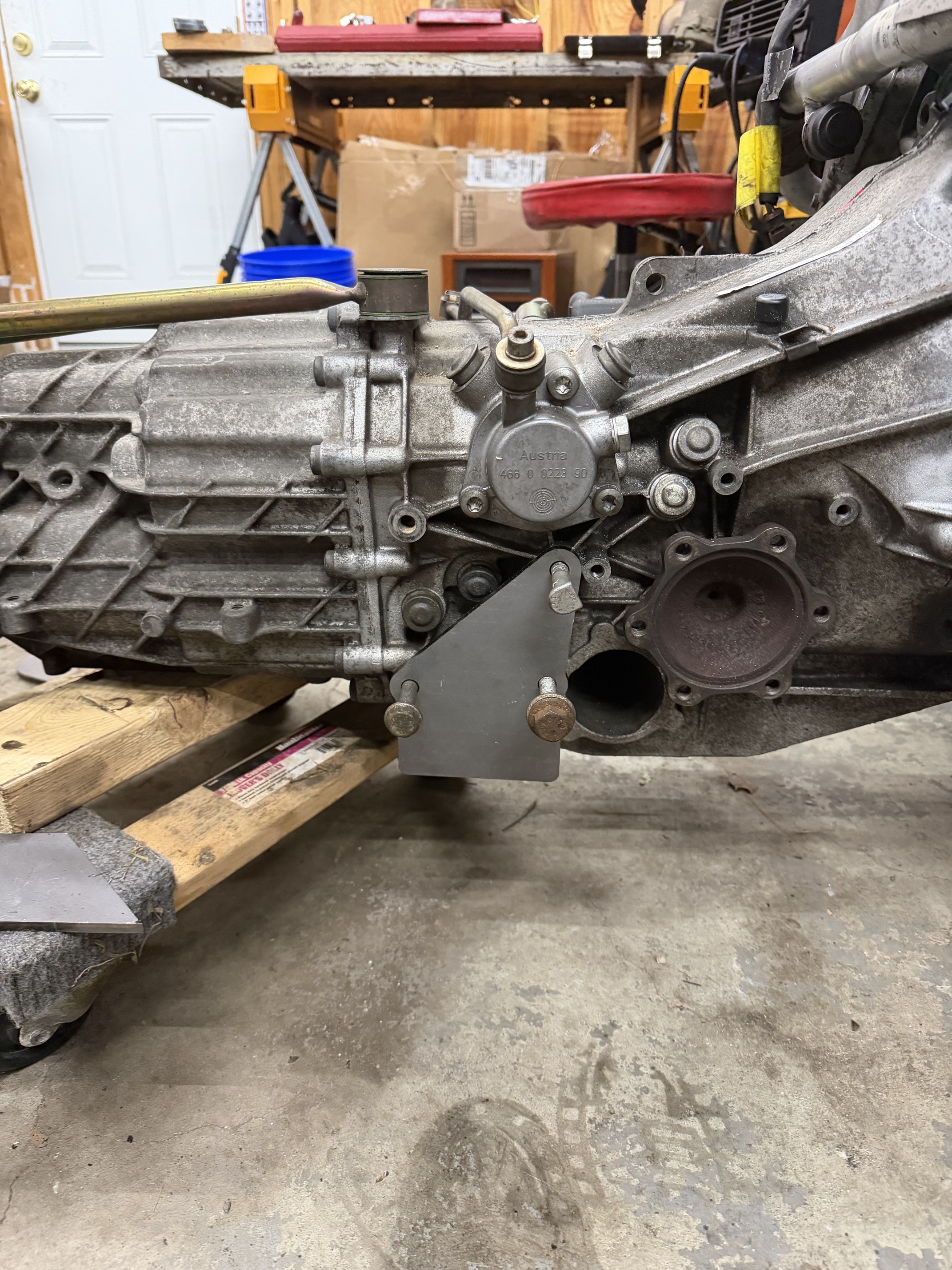

Engine and transmission are mounted up. Everything clears. Its a rolling chassis now. Next is reinforcing everything I cut to make it fit and shifter linkage as it will need to be shortened a few inches. Happy with the progress

Love the mount design too

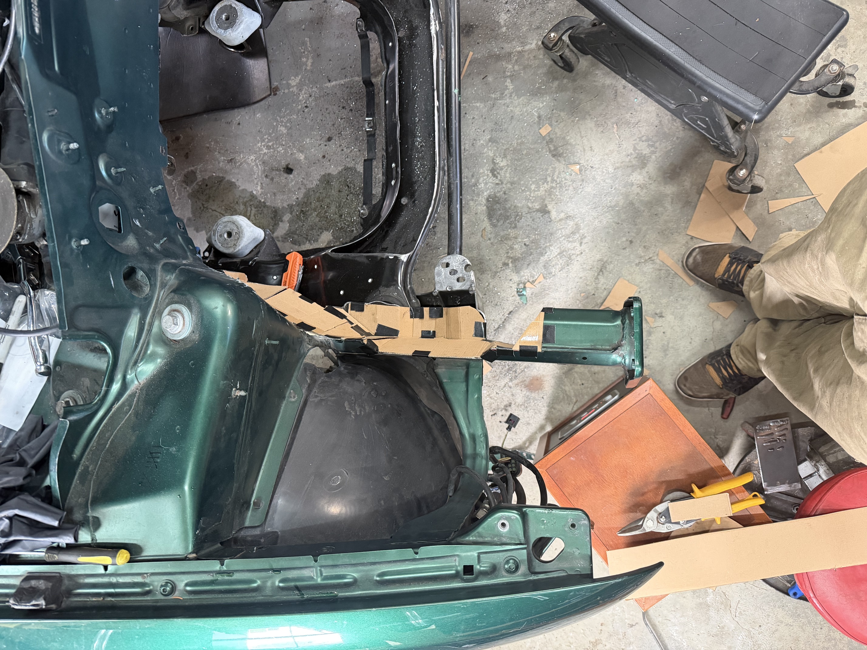

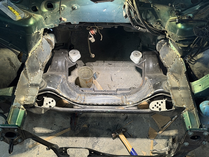

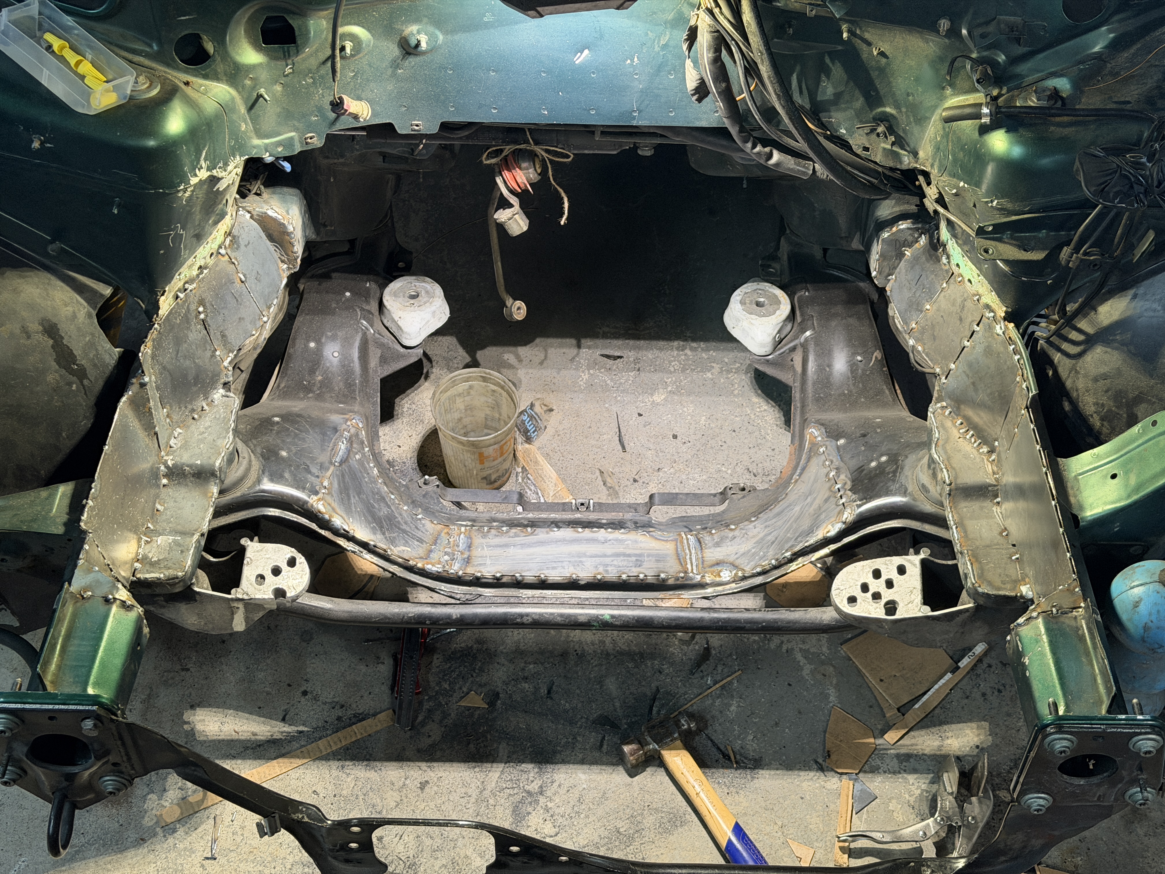

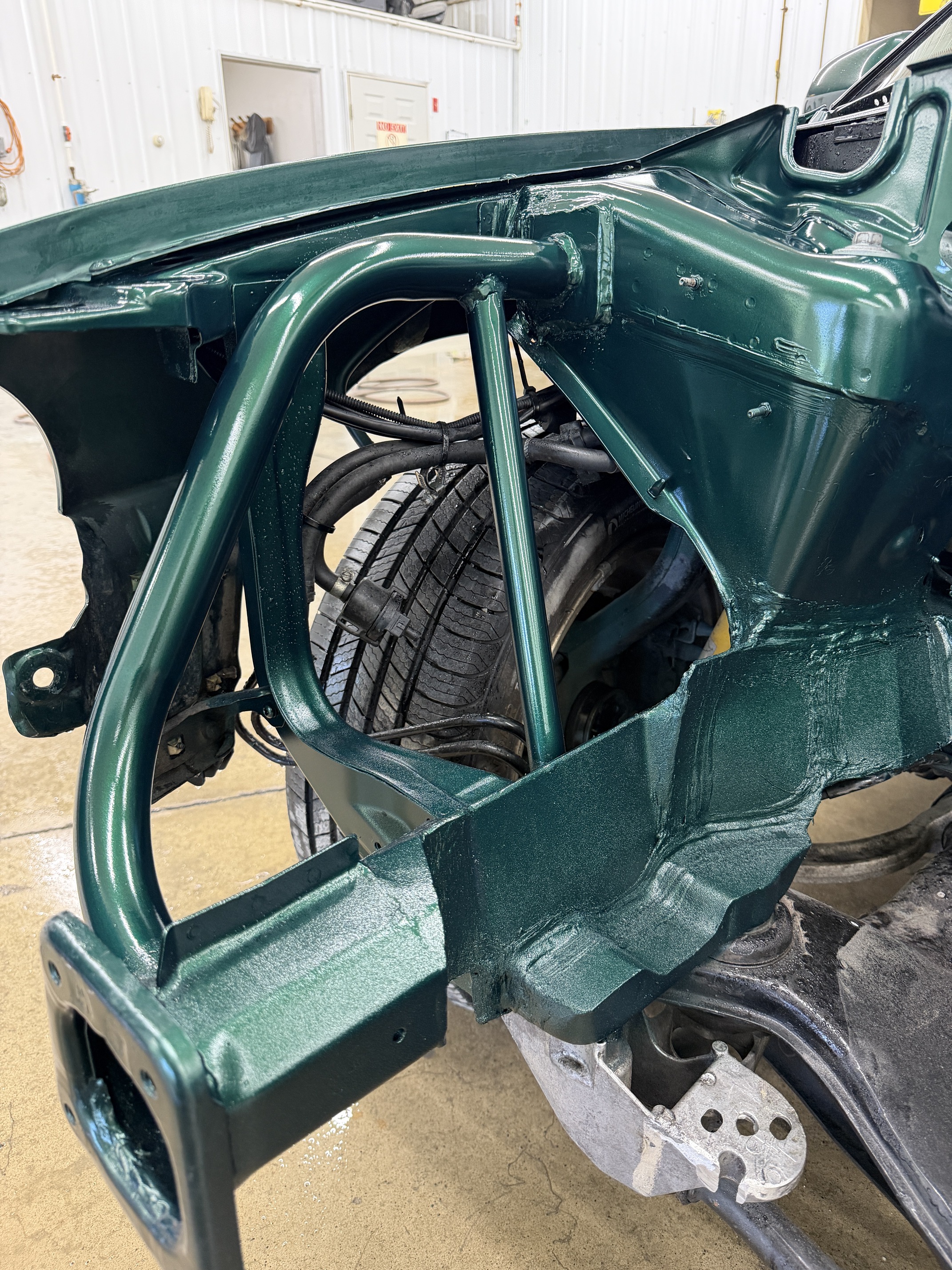

Here’s the cutting it took to fit the package in. Used 18GA mild steel to patch the rails back together and 12 GA for the subframe. I have since seam welded it all and am thinking of adding some DOM from the strut tower to frame rails for added structure, much like you see on drift builds.

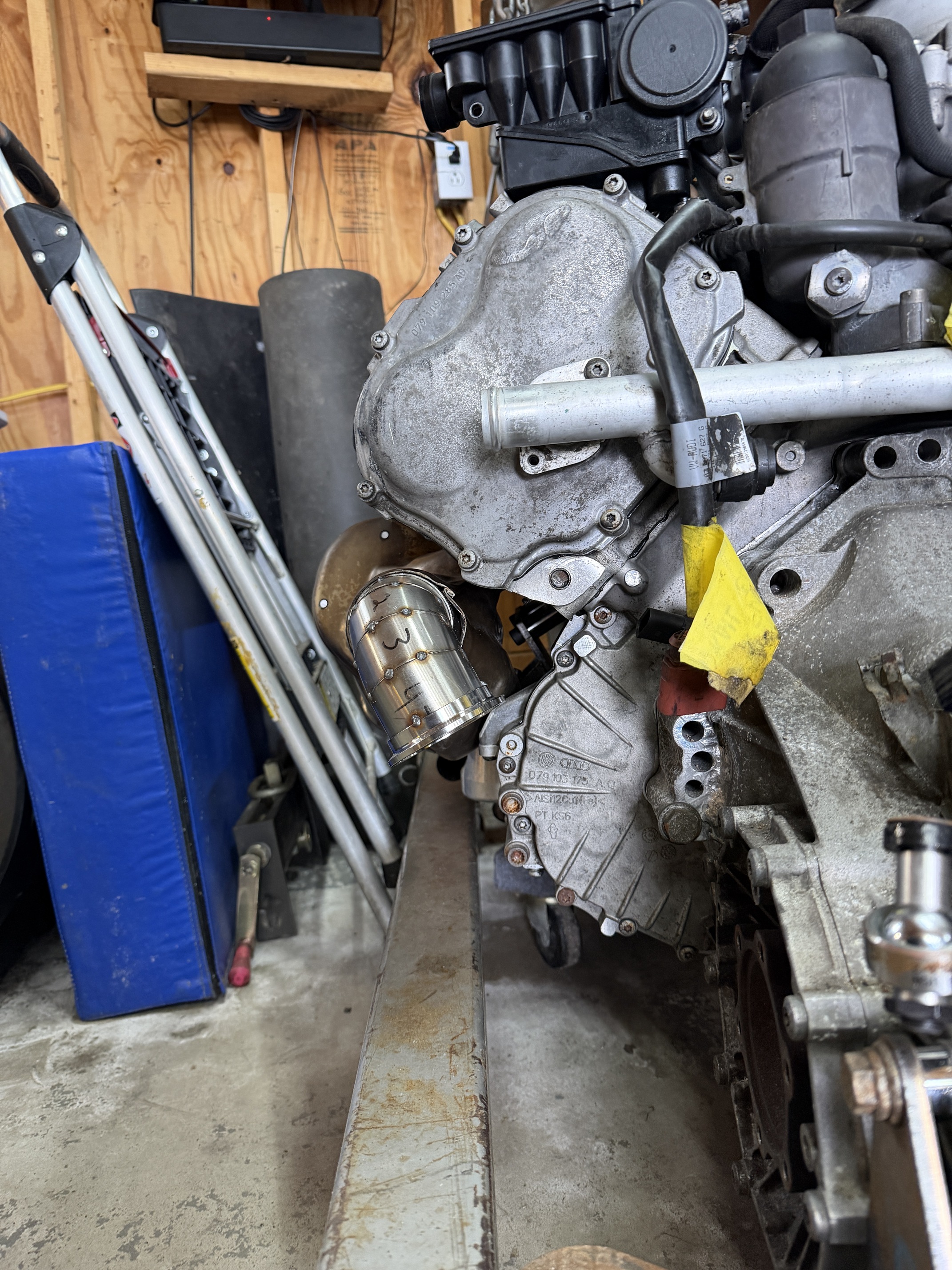

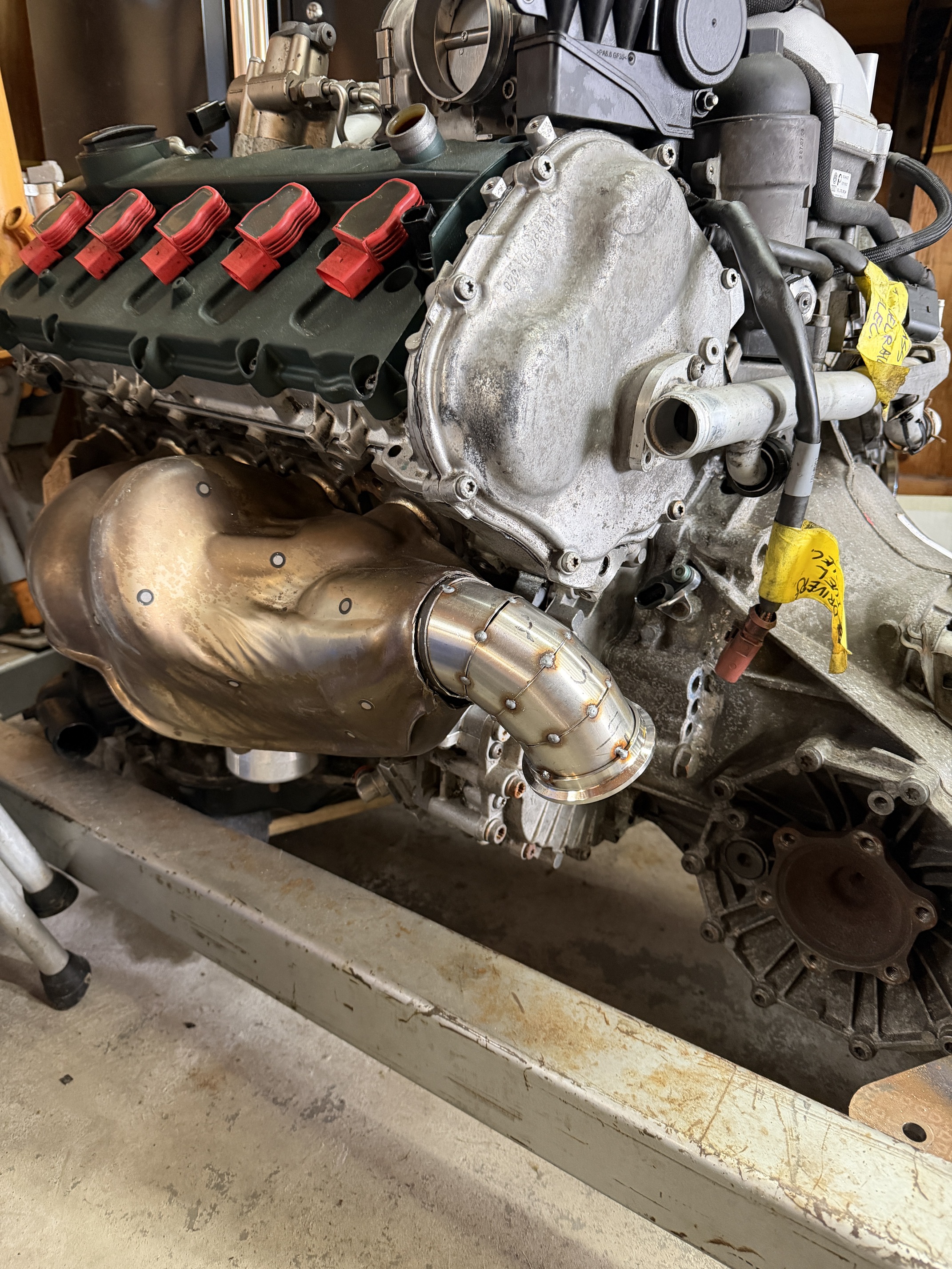

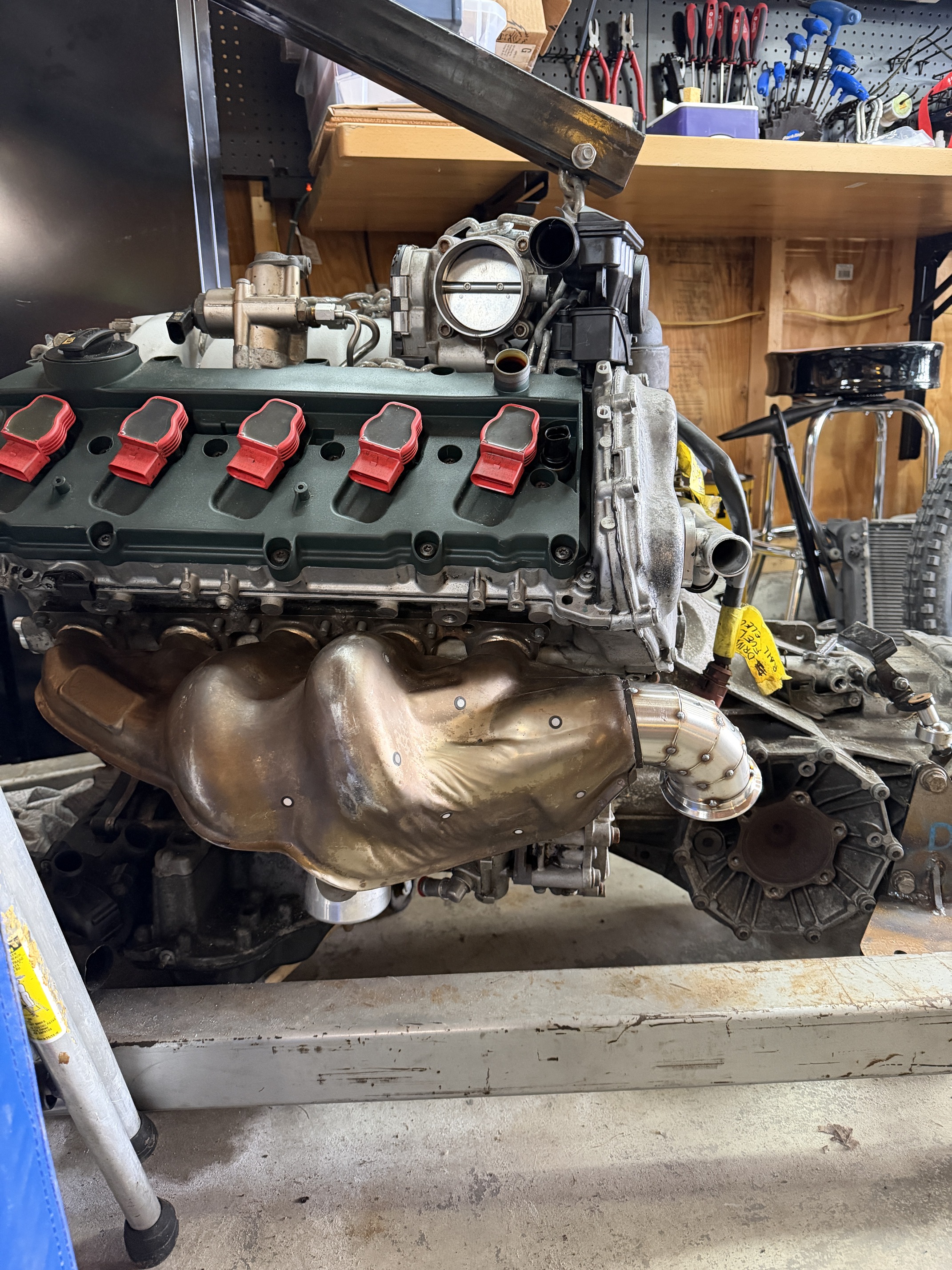

Happy with the Gallardo header fitment. I had to cut again after these pics and angle the output with the 45 deg of the heads, so I can clear framerails with the vbands.
