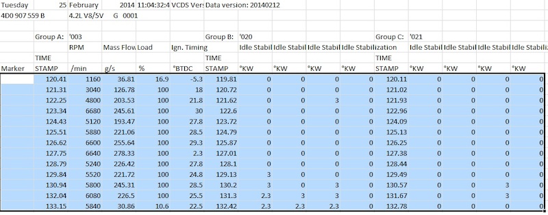

Had some extra time today so I decided to run some logs on the S6. Car has 208k miles /334k km and no mods to the engine. The only mod to the exhaust was to replace the cats with Magnaflow high flow units.
Temperature is -8 degrees celcius. Run is from low RPM in first, full throttle through second, and up until high RPM in third.
http://ep1.pinkbike.org/p4pb10653275/p4pb10653275.jpg

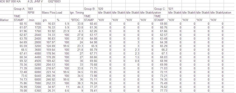

For comparison, this is a 3rd gear run from my Audi A6 4.2, with ported S8 heads, S8 intake, Miltech dps, Magnaflow high flow cats, and full 2.5 Magaflow exhaust with catback. It was JHM tuned.
http://gp1.pinkbike.org/p4pb9142327/p4pb9142327.jpg
Some interesting notes:
Airflow looks comparible. The S6 max of 278 g/s is higher than the A6 on this run, and close to the highest I ever logged on the A6 (285 g/s). I did cut a hole in the bottom of the A6 airbox, which may have actually been detrimental to airflow. Regardless, I would call airflow a tie.
Timing. The JHM-tuned A6 is able to run about 10-15 degrees more advance at high RPM. It looks like the S6 maxes out about 20-25 degrees, where the A6 hits over 38 at 7000rpm without any retard. I have read that 1 degree of timing can equal 1% hp gain, up until a certain point. However, I guess this could not be verified unless you did dyno testing. If the estimate were accurate, then the A6 would probably have a peak HP about 35-50hp higher than the S6 (which is actually right around where I would guess it to be if I hadnt done any logging).
