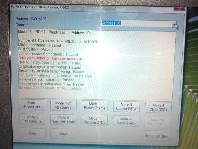

   Also I was playing around on VCDS after I put everything back together that I took apart so I could try to run readiness check. When I checked my o2's,  they are running about 1.0 lambada but would fluctuate a little, which is where its supposed to be? I don't remember what voltage they were reading but I read that you can't really check accurate voltage with VCDS anyways because it changes. Anyways here is my VCDS screen, it says the catalyist monitoring system is not even installed or it failed....
what I’m trying to figure out is that my cats aren’t dead and I put in o2’s and it doesn’t solve my problem, I just don’t have the extra cash to buy DP’s anyways otherwise I would, and my next question is…

Also one last important question, when i intitally received my engine vibrations I went straight to my Indy and the guy who normally works on my car wasn’t available but another guy checked it out and said my front o2’s were not even reading but as you can see in VCDS it says they passed, So was the guy lying and I need to find a new shop ?
Did he use VCDS or a generic OBD-II tool/cable?
He might have gotten a wrong reading if it was generic?

did you reset the codes or disconnect the battery recently? Cat readiness takes some time to set properly.
It looks like cat efficiency codes, so you could try O2 spacers/gutting the cats in lieu of buying downpipes.
What are the emissions laws/checks in your state?
yes I did reset… i’ll try to go for a drive around the block i guess, i hate to drive it like this cuz I think i’m running rich? but if it needs to reset its not going to do it sitting there idle, i start it up every few days and let it warm up but other than that it hasn’t been driven.

you’d have rich codes if it was dangerously rich (same with lean)… lambda = 1.0 is how its supposed to run as long as egts are low (it richens in response to high egt or knock)

I went for a drive around block, CEL came on… So I checked it and it was same 2 cat codes… but I ran readiness and everything passed… ???
