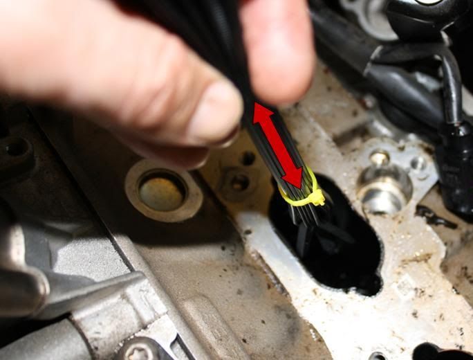

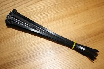

I think guys are using a bunch of zip ties bundled together. Here are some pics that Jimmybones posted
http://i284.photobucket.com/albums/ll37/Jimmybones777/038969.jpg
http://i284.photobucket.com/albums/ll37/Jimmybones777/038968.jpg
They also bundle a whole bunch of them to the end of a drill as another tool for the cleaning (sorry, cant find a pic at the moment)
