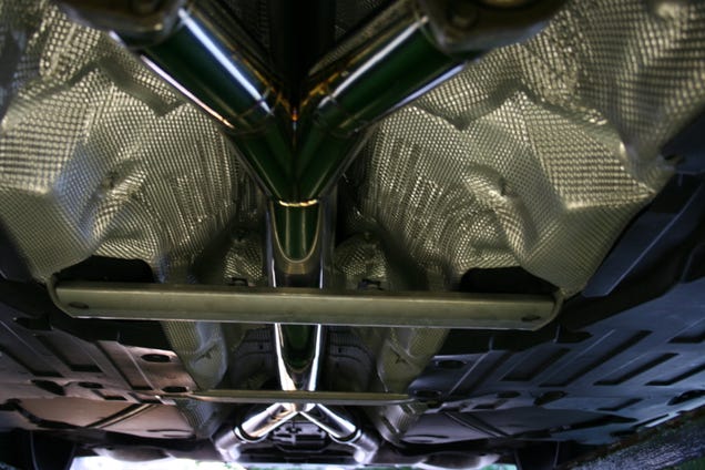

If you want more growl from your S6 for cheap, then delete your stock resonators. While you are there, it wouldnt hurt to install an x-pipe (factory is an H). If you have a bit more dough to spend then go for an aftermarket exhaust. I can recommend something if that is what you want. This is the stock S6 exhaust
http://ep1.pinkbike.org/p4pb11276995/p4pb11276995.jpg

Yup cold start cycles are very loud. The car is running with a max attainable load to try and quickly warm up the car. The noise is more the car trying to warm up the cats then the actual motor. You S6 guys are kinda screwed because of your cat siuation. Unless you remove the pre cats you need to keep the cold start stuff. If you remove them jhm can make you a quiet start program

Also Just wanted to point out from my experience that the “factory H-Pipe” is actually not. That’s the piece i cut out to install my Xpipe. It was a solid piece that’s why the factory sound sounds so uneven
Good to know about that connecting bar not being hollow. I just assumed it was an H pipe.

yeah an X makes more sense. the goal is to allow the streams to mix when they want to, not force them to

Good info B. It is surprising the high percentage of expensive aftermarket exhausts that have poor design. It is like the guys designing them have no idea what they are doing.
Exactly. The single pipe idea is terrible. You want to create more low pressure transitions not build a low then high pressure siuation like with the single pipe
Yep. It is really amazing how many bad exhausts are out there.
