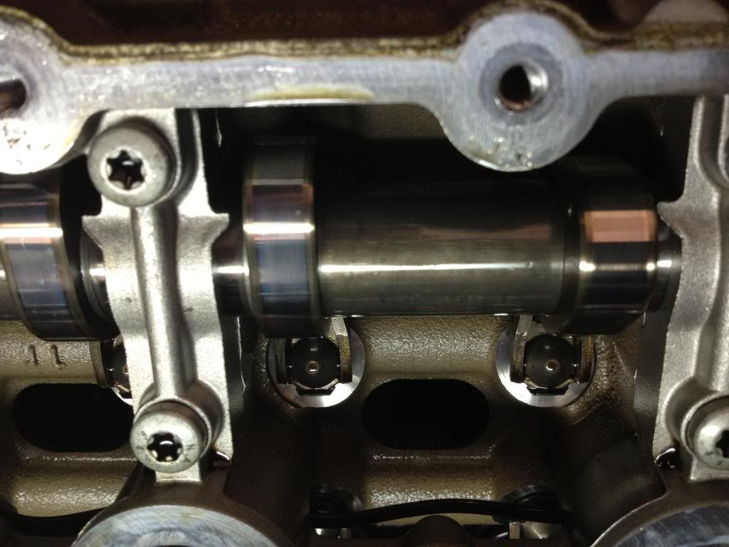

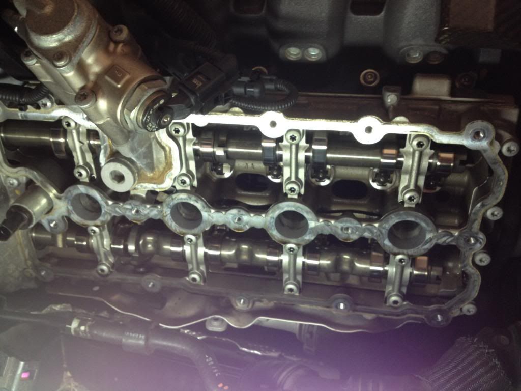

It’s been awhile since I followed up on this. I’ve been knee-deep in my 190e and haven’t touched the RS in months. Finally got around to swapping the valve cover and gaskets. Fun pics:

I was quite surprised at how clean the heads were…no marring/scoring on the cam lobes, I was quite happy to see this.

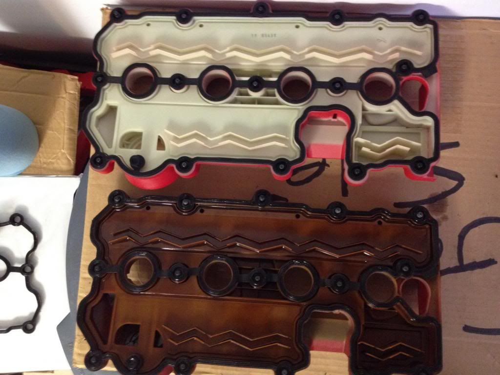

I haven’t seen anyone post these yet, but here’s a side-by-side comparison of the two valve cover variants…I’m guessing you can tell which one is the old one:
http://i172.photobucket.com/albums/w2/koolade9/Ibis%20RS4/IMG_4685_zps45b52545.jpg
A couple things to note: the crankcase air has to travel through the opening (bottom left of the cover) through the length of the cover and from the top to the bottom and back to flow out through the PCV outlet. I don’t see any real differences in the passages. The primary difference between the two is how the gasket is routed. On the old cover, the last spark plug seal doesn’t go a full 360deg. The new design resolves this. After further inspection, I was leaking oil here that creeped down the side of the head and out the back side of the timing cover, making it look a bit deceiving. I’m willing to bet this is a common problem on RS4s with this early VC design.
As an update over-all, I did a 600mile road-trip/canyon run a couple months ago, and it didn’t smoke at all during that trip, and has smoked only once briefly since then. If I really had a bottom end issue, that should’ve exasperated the issue. If anything, I’m guessing the PCV started working properly again. I’ve replaced the PCV while changing the VC & gaskets, and cleaned the oil residue from around the back of the head, so we’ll see if A. it’s still leaking at all. B. if the new PCV keeps the smoking at bay from here on out. If it happens again, I’ll re-visit this thread. The next step is a catch-can. Not for the sake of stopping oil vapor, but to open up the breathing capacity of the PCV system.

nice, is there an update for the driver side and passenger side? or just one side?
Bank 2 (driver’s side) only. The passenger side is already designed to surround all the spark plugs.
Are you 100% positive? I could of recalled its the passenger side.
Please refer to the picture above where I have actually done this already.
