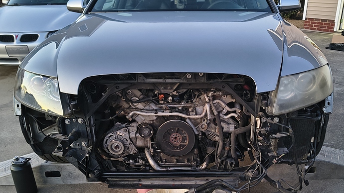

I pressure tested the coolant side of mine while I had the engine out to make sure it held pressure.
I think there would be oil in the coolant too if it was the cooler with the pressure differences, I guess if the car hasn’t run as much the oil in coolant wouldn’t be as noticeable. The only way I can think of to know for sure is to pull it and test. Maybe do a pressure test on the coolant and listen for any leaks?
Also my leak was the radiator. Did the oil cooler o rings while it was off too, that was aggravating and couldn’t even get the hoses off of it.
