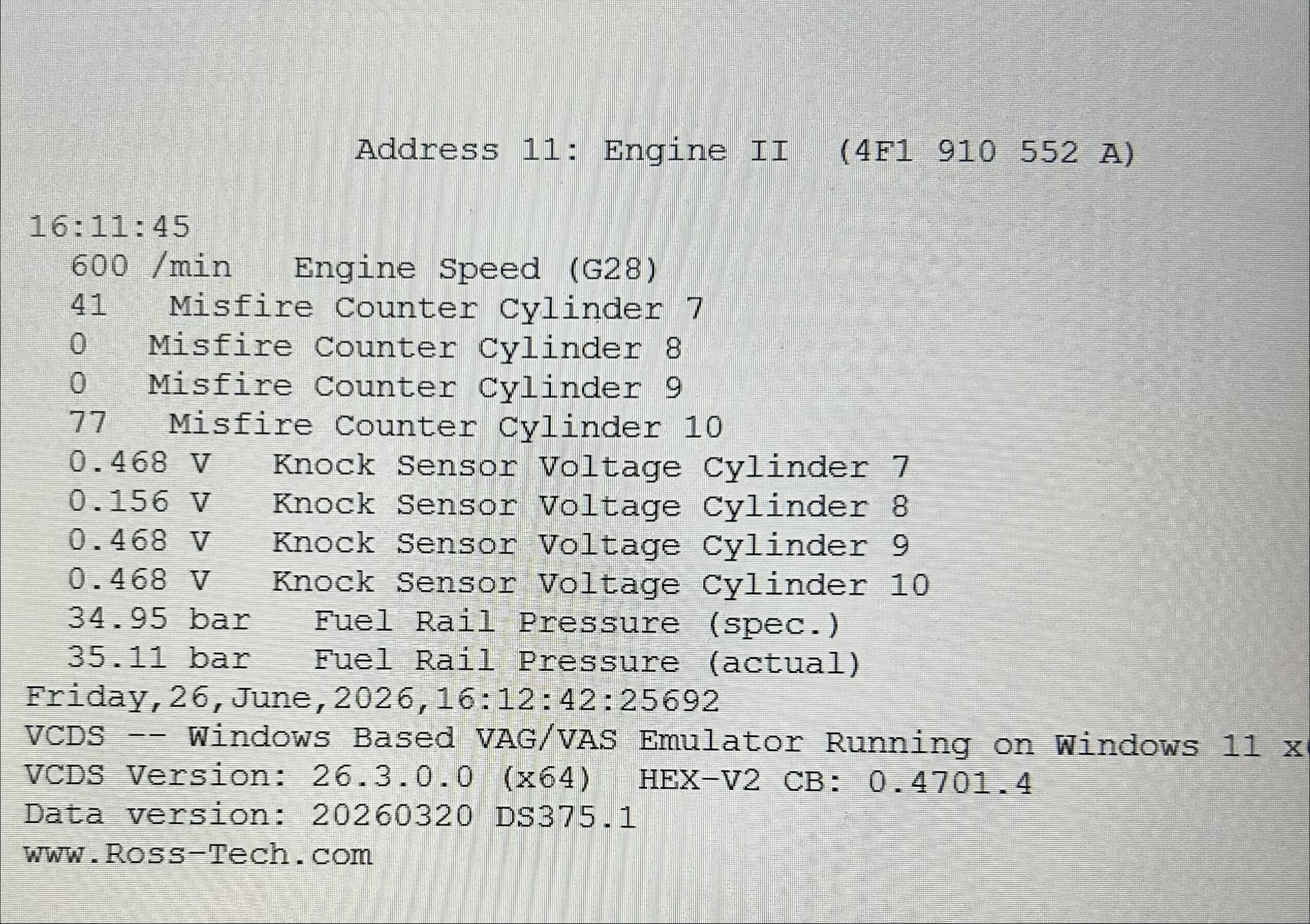

I put in a new CPS and not surprisingly, I still have misfires on all cylinders except 5 & 8. I agree that it isn’t actually misfiring, but now it throws it into limp mode. If i turn it off and restart, it’s fine.
After that i did the reset all learned adaptations, which also did nothing.
I don’t have an oscilloscope, but it’s been on my list. Probably would be good to watch the wave forms on the CPS. Is that what you are thinking.
I made a ton of logs and don’t see a smoking gun. Fuel pressure is good, cam adjustments look good, lambda looks good. You would think lambda would be all over the place with the misfires. I do see that the voltage on the knock sensors that are “misfiring” are all .468v at idle and cylinder 8 is .156v. That seems like a potential correlation.
Any thoughts? Thanks again!

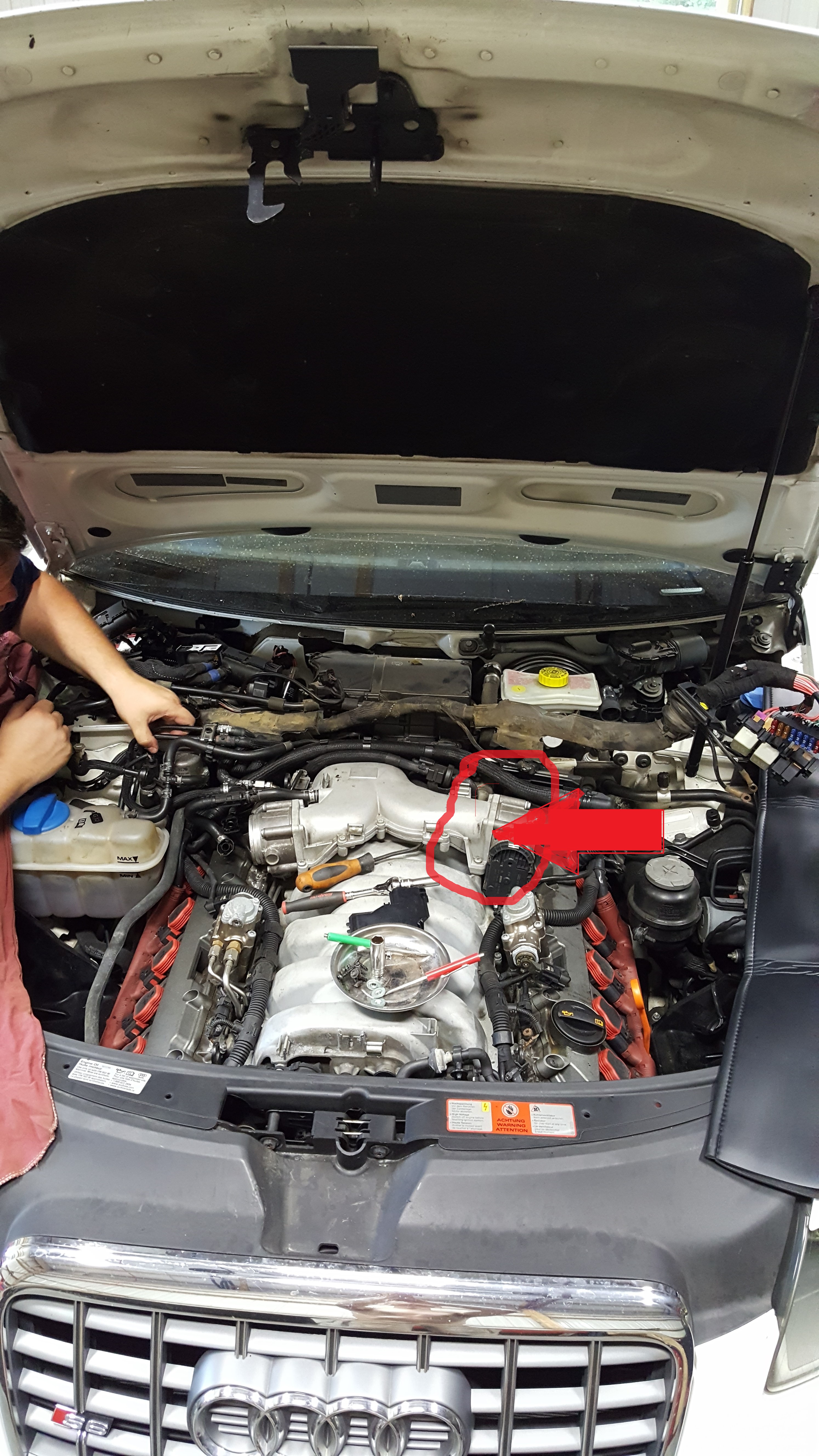

WOW… This should help tell all of us more then ever. This car is super sensitive to vac leaks or unmetered air issues.
Great work Rkuffel - thanks for jumping back in and letting us know. We will all now add this to our list. Of last resort look to issues.
Had something similar. Where the throttle attaches to the Y-distribution was not sealing. The Y-distribution was warped at the mounting interface.

Yes, I had some air leaking there too, but a new gasket fixed that for me.
