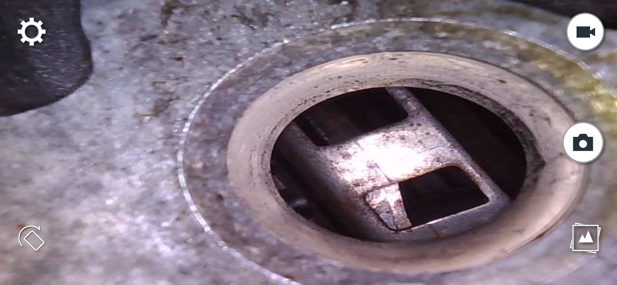

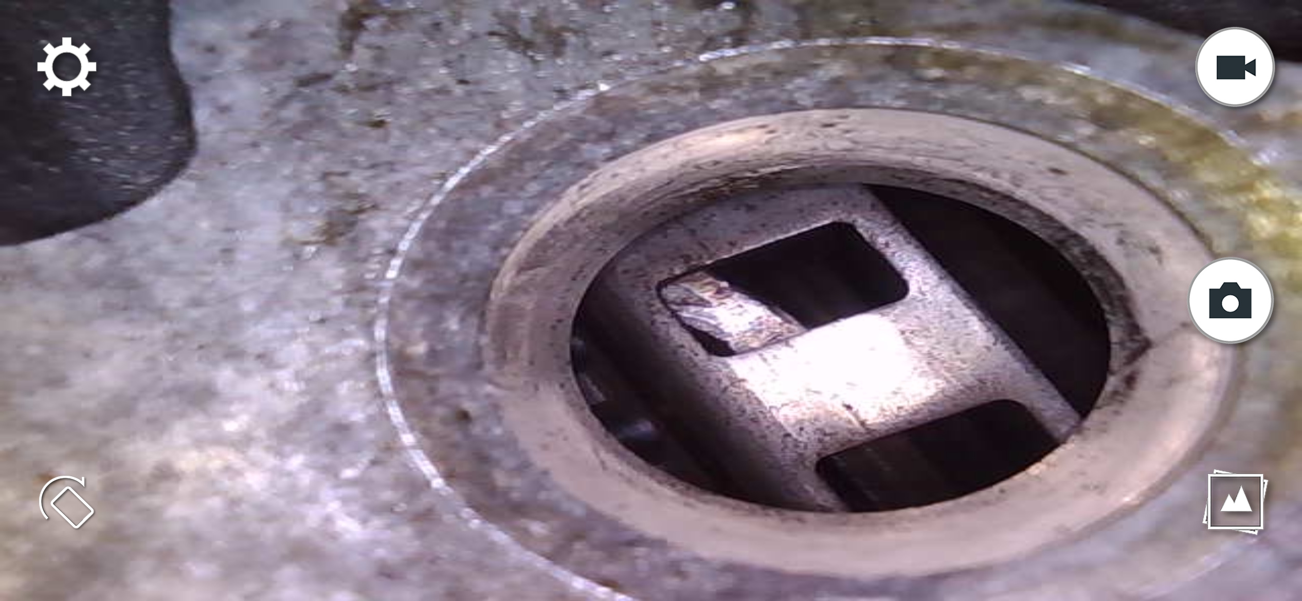

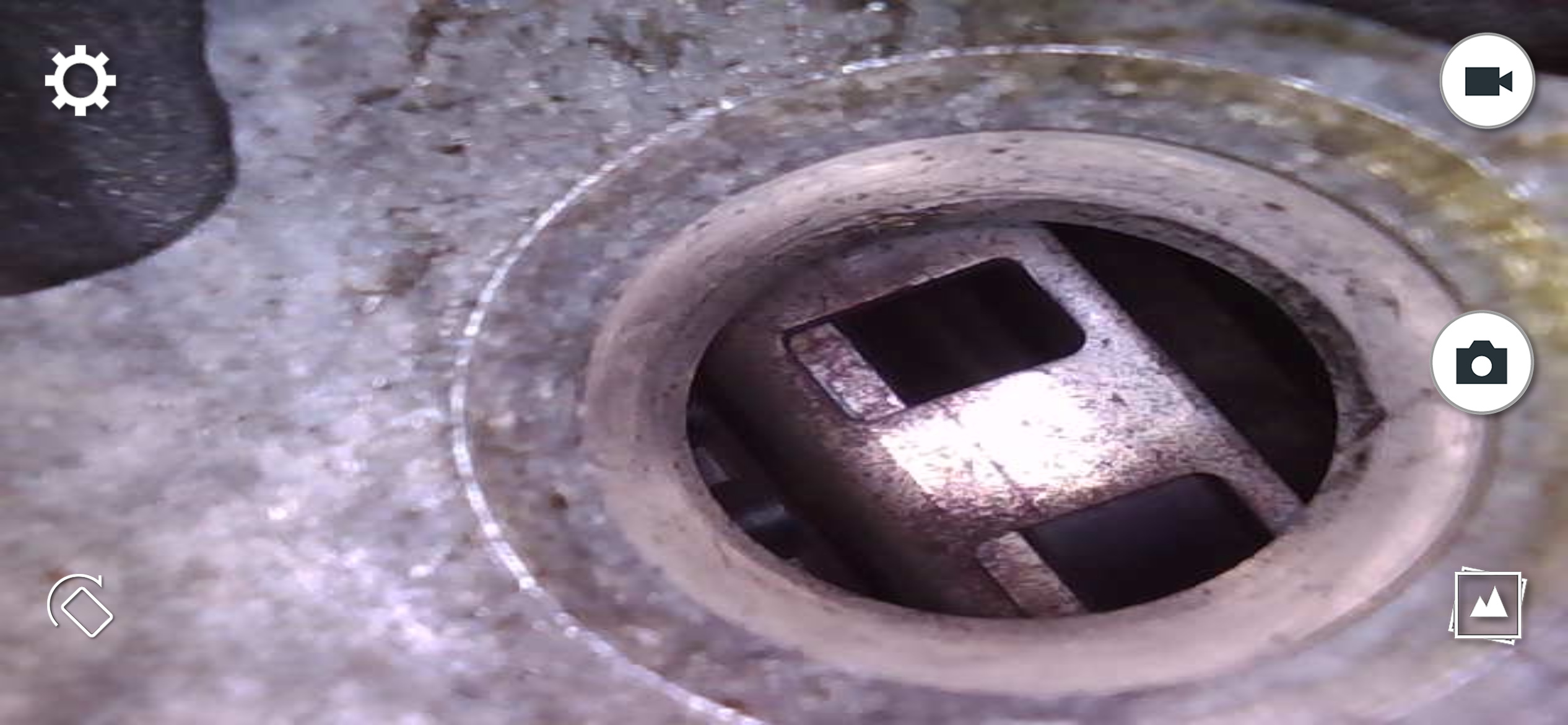

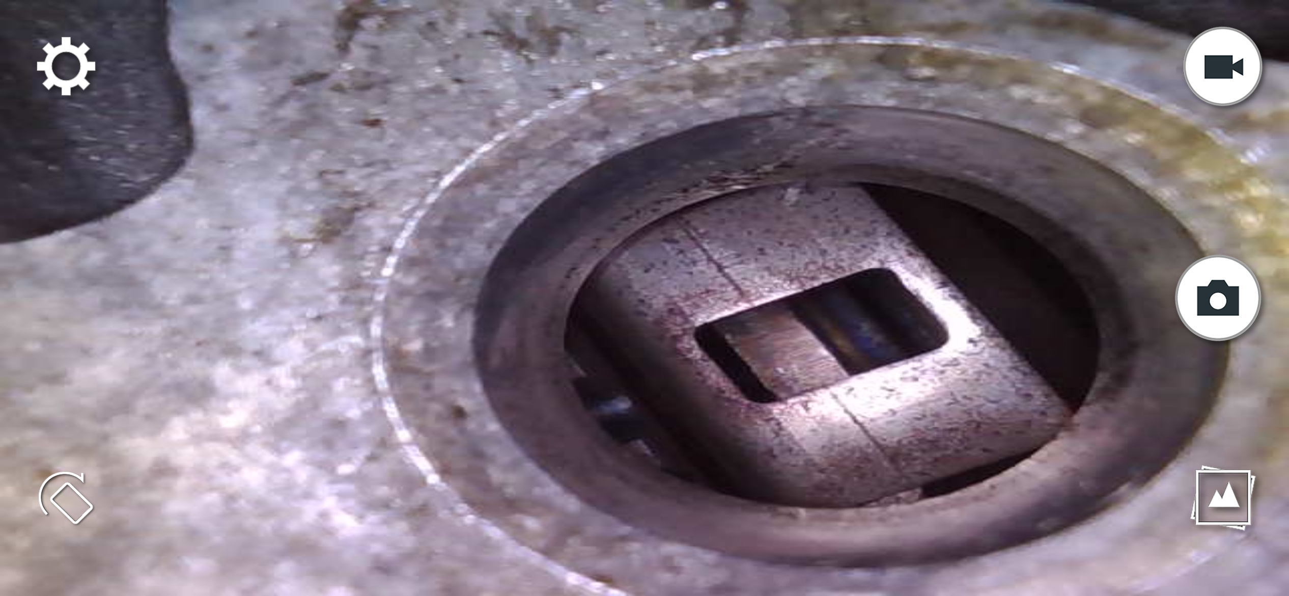

Roger that. Thank you. I’ll post my findings. Gonna check the flywheel too for any weirdness while i have the plugs out.
Not sure of what I’m looking at here, but, here are some flywheel pictures and I noticed this metal band that seems to cover up a lot of the relucter ring gap. It seems to run all the way around but moves in and out and just so happens to be the closest and most closed off when cylinders 8 & 5 are at the top of their stroke. It doesn’t seem like coincidence. But, I don’t know what normal is on these. It doesn’t budge at all. I almost wonder if the cps position and distance from the relucter ring should be slightly adjusted. I ordered an OEM cps because I’m already so deep in this, why not. :joy: :sob:
I ain’t gonna lie, I havent had similar issue with my car myself, BUT 2nd and 3rd picture looks like there might be something off. Are these pieces loose, or not?
EDIT: I have checked for flywheel pictures on the web, these “windows” should not be blocked IMO. Might be the culprit. Looking for anyone else to confirm (I won’t be able to take CPS off to see how it looks in mine in the nearest future)
Thanks for the reply. They are super solid and actually, they occur about every 120 degrees so. Im wondering if they are some kind of clamp. I’m going to assume it’s normal for now. I did inspect all of the cam position sensors and they had some sludge on them with magnetic goop. The engine is not sludgy fyi, just those magnetic parts. I cleaned those off and reinstalled. I also thoroughly cleaned the CPS, took pins out and cleaned them, cleaned the connector. When I went to put it on, it didn’t want to click, SO, now I’m wondering if the CPS connector was coming loose. I’m going to go for a test drive and see what happens. OEM CPS should be here tomorrow. Thanks for the help! It’s nice not being totally alone on this.
It could still also be the manifold flaps, but gonna scratch this off the list first.

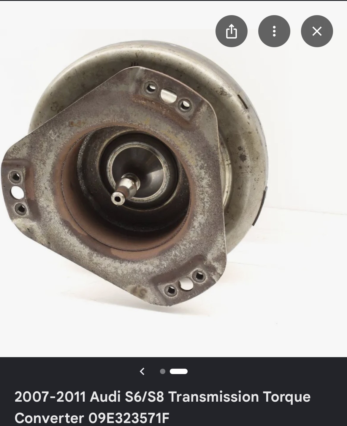

I think what I’m seeing is the torque converter mounting plate.
I put the car back together after cleaning the crankshaft and camshaft position sensors. The new CPS is shipped and will hopefully be here tomorrow. So here’s the crazy part…now the logs show misfires on 10/6/4/3 and zero misfires on 5 & 8. So I fixed 5 & 8 but now the other cylinders are misfiring. :joy: interestingly 5&8 are still differentiated from the other cylinders. Now I’m wondering if it’s some kind of adaptation issue. Guess I’ll hold off until the new CPS arrives.
