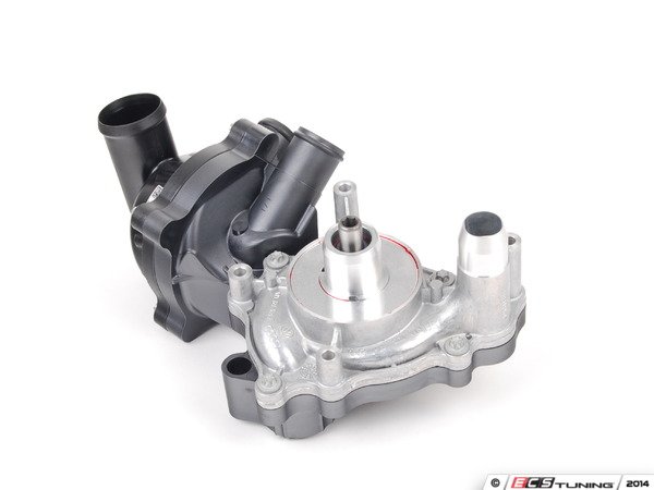

BTW, we replaced the entire water pump assembly, not just the pump itself. I have seen the plastic crack on a few occasions, so I wanted to make sure it was a new complete unit.
079121013N (which is the updated part)
http://c1552172.r72.cf0.rackcdn.com/618500_x600.jpg
http://www.ecstuning.com/Audi-C6_S6--V10_5.2L/ES2779944/
