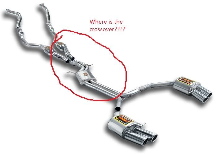

Fick that is going to be some exspensive shit…
What is the diameter of the cat back, I wonder how much research went into this exhaust, I can tell your from the 3.0 it was very little.
not sure how important a crossover is on a sc 3.0 v6…maybe beem can chime in.
however the exhaust looks 2.25 or so. That right? Doesn’t seem right for a car capable of 400 to 425 hp with just a tune…and pushing 500 fbo+race gas
this reminds me of capristo rs4 stuff…lotsa flash but not much thought it seems

I dont think V6s are going to be as sensitive to having a crossover since iirc (I did it out on EA some time back) with the firing order and firing angle of a split pin V6 you shouldnt see collector crowding to the same degree as a cross plane V8.
Its still an important sound deadening trick, honestly unless its a race car stupid loud exhausts get very tiring

No need for a crossover on the 3.0? Learn something new everyday.

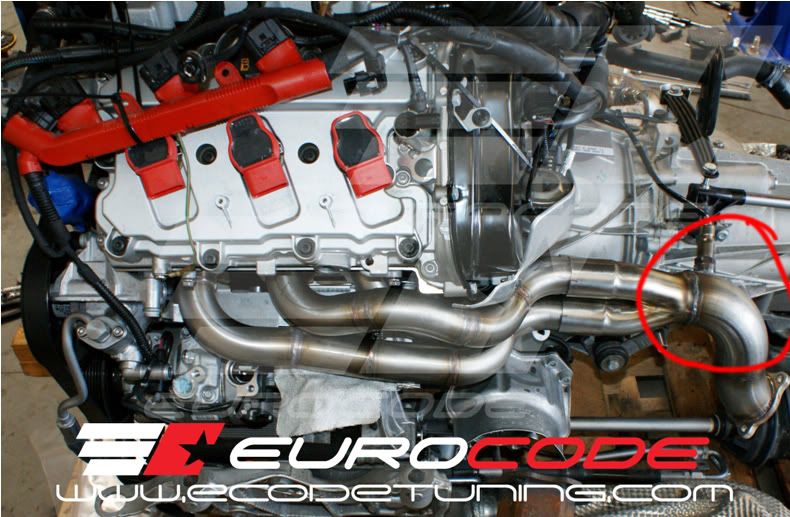

So what about equal length headers? Is that something that the design of the 3.0 becomes exempt to?

virtually an impossible thing due to no room but yes equal length would be optimal. theres less room in the tunnel area(less room than b6/7 cars) because the transmission is monstrously huge in this car. its roughly the size of an A8 trans
these are the current headers that have been tested and built for this car(although one has some radical fitment issues, ill ignore that for a minute lol). they are both very different design but share one major similarity. where the header sweeps down over the trans. and thats because that area of the tunnel literally has not much more room then that.

I felt like Beem explained once that equal length wasn’t AS crucial on the 3.0 as it is on the V8. I don’t recall exactly why though. I think he also was mentioning that true long tubes would be good, but no where near the gains that the B8 saw. I think in part due to the firing order and flow of gases. I’m sure he can explain everything I’ve butchered.
the JHM S5 headers have a similarly less-than-convential design to work around that issue
as far as the crossover, it may help but I doubt as much as on a V8. I’ve never owned a V6 so I’m not sure, but judging from firing angle/order you probably wont see the back to back firing event that crowds the collector on X V8s
I’m not nearly as knowledgeable about the B8 setup, but I wouldn’t completely rule it out. People absolutely mocked the B6/7 at even attempting anything but stock manifolds as there wasn’t room. Also the S5 shows the same similar curve that you show there:
