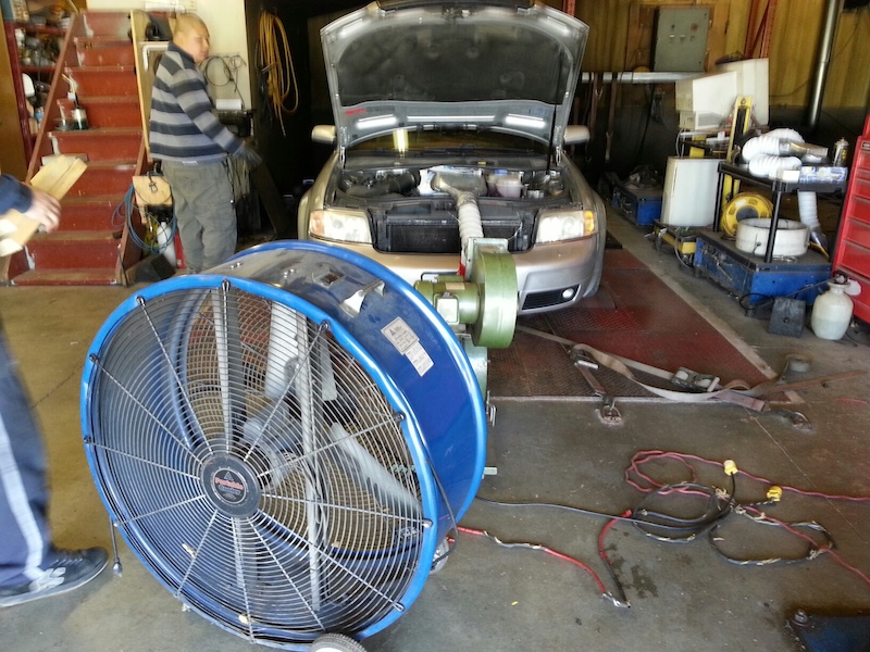

big fan

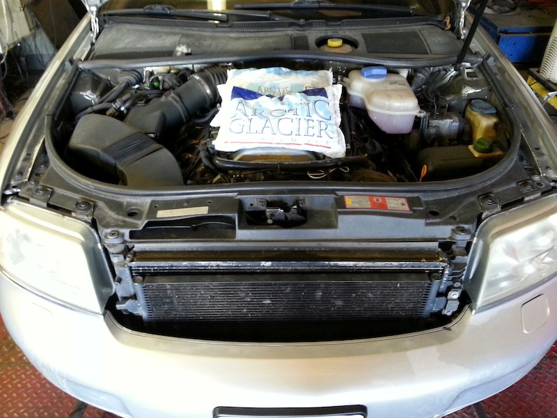

cold intake manifold

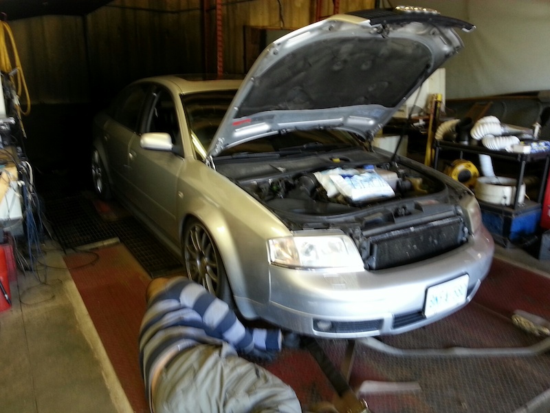

strapped down and ready to go
http://gp1.pinkbike.org/p4pb9624591/p4pb9624591.jpg
http://gp1.pinkbike.org/p4pb9624592/p4pb9624592.jpg
I told Andy from Neetronics that we needed to hit 300. Things were going well until about 7000 rpm when we heard a big BANG! By the look on his face, I know Andy heard it too. I had told him to go all out, as the car may be dismantled very soon, so he didnt let off until redline. Well, the bang was a large chunck of the tire flying off. If you watch the video closely you can see it fly off the wheel at about 1:00
