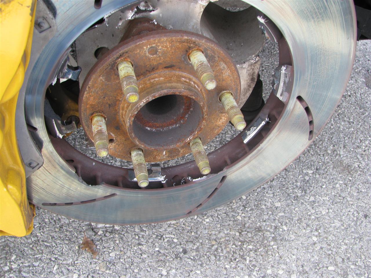

I would assume both racing brakes and girodisc are higher quality than the stop tech aero rotors. Rings, hats, floating mechanism, performance etc.
See this post though: http://ls1tech.com/forums/cadillac-cts-v/1716396-catastrophic-racingbrake-2-piece-rotor-failure-track.html
Not sure about this racing brake business :slight_smile: Asking Girodisc about hats again!
http://www.submariner.org/thepno95/Pictures/CTS-V%20pics/Suspension%20and%20Chassis/V2%20brakes/Broken%20rotor/broken%20rotor1.jpg
Thanks for posting that. A friend of mine was at that event when that Caddy had his brake failure. Never really got a good explanation of what happened until now.
Wow, looks bad!

The reason I abandoned AP Racing / Stillen for Brembo is a brake kit is a system that needs to be engineered together. It’s not enough to just measure and machine some hats that will fit a given platform. Specifically, the most important component in the disc is the bobbins that hold the hat to the ring. I felt that in the Stillen kit these were in adequate and would produce a bad shudder when heated to 700 degrees. I don’t think the system was expanding and cooling properly given the tolerances on the kit. Brembo does so much research that “it just works”. You pay for QA.
For the OP, if you’ve got a Stoptech kit I would buy the Stoptech rotor.
For the Cadillac guy, I have a good idea of what happened…
