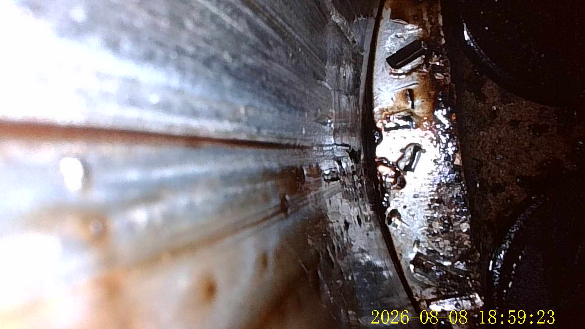

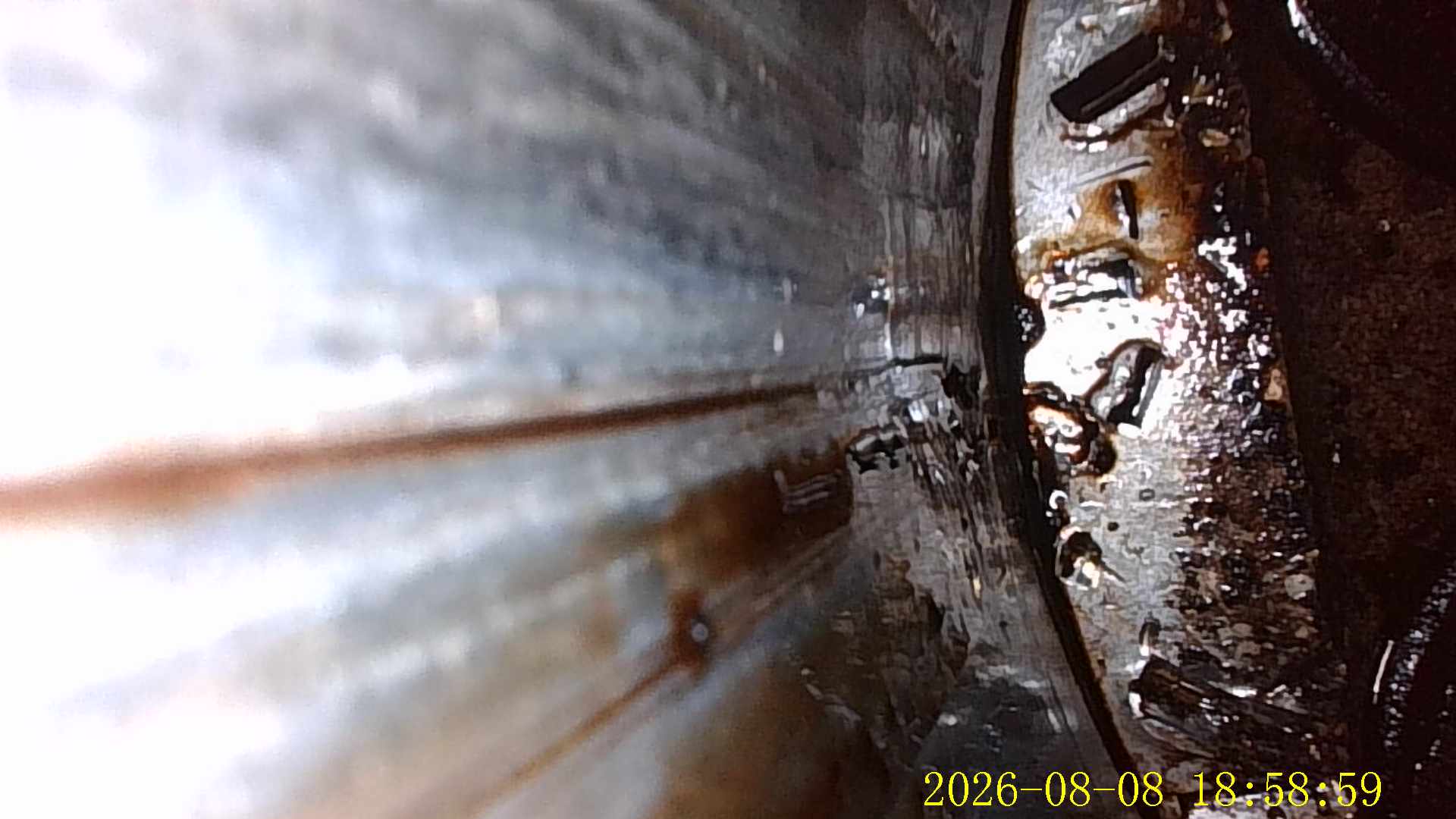

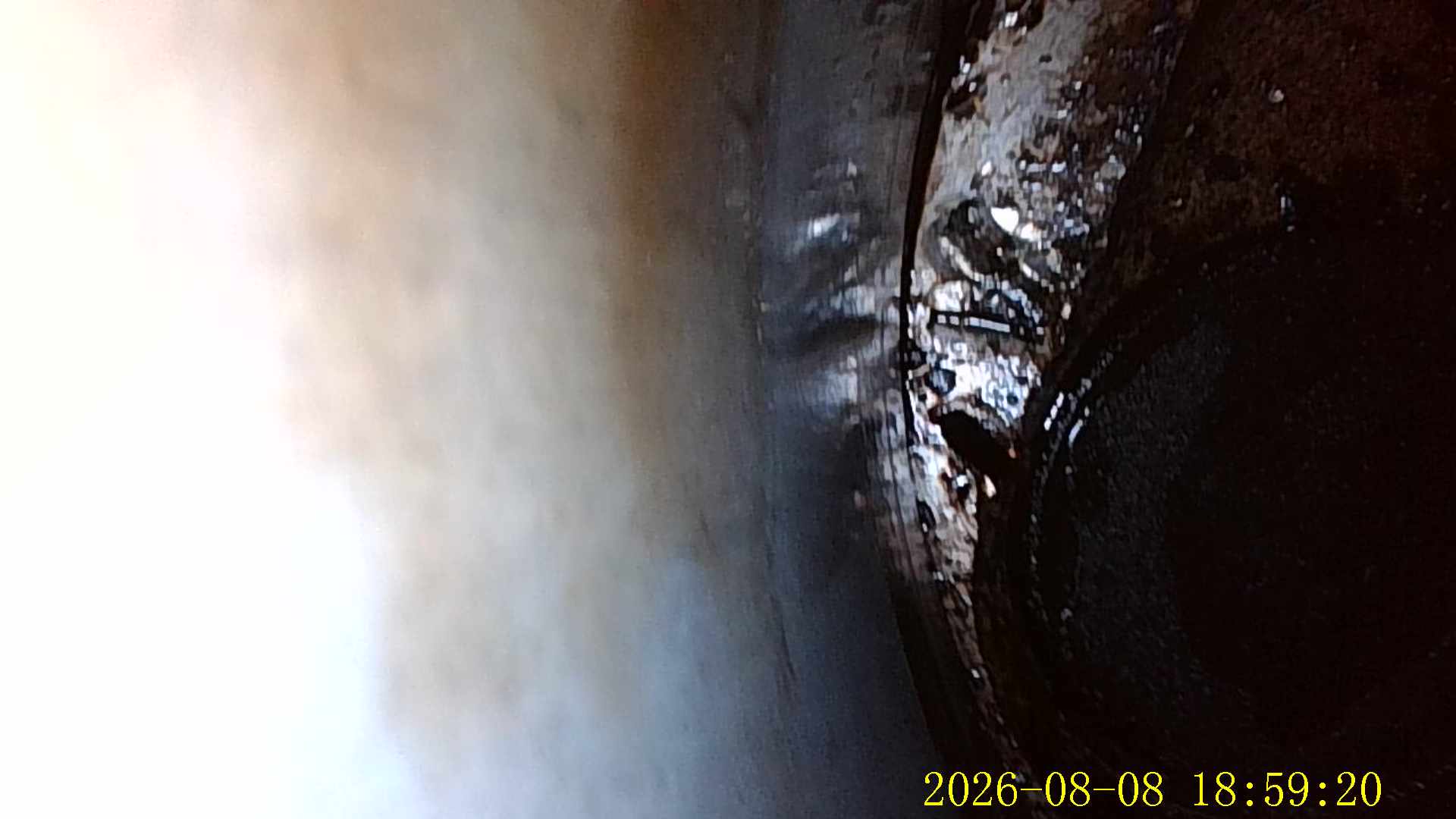

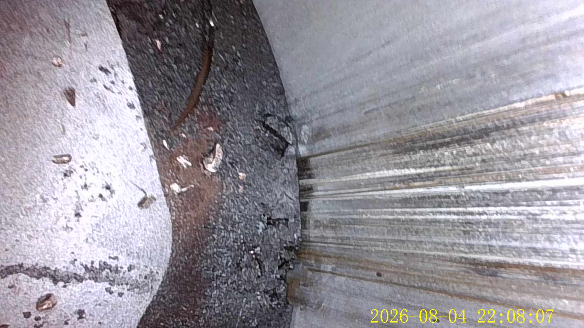

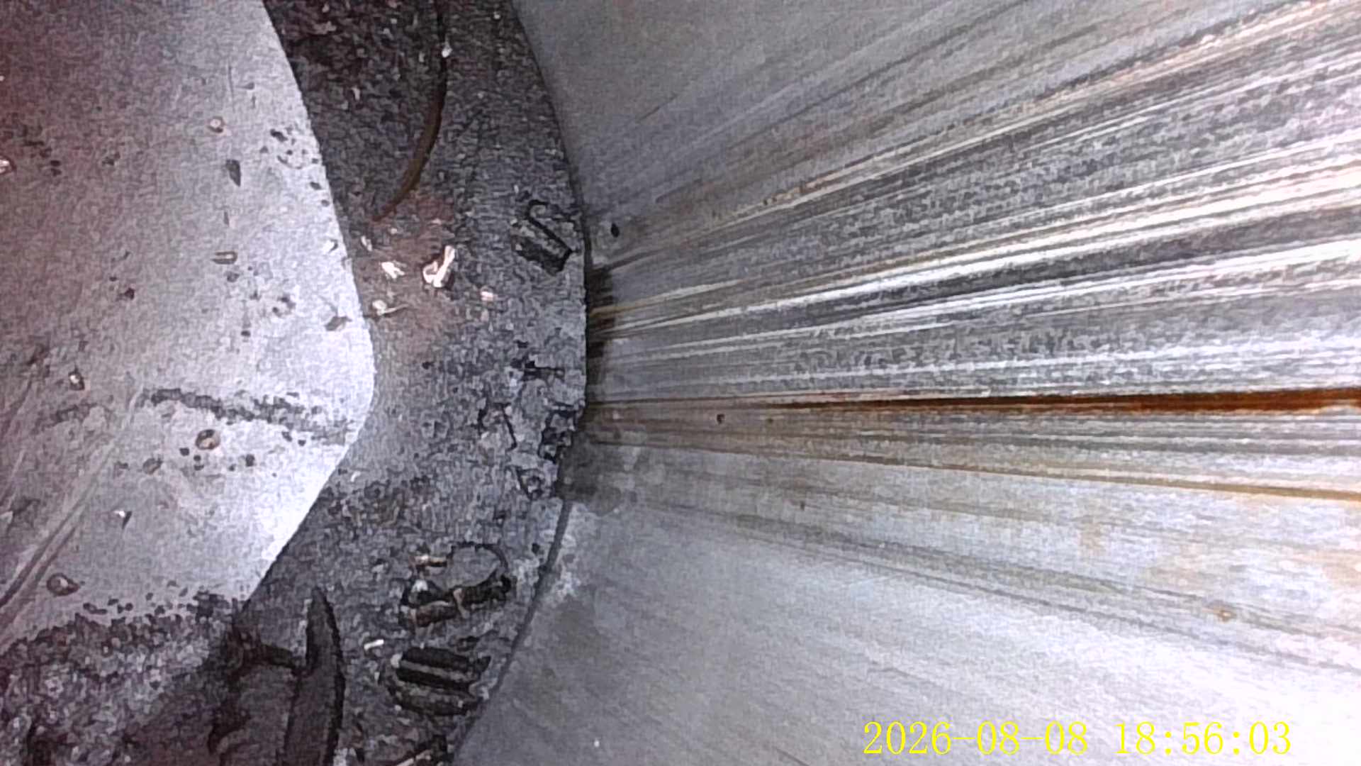

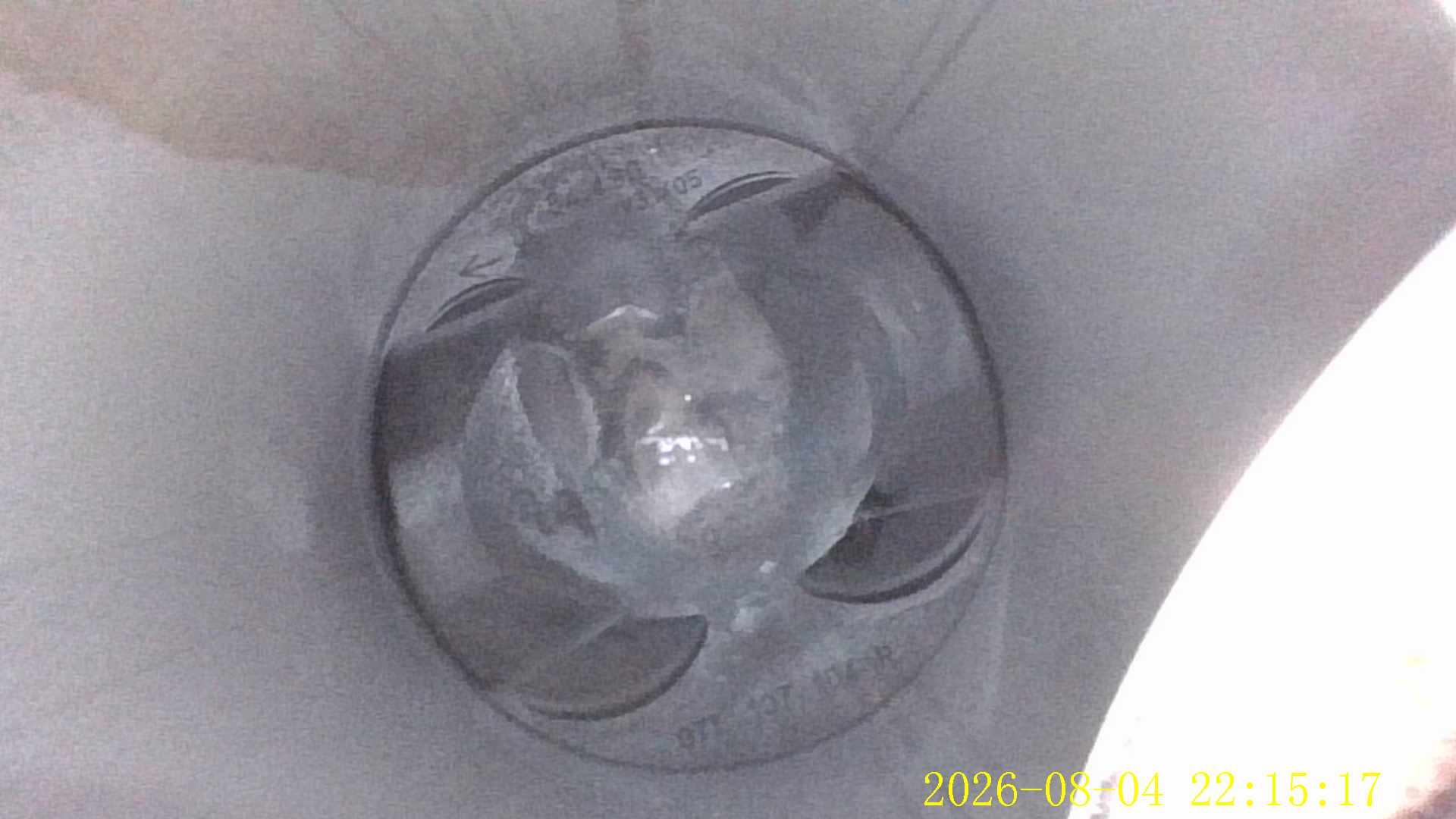

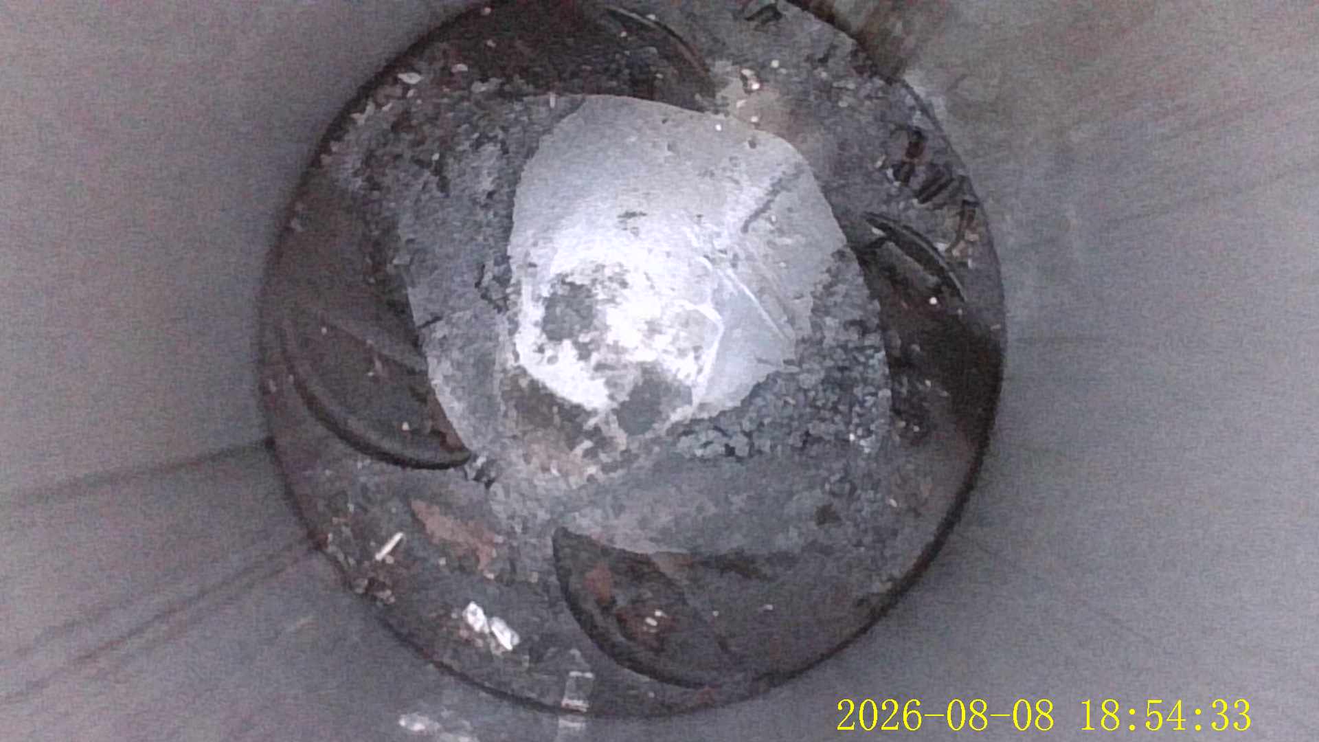

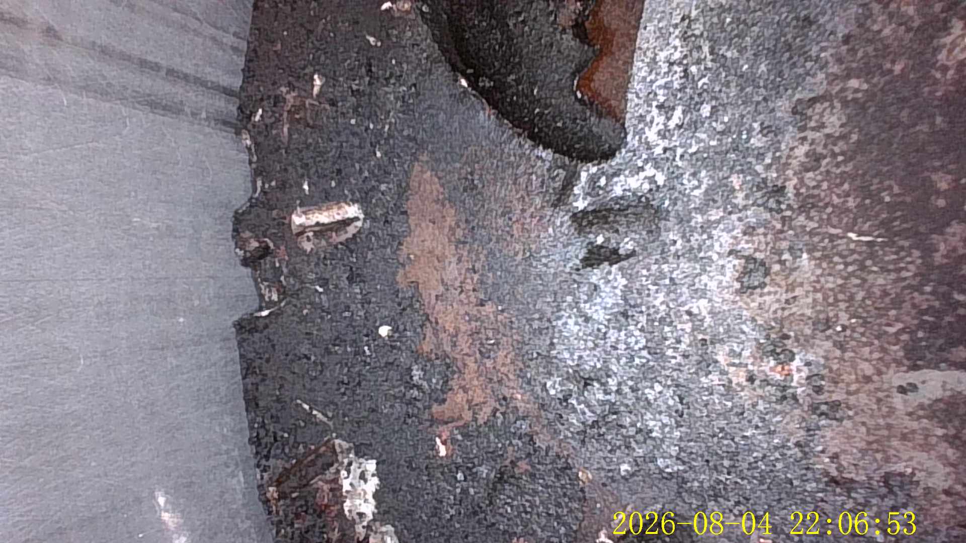

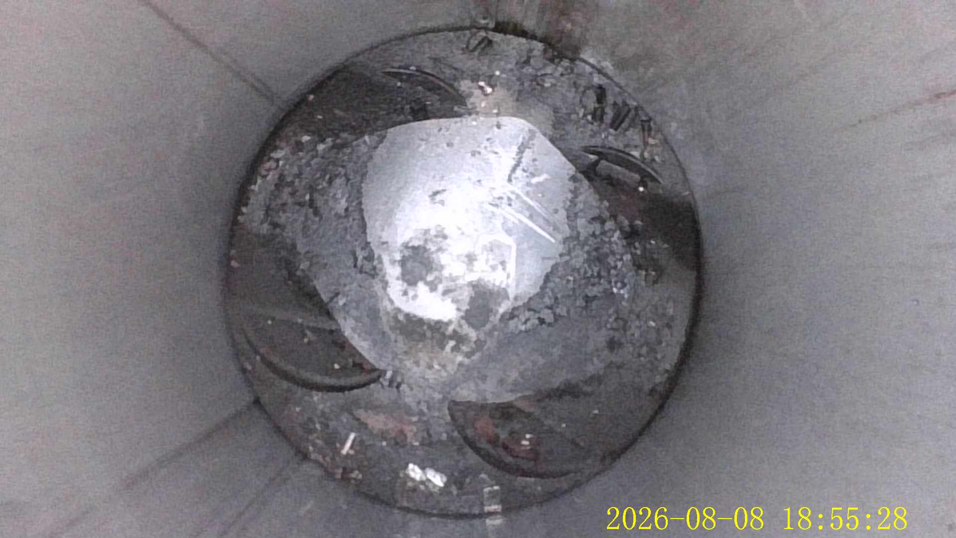

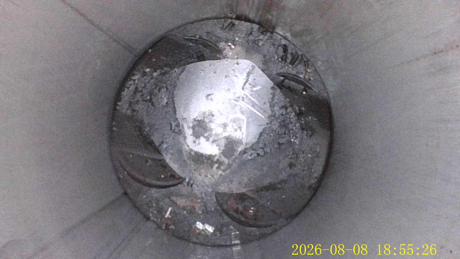

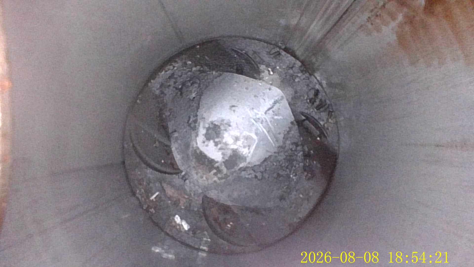

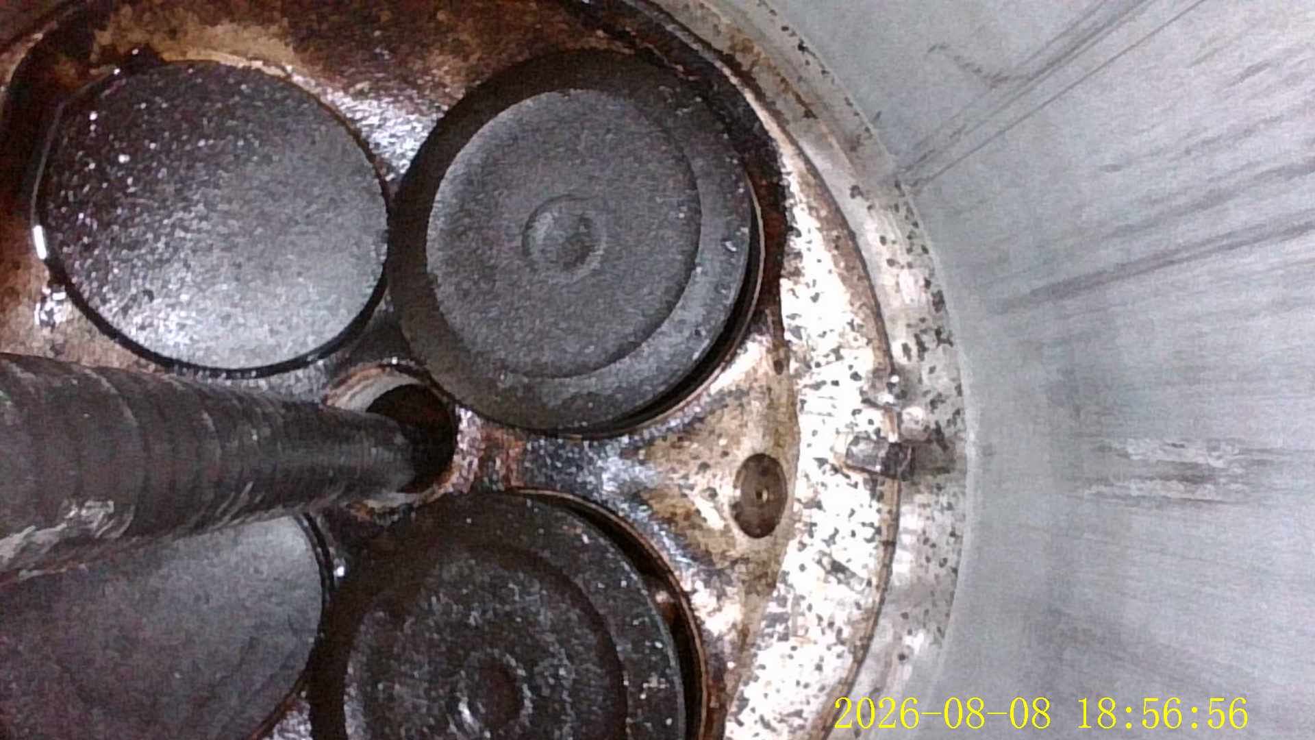

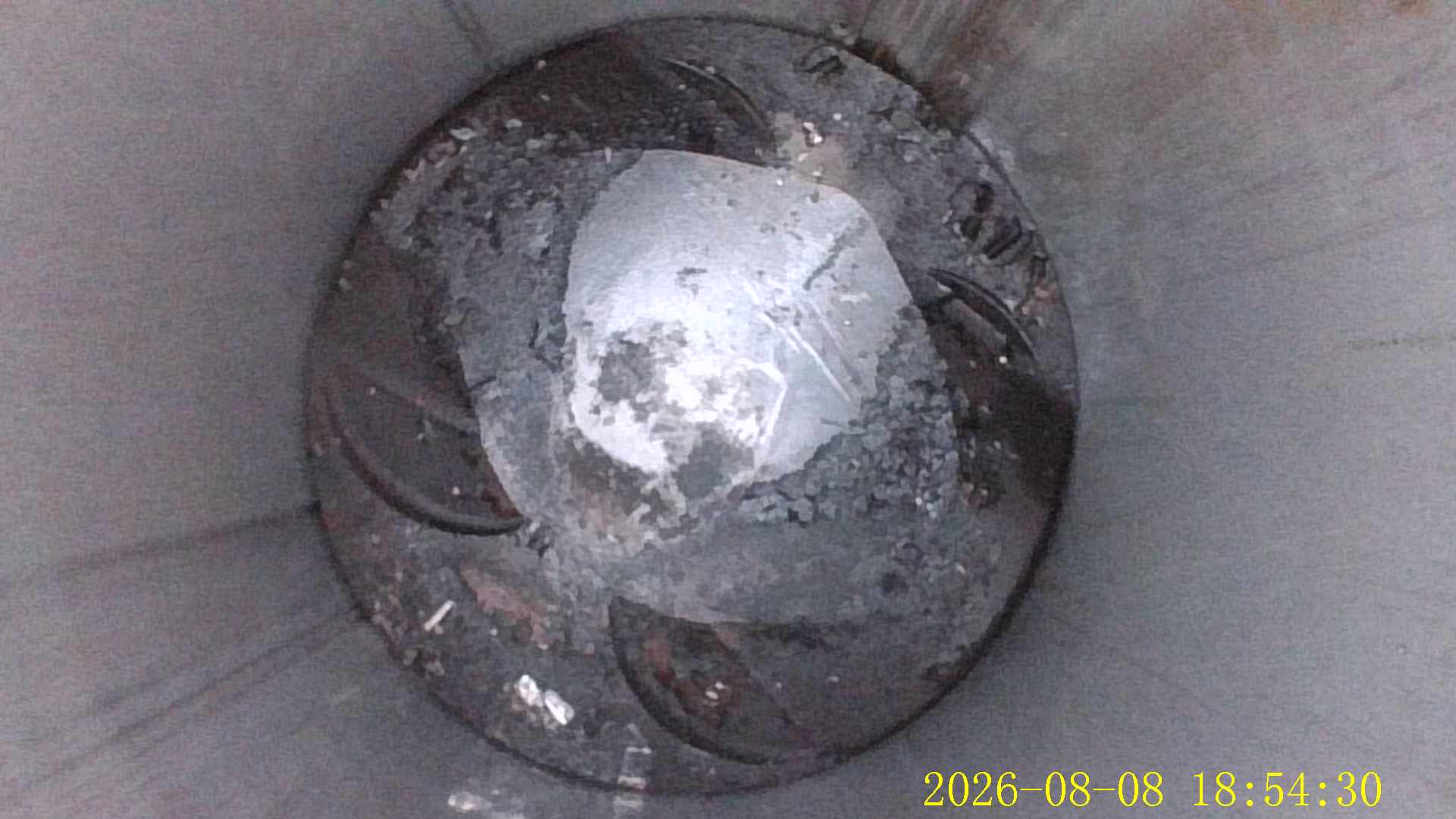

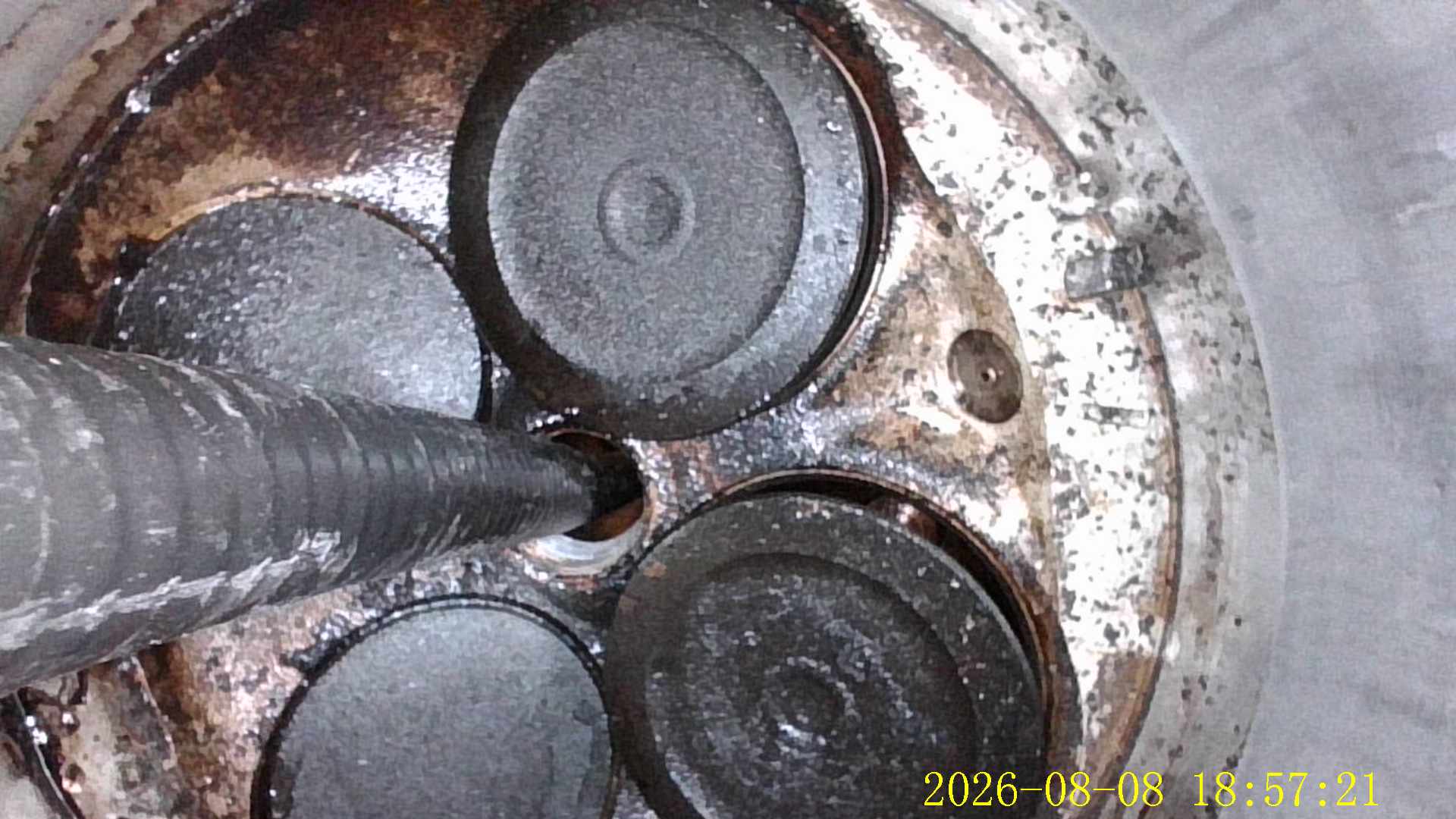

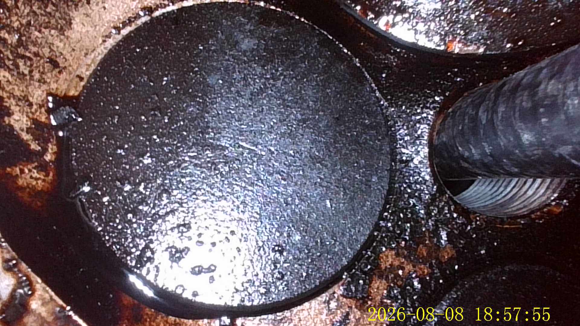

Picked up a borescope to confirm
IMG_0001 IMG_0003
CYL 3 for comparison
IMG_0006
Not sure how something like this could have happened
Ouch, Is intake manifold intact? Maybe a flap went down the cylinder?
Can you get us a few more pix of the bad cylinder. What cylinder was it? From the look in the pix looks like possible ring failure. Overall kinda had to tell tho.

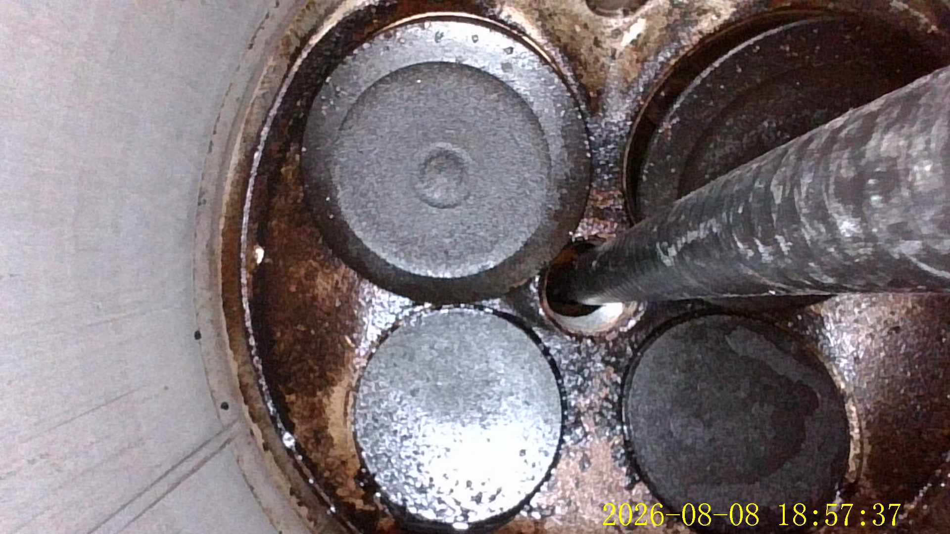

Here are several more. Almost look like it is splitting around the diameter at the top of the head near the valves like head gasket failure, but Block Tester fluid stayed blue… This is cylinder 4
IMG_0007 IMG_0008 IMG_0009 IMG_0010 IMG_0011 IMG_0012 IMG_0013 IMG_0014 IMG_0015 IMG_0016 IMG_0017 IMG_0018 IMG_0019
