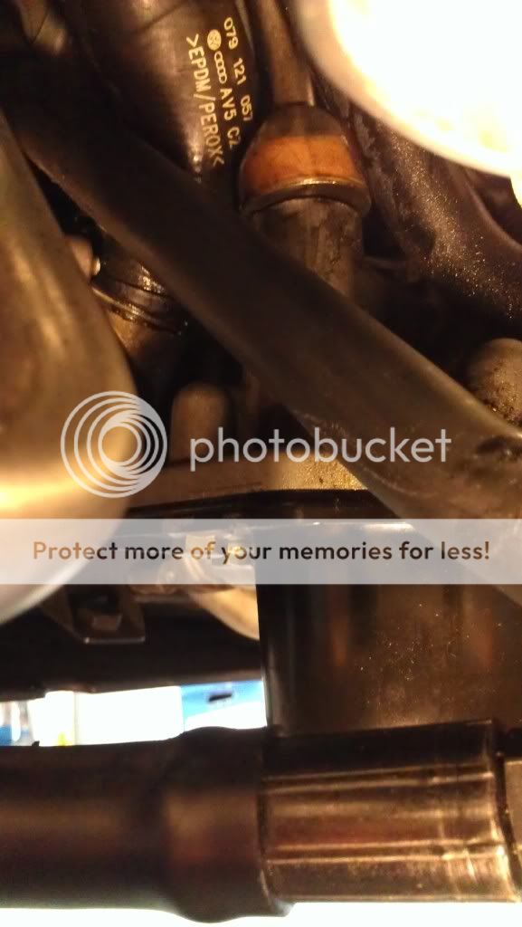

Changed my oil today by way of my Pela Oil Extractor as I have done many many times without issue. Today for some reason, the suction tube got wedged in the dipstick tube so hard that I had to literally use all my strength to pull it out. Got it out and finished the oil change and then started her up to take her for a spin. Immediately I noticed something wrong. When the car started, the cold start idle was higher than normal and then it started having a fluctuating idle, (up/down) before finally settling at about 800 as it should. I didn’t think too much of it until I was driving and noticed a small lack of power and the throttle response was definitely not as sharp. Anyway, got her back home and noticed a pool of oil in the garage and the car was now smoking. Looked under the car and noticed oil dripping from the belly pan…Great!!!
Threw her up on jack stands, ripped off the pan and started looking around. I couldn’t really tell where the oil was coming from until I remembered my little incident with the suction tube getting stuck. I followed the dipstick tube to the oil pan under the car and low and behold I see that the tube has almost completely pulled out of its insertion point on the oil pan. Obviously from my pulling on the suction tube, I almost completely ripped the sucker right out of there. This explains the oil leak as well as the strange idle since I’m sure that created some sort of a vacuum leak.
Anyway, here’s a pic of the tube (top center of the picture) properly seated and cleaned up once I got it back in place. So far so good, no leak and the car now runs perfect again. What a scare and a mess. Moral of the story, if you use a Pela and get your suction tube stuck (lol)…don’t try to pull too hard to get it out.

good to see you figured it out, having a leak in the crankcase is an interesting situation. You may have had a vac leak all the way through the crankcase, through the PCV system into the inlet tube.
Thanks man. I wish that was the case. I did the oil change early this morning before I had even driven the car so everything was cool.

Im I understanding this correctly that the tube got cought in the pan and not in the oil dip stick tube.

So here’s my experience with this process. When you put the suction tube into the dip stick, it gets to a point where it stops. At that point, it will pull oil for a while and then stop. If you’re watching the level mark on the Pela, you know there’s a lot more oil in there, so I wiggle the suction tube around to pass by whatever that obstruction is (I assume it just moving into the oil pan) and continue sucking. This is where it became stuck for the first time ever. I’ve done the oil changes when the oil was hot and the tube never got stuck, so maybe the tube being cold and not as flexible was the cause.
