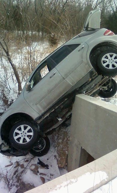

Make sure you don’t get yourself in the 0.01% where it doesn’t work well, and you’ll be fine. If you had both front wheels on the ground it would be fine. Both rear would be fine. One wheel off, fine. One wheel of each axle off, the open differential screws the pooch and you go nowhere, like a broken half shaft.
The key for your wheels to drive the car is to keep them on the ground.
bad
http://pictures.topspeed.com/IMG/crop/201001/road-accident-result_600x0w.jpg
bad
http://kwtv.images.worldnow.com/images/13999747_BG1.jpg
