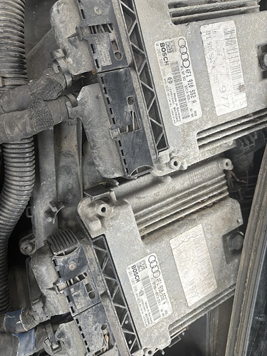

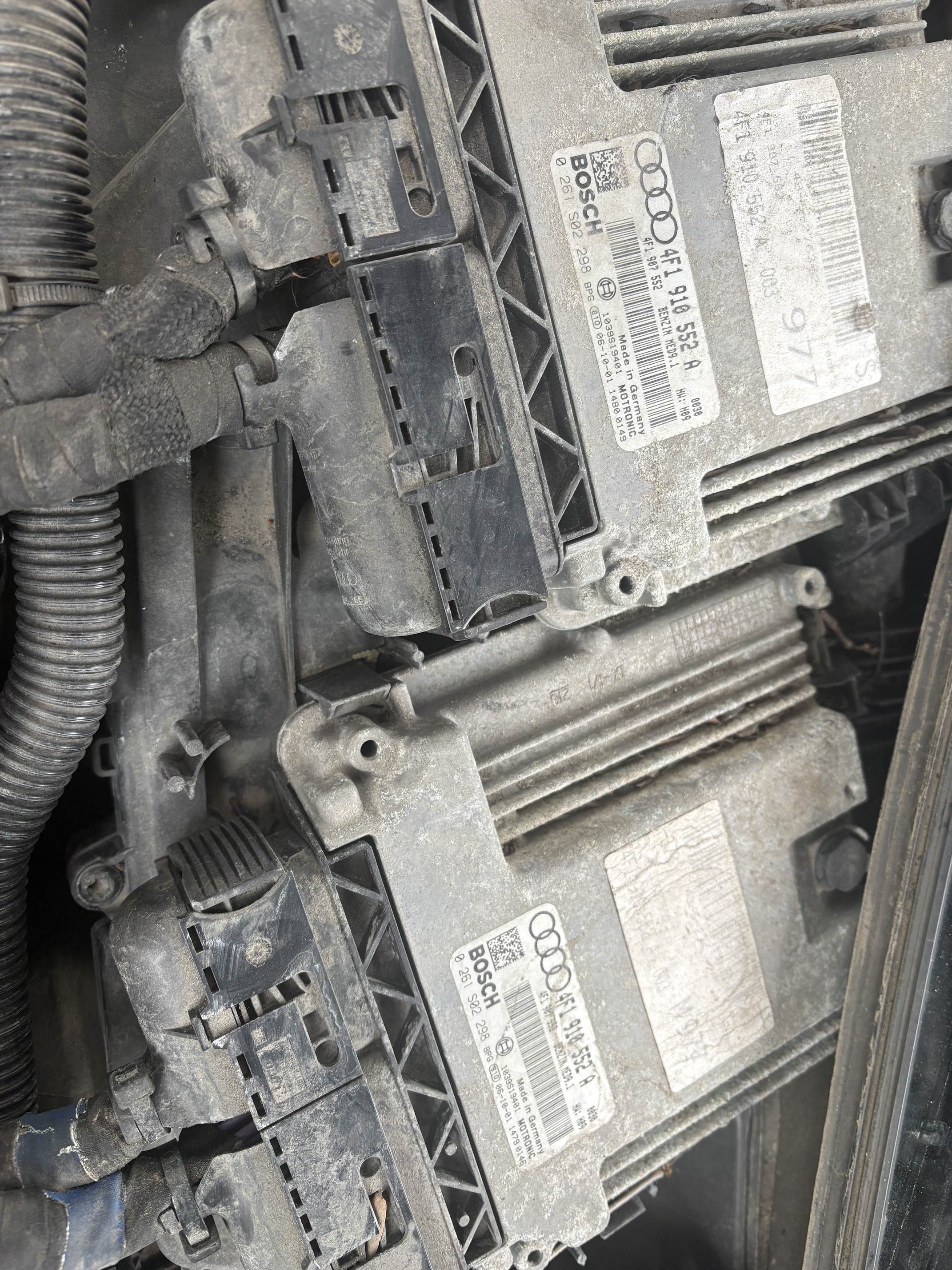

And in the ECM 1 faults, theres the ECM 2 implausible signal. Is it safe to assume the ECM2 would be the faulty one?
If so, which one of two is the ECM 2? Left or right?
SO from what I remember - The far left is 1 and in bottom one is 2… BUT the S8 and S6 I think might have it swapped.
What you can do is look on the bosh label. There’s going to be a number on the tag. It’s an actual number your number for the top one looks like 149 and the bottom looks like it’s 148 or 146… From what I remember that makes the lower ECU 1 and the upper far left ECU 2.
You can obviously unplug them 1 at a time and then try to log in with your vag com and see what one can’t be found.
