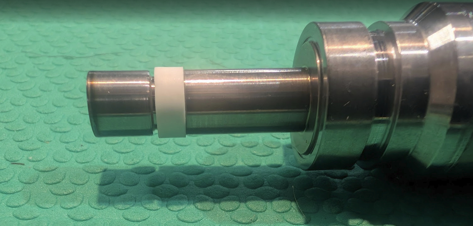

So I just had my injectors cleaned/rebuilt (one was stuck open and apparently the rest were in very poor shape, the guy that rebuilt them for me put on new seals etc but I want to tighten up the teflon seal. I bought a kit on amazon that lists a bunch of engines but not the 5.2 (thought it might still work) but the die to compress the teflon seal is very tight and I can’t slide it all the way through. How tight should these be? I realize that they hold the compression in the cylinder so I don’t want to have to remove the intake again. It’s obviously on there but I can still spin the seal with my fingers. If won’t work does anyone know what size I need to compress this properly? I can’t seem to find one for the 5.2 s6 engine only the s8 and the 4.2’s. Any help would be appreciated.

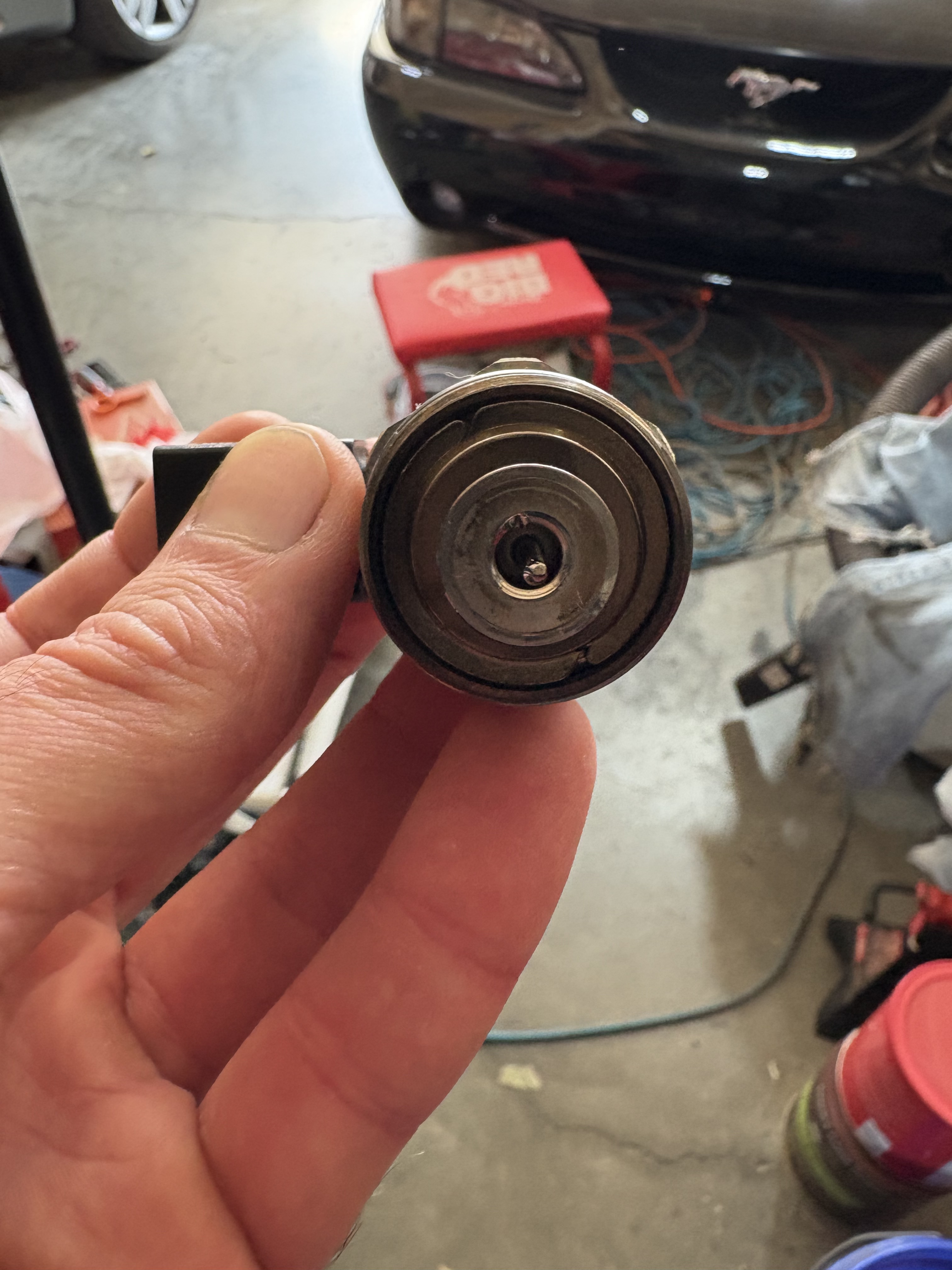

So going to be tough to really say without seeing it or the tool you used but I can say I have a Hitachi injector that came sealed and it does spin. Here is a close up picture of the seal as well.

The guy that cleaned and serviced my injectors put the seals on, he seemed to be pretty knowledgeable so I don’t think he used crappy ones the tool I bought was from amazon. I ended up using the only sizer that fit and got them as snug as I could with it. Hopefully it holds, I really don’t want to pull this intake off again
Outside of taking it back to that guy or getting a second opinion from someone else redoing the job is an unfortunate possible reality. The good news is once you get that intake off a few times it really isn’t a bad job. I remember being in your shoes and feeling the same and I’ve removed it about 6 or 7 times now since I bought the car. Initially it took me almost a whole weekend. I can now do it in about an hour or so.

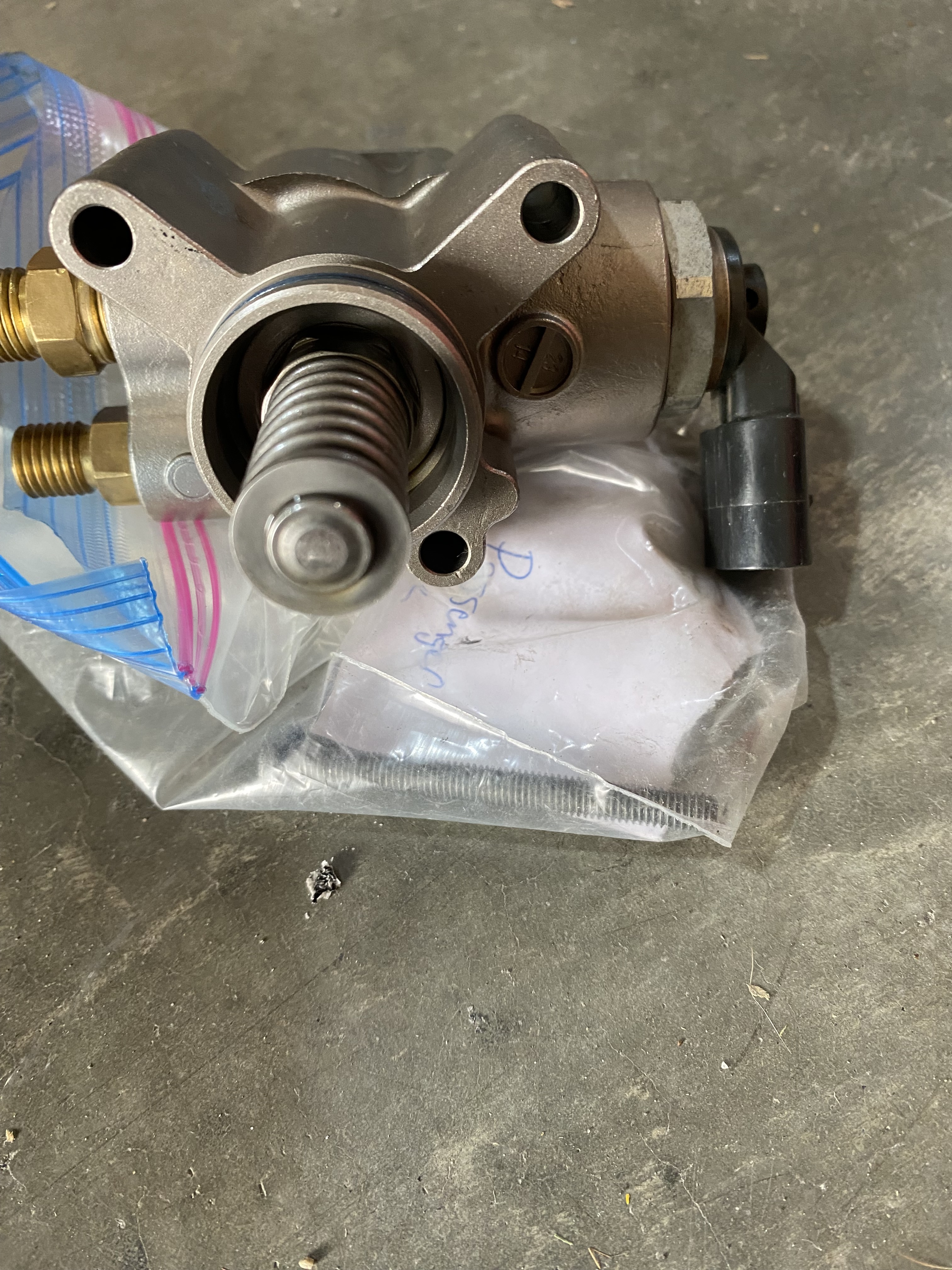

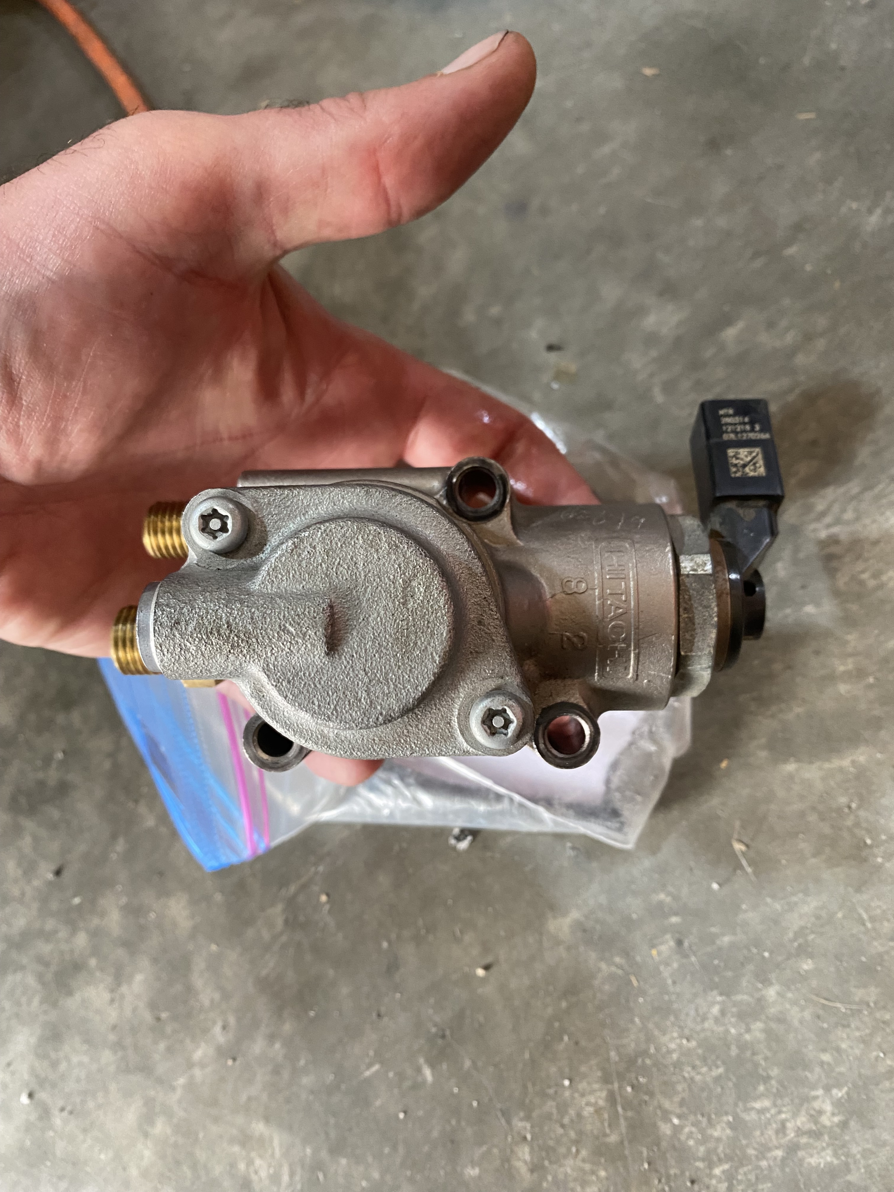

Both pumps and followers look physically fine, no extra wear or anything. The cam looks ok as well. I’ll have to try some data logging I guess to see what comes up.

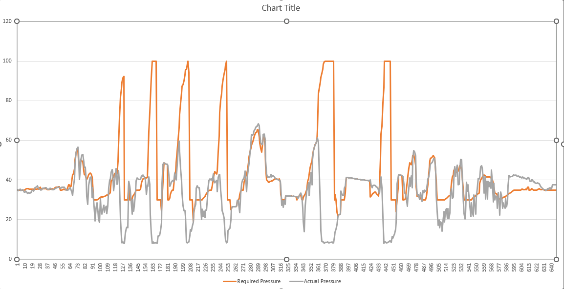

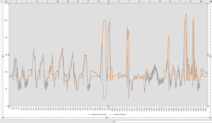

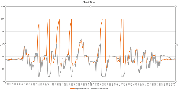

I did some data logging on it, the low pressure side is fine everywhere. It stays around 6-6.5 bar regardless of how hard I push it, so it seems like my in tank pump is ok. The high pressure side is fine at regular speeds, but when I push it, it will often drop right off but not always. There were a few times when the recommended pressure was 100 bar and it dropped right down to 8-10. But other times it would match the required pressure. It seems like when I floor it, it just can’t keep up. Are my high pressure pumps cooked? Or is there anything else that could cause this? I am going to try to graph it but I don’t have excel on my garage computer just excel viewer. Anyways anyone have any ideas?

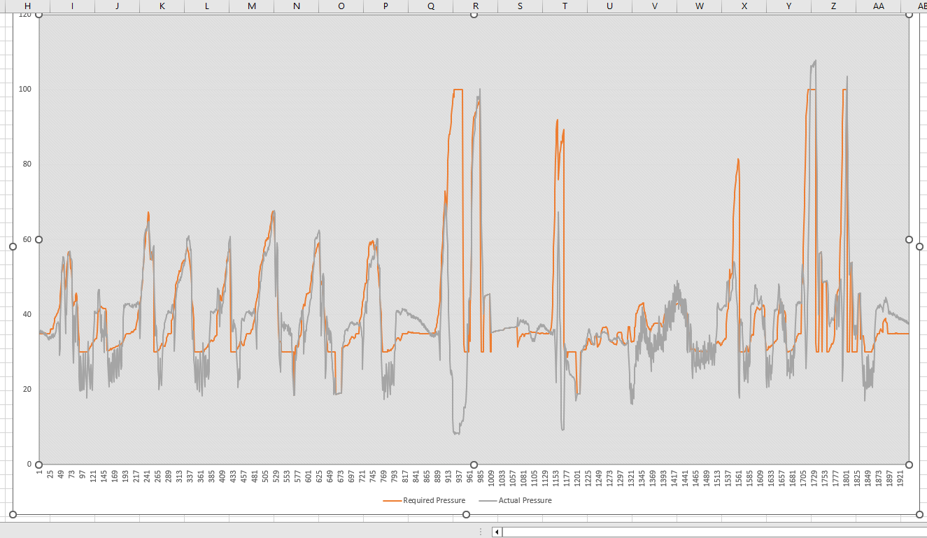

here are the charts, you can see on this one it got up to over 100 bar a few times but was far to low others. I think that was from accelerating slower though
This time I just punched it a few times to see how it reacted and it was very low the majority of the time

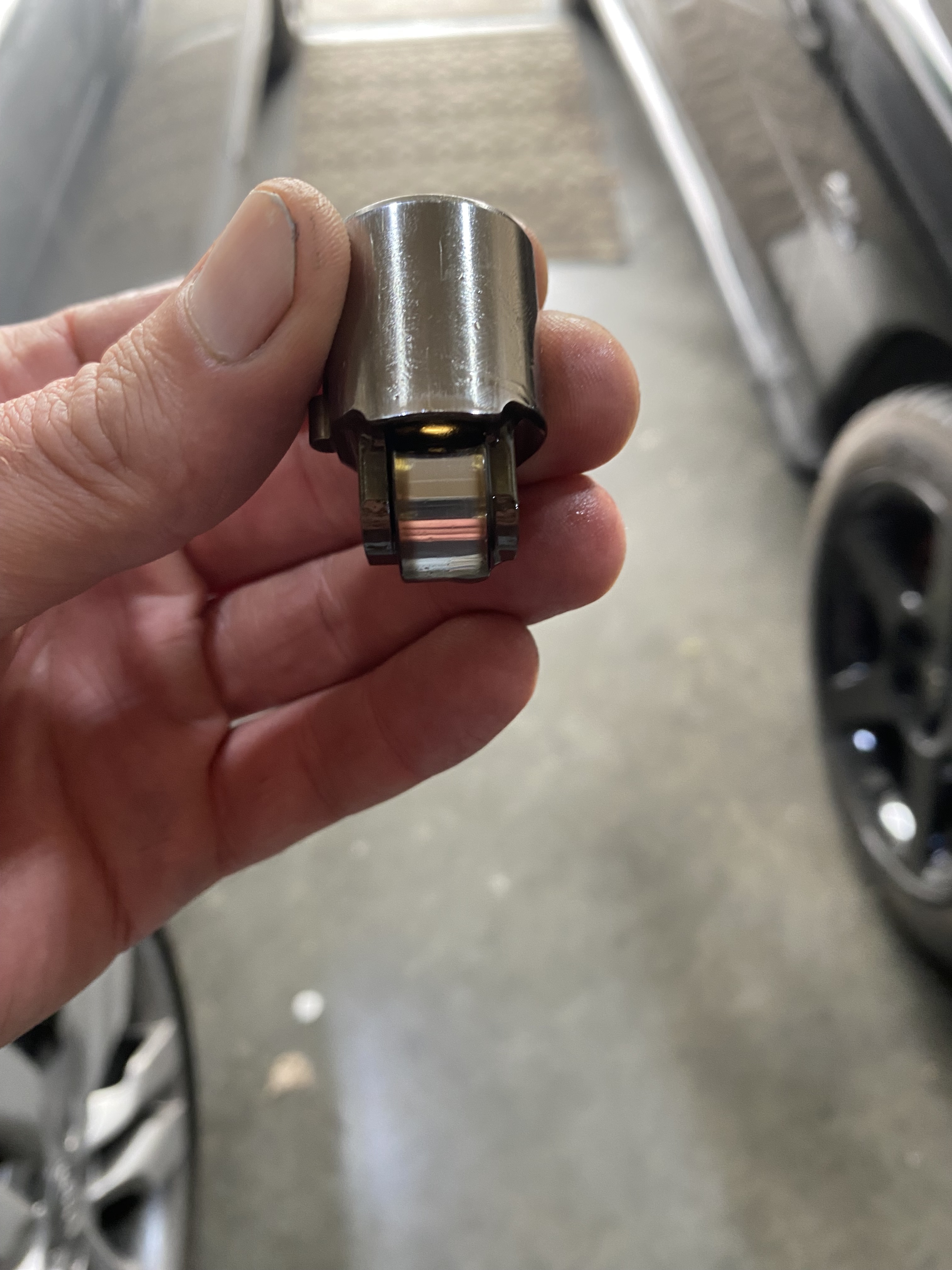

Seems like the site has been down for a few days but I was able to figure it, it was one of the solenoids on my high pressure fuel pumps. The little plunger inside was bent
Luckily I had a couple of extras around to replace it, works like a champ now. Side note also added in a jhm ecu and tcu tune after I got everything sorted, man that tune is worth the money, it pulls so much harder with it, even with my limited modifications (spacers, catback and lightweight crank pulley)
