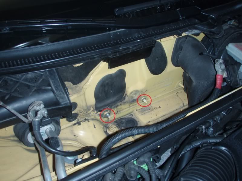

I dont have a full DIY to remove the battery. I just took pics on how to get an optima to fit in properly. First thing you will need is a 14mm key to remove the plastic backet on which the battery sits. Once its off i put 2 10mm washers on each bolt (total 4 washers) to push the entire bracket towards the clamp… since the clamp cant be re-located.
http://i140.photobucket.com/albums/r17/xbora_vr6x/2boltswithwasherson-Copy.jpg
Once you have your washers on put the bracket back on. Once its on you can see the nut is not quite flush with the bolt… but i feel i got enough threads on for it to be properly secure.
