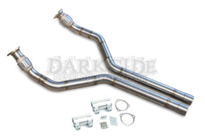

I’ve found darkside developments have some that fit straight on.
JHM sell downpipes only (incl X pipe) for RS5 not sure if they fit RS4 but seems likely ?
Also the JHM and Milltek are the 2.75” to match the Cats unlike the Darkside which are only 2.5”

So am I correct the miltek in the link I posted before darkside would fit.
Yes the RS5 is the same.

So no the milltek won’t necessarily fit because they haven’t manufactured the downpipes to line up with the rear ‘half’ of the OEM system, whereas JHM have specifically manufactured their downpipes to be installed on their own OR as part of their whole system.
I’m still not 100% certain the fitment Is the same on the RS4 and RS5 although the darkside product would indicate it is ? JHM or @Ape_Factory could probably advise
I’m of the opinion the system will work for both the RS4 and RS5 as there are no exhausts specifically for the RS4 and it isn’t any longer than the RS5.
