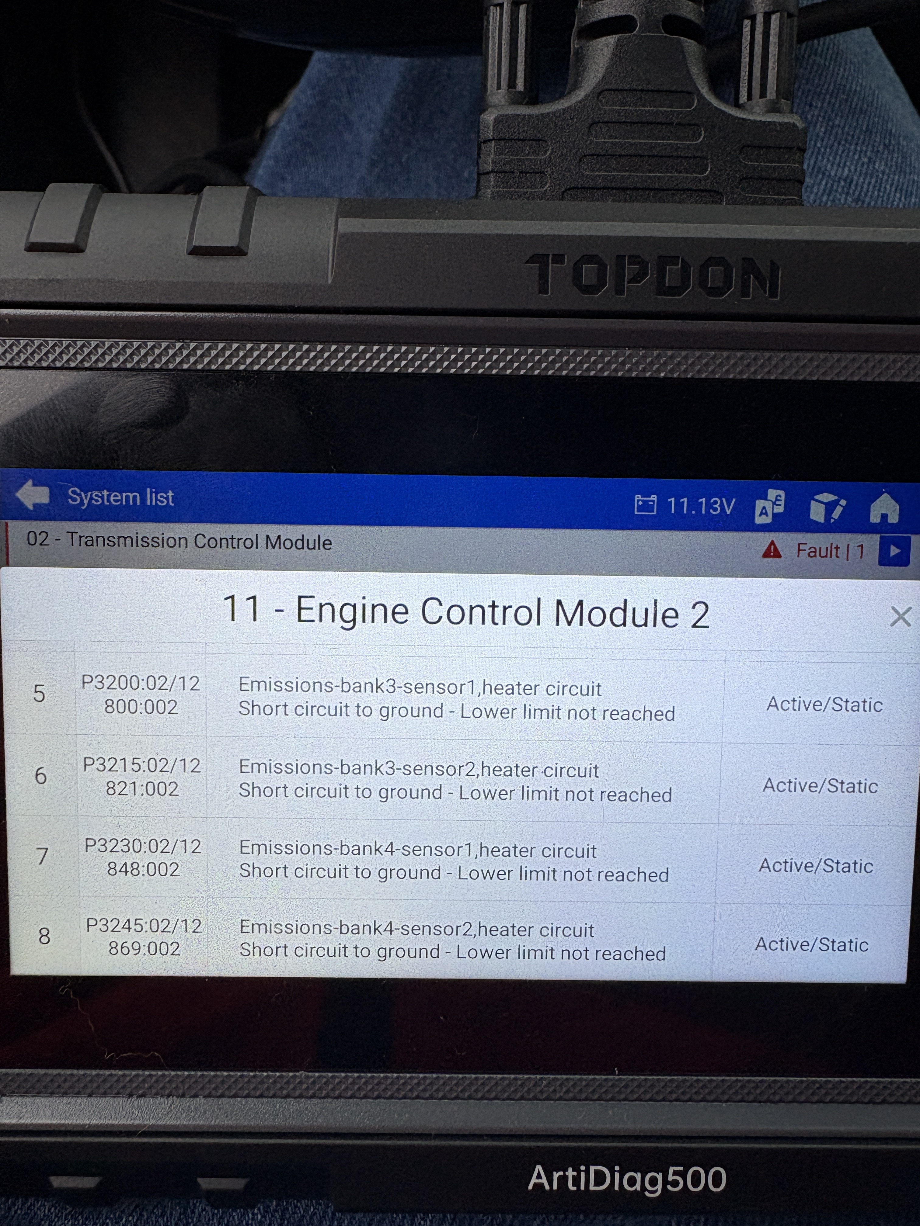

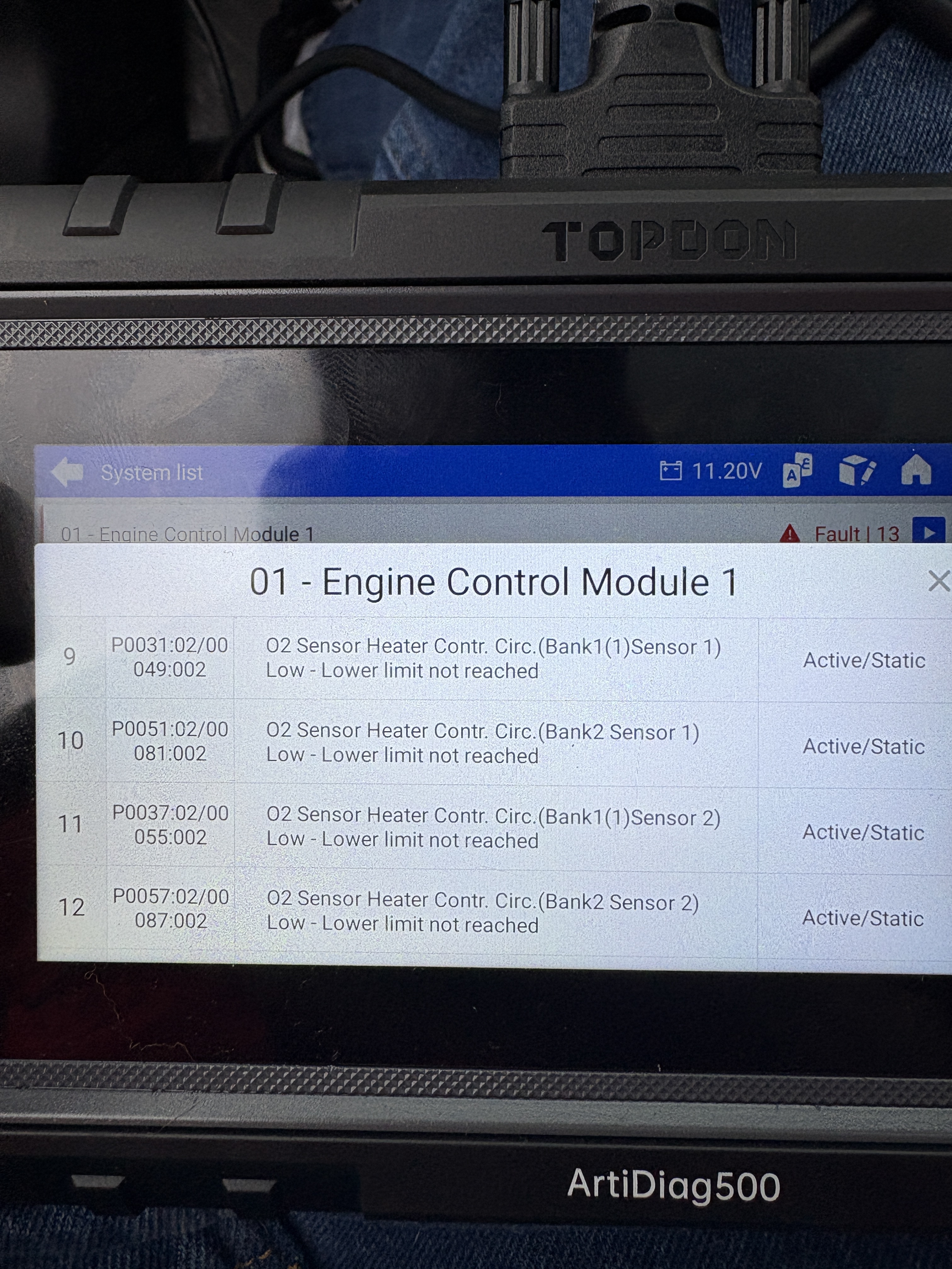

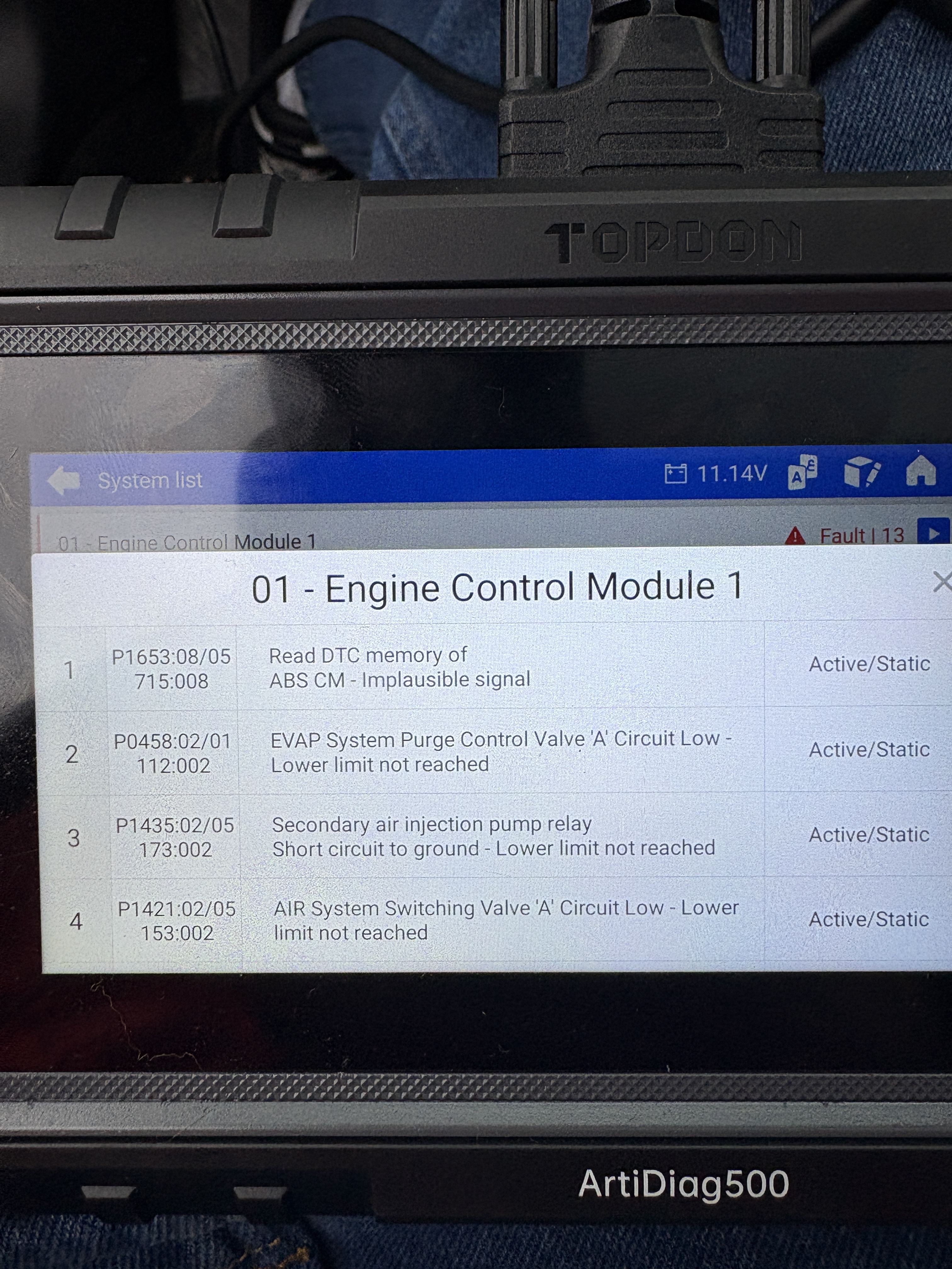

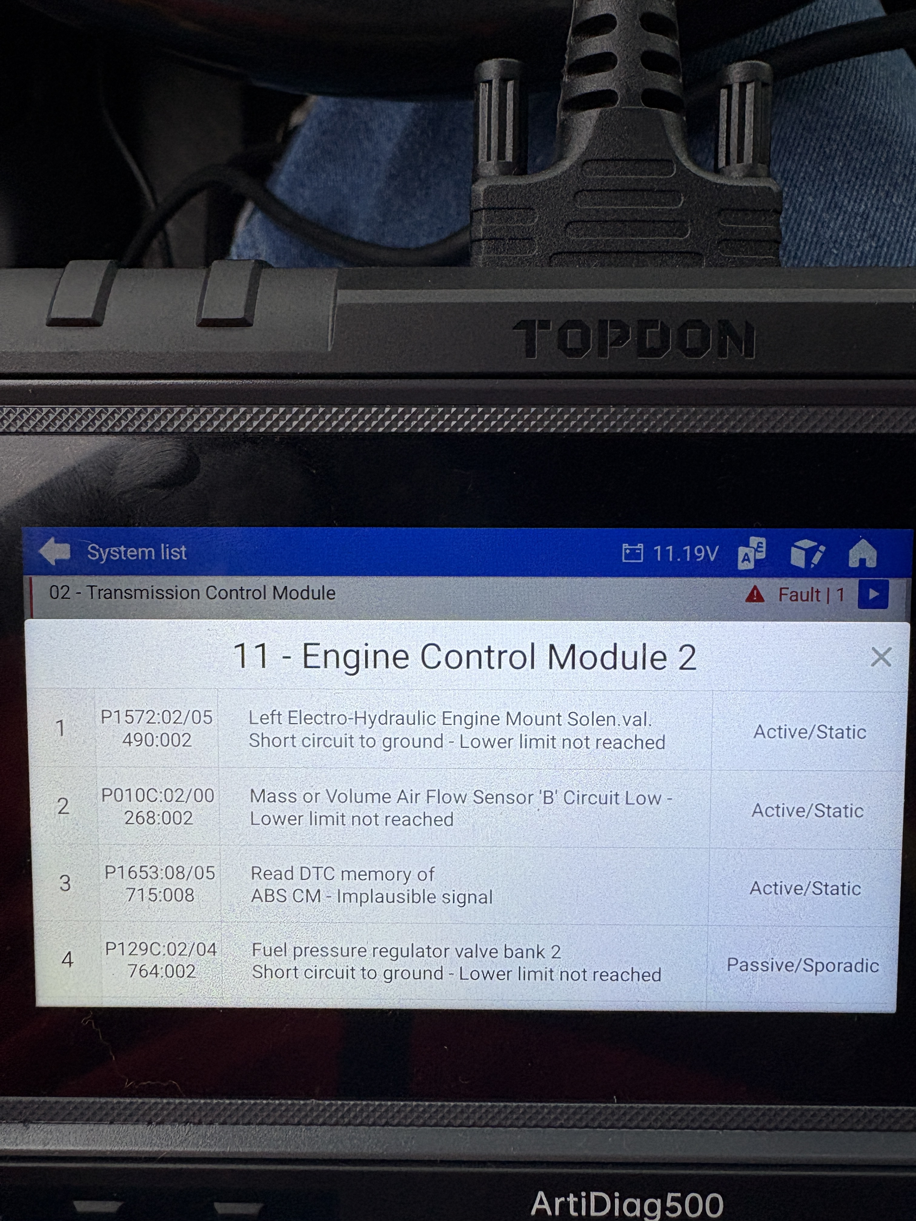

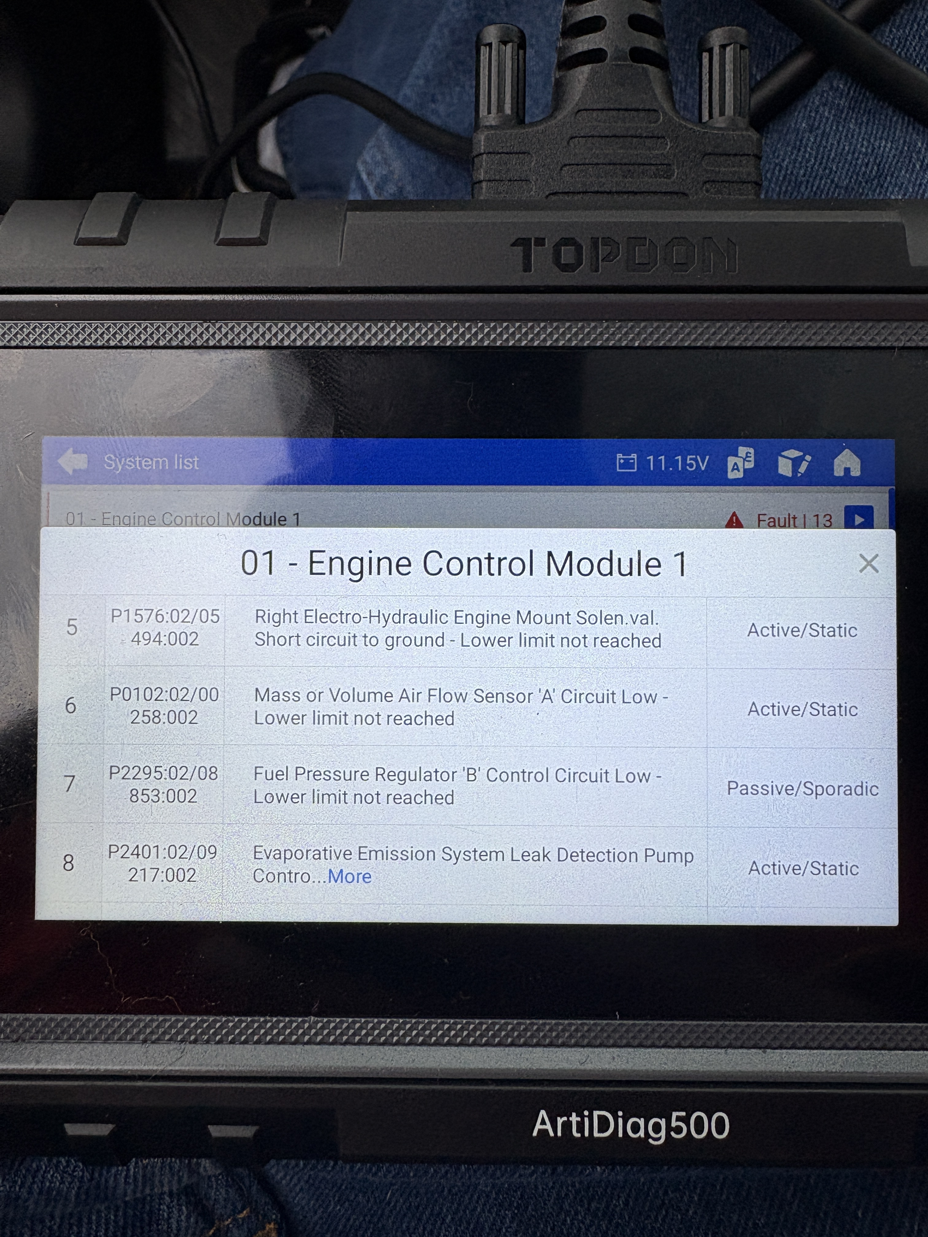

I’ve been doing all the mecanical reparations myself, but now it seems that I’m having electrical issues, atleast thats what I think, and it is completely outside of my knowledge.
I have many codes, shown in the pictures, EPC light, ESP fault, meaning the car is in slow mode IF it starts. There is, sometimes, and during longer drives, a white smoke coming out close to the firewall in the passenger side engine bay that doesnt really smell like burnt oil or coolant (burning wires? short?) (valve cover gaskets changed 3-400 kilometres ago and no visible leaks). I possibly have a problem with my fuel system, which MIGHT be the cause of the fuel pressure regulator codes, but they appeared at the same time as all the other codes, and the car drove pretty much perfectly before.

Would you be able to do a VCDS scan, or a scan with some other tool which will show freeze frame data?
Also, check your fuel pressure readings. From the codes you are getting i’d say stalling might be related to the fuel pressure fault, or the maf sensor fault.
There are many error codes. Lets work backwards. How long have you had these error codes? The MAFs on both sides have issues. The MAF errors give you the ESP and TC faults. There has to be something electronic going on. As that many error codes on both sides of the motor are not very likely.
