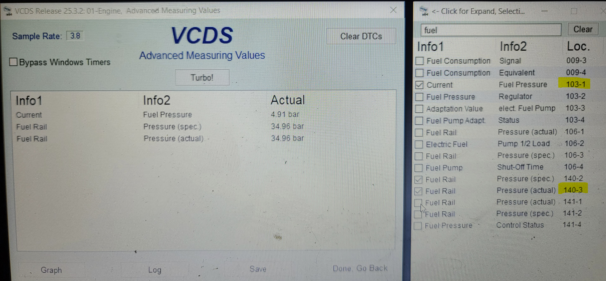

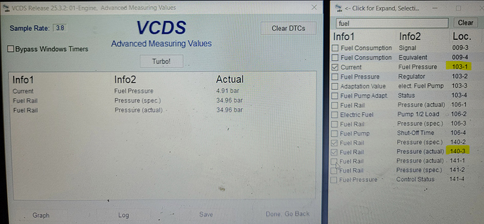

I guess my biggest question is, is there anything I could be testing to see if that in tank fuel pump is failing.
You can use a fuel pressure gauge, which you would need to plug anywhere before HPFPs. Fuel lines come into the engine bay through the right wheel well. You can check if fuel line isn’t damaged in that area, as that might give fuel odor in engine compartment area.
LPFP = MB 103-1
HPFP = MB 140-3

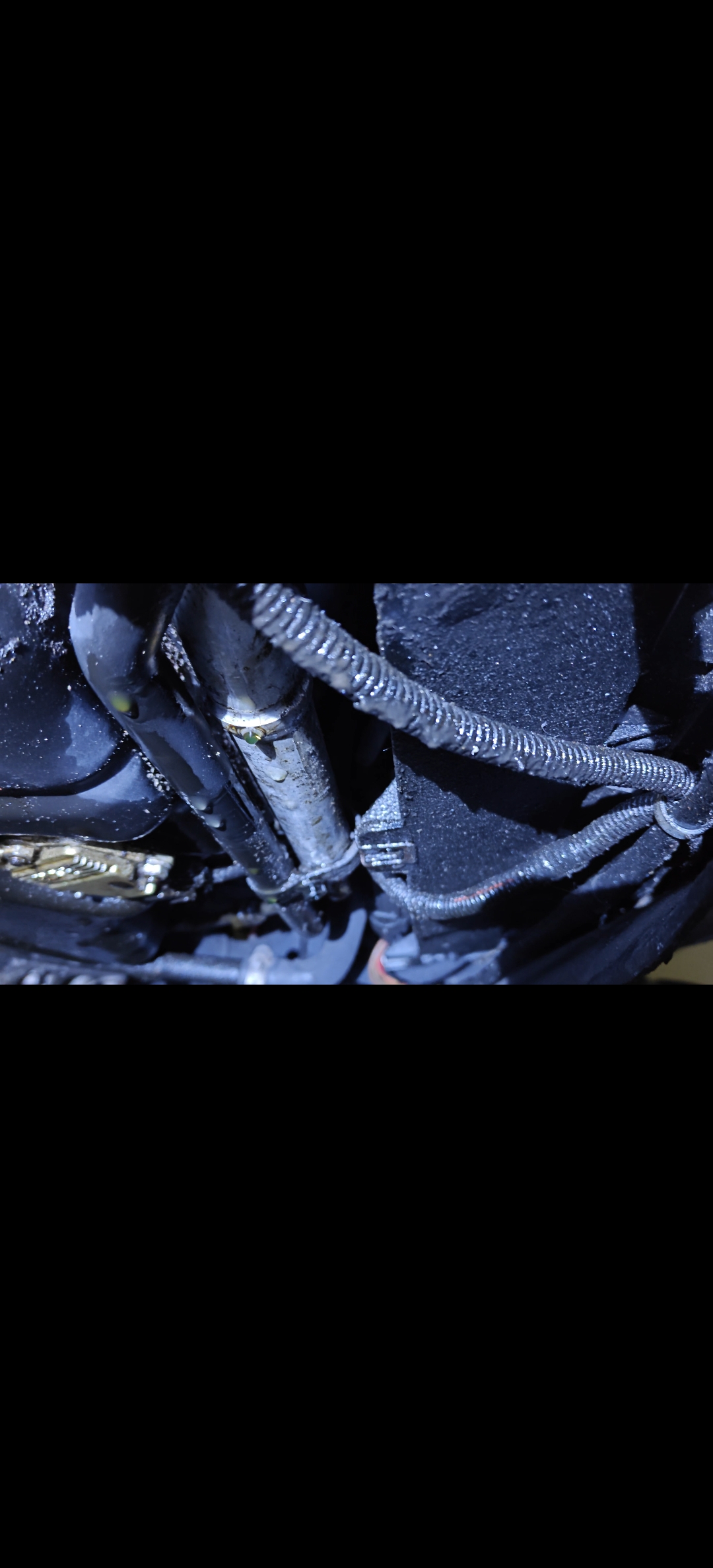

I did end up replacing the LPFP, noticable difference in the priming speed and also sound. This actually led to the small leak that I was getting to become more prominent and started dripping much quicker. The car wants to fire now but obviously is leaking enough fuel to keep it from starting. So now I need to track down this fuel leak. I’ll get the car up in the air with bumper off later this week but here is where I am finding fuel dripping from the front underside of the motor in front of the oil pan. There is also a “squeek” sort of noise after priming the fuel system coming from the back side of the intake that slowly goes away over about 60 seconds, assuming it’s just when there isn’t enough pressure to cause that noise anymore. Any help or advice would be appreciated.
