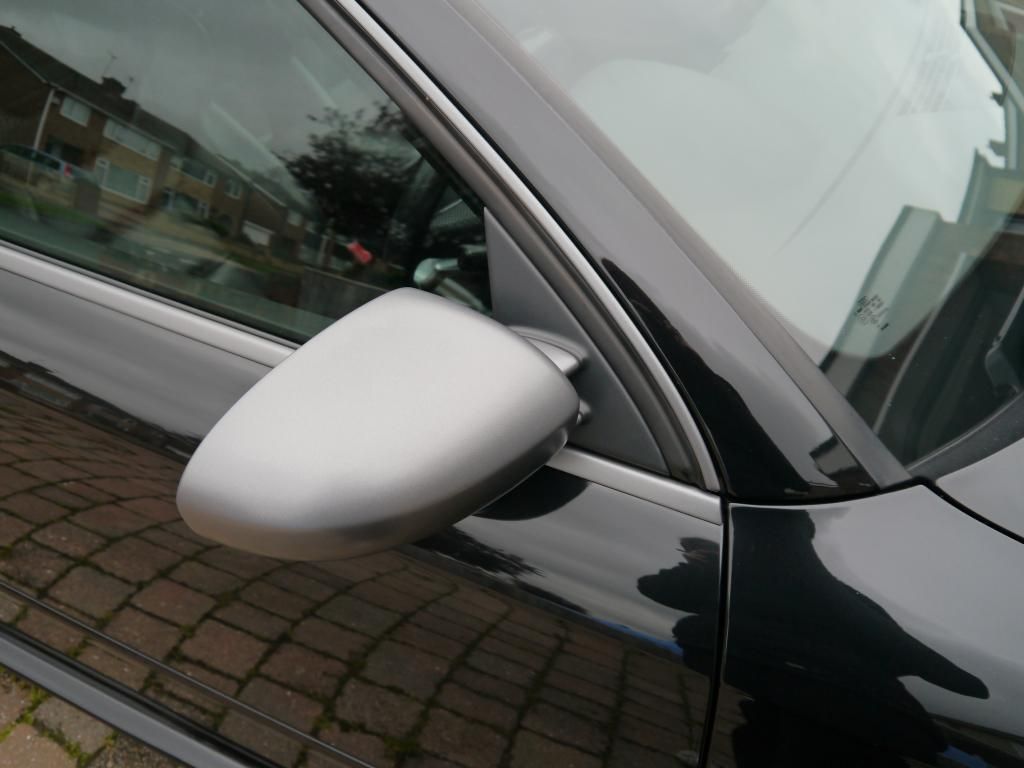

with the wrap off i decided to paint all my trims the titanium wheel and mirror colour.
i removed all the trim from the car and carefully flatted every thing off then etch primed, colour and satin laquer.
also did the wheels and mirrors to match.

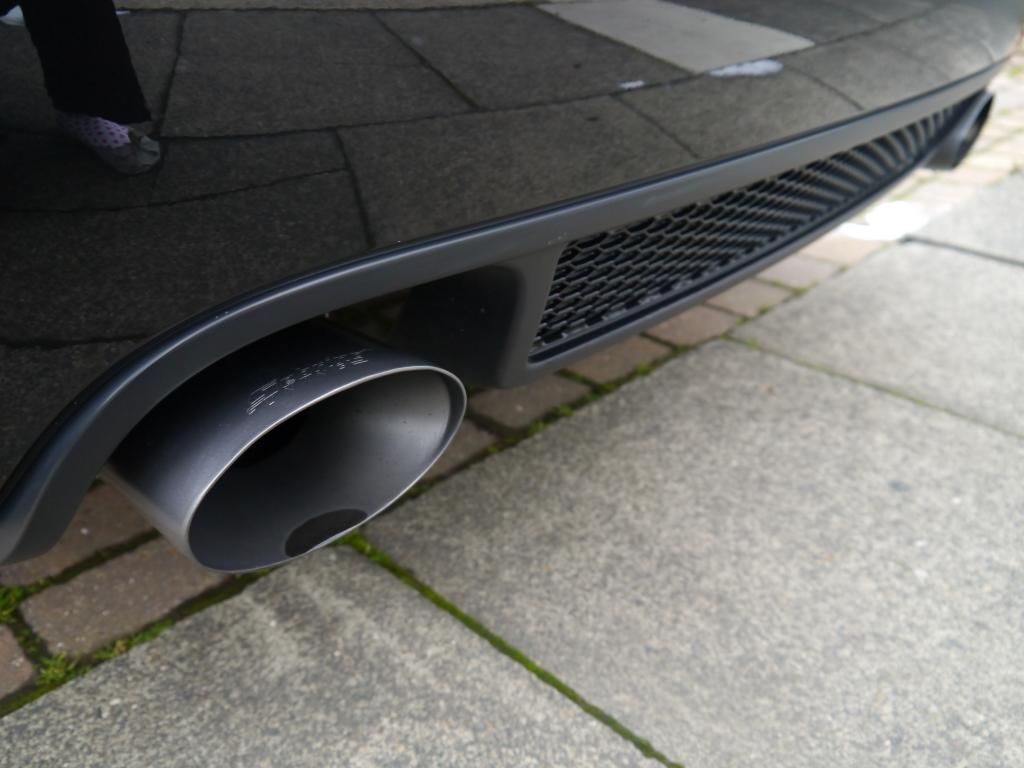

also painted the tips of my jhm exhaust.

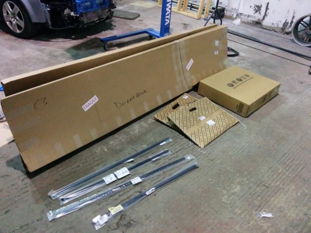

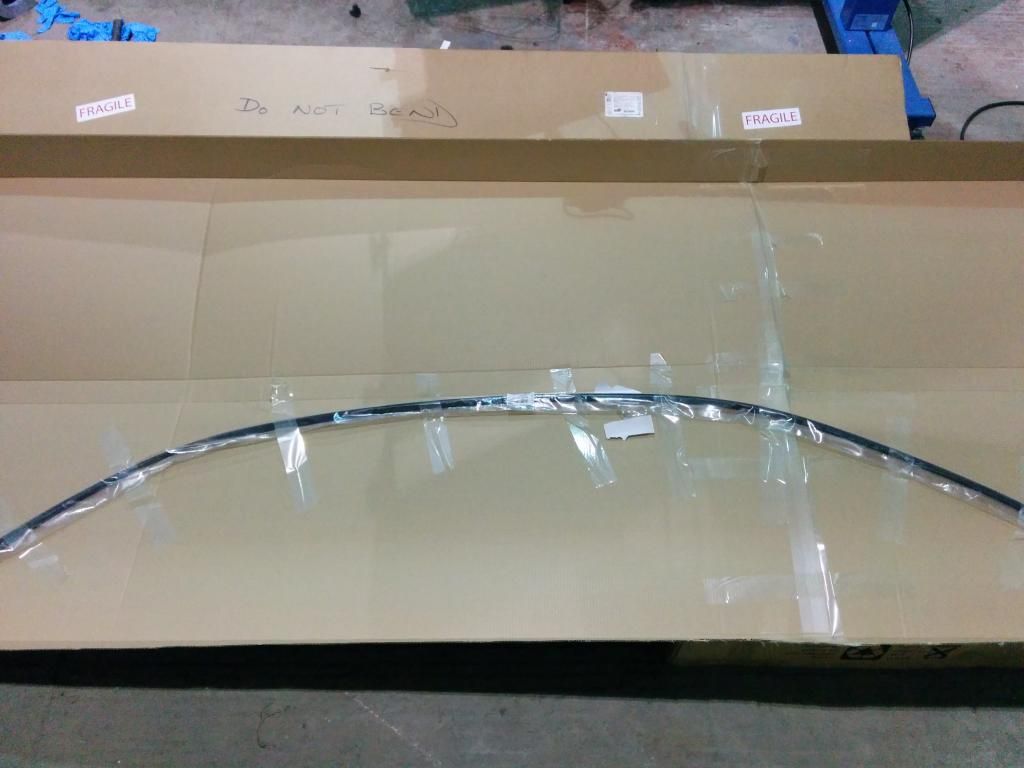

if you have ali trim and want to swap it for new ali trim then you can just remove the outer metal part of the door trim leaving the plastic/rubber part behind and just clip in the new ali trim.
same goes for the rear quarter window trim, old one clips out and the new one clips in.

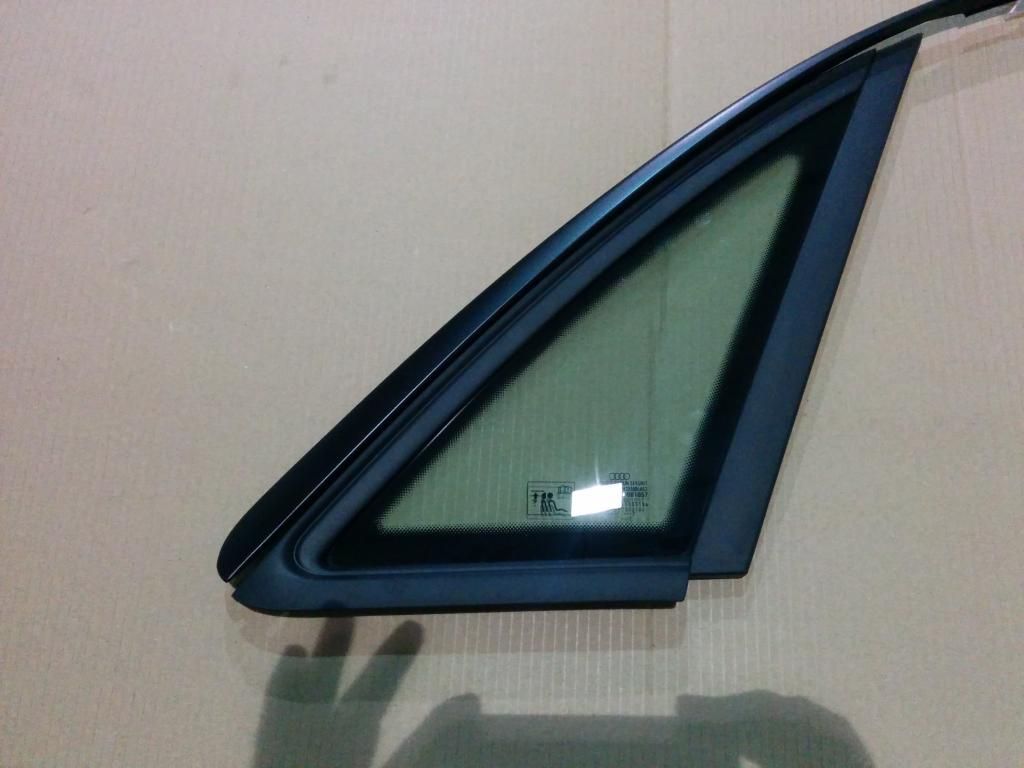

the hard work starts if you want to go ali to black optics. the black optics door trims are one piece so you have to remove both parts of the ali trim, which means stripping the doors and removing the window frame to get to the clips.
also the rear quarter window is different with the black optics trim, it has half the trim built into the window rubber and the roof trim is longer to finish it off.

the paint held up fine, just a few small chips to the front grill surround.
that’s some pretty fancy foot wear u got goin on there in the exhaust tip pics lol. thanks again for your help with my mirrors.
