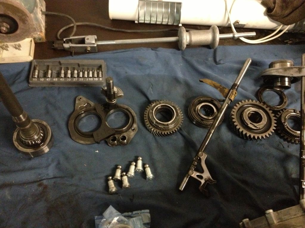

Make sure you change all c clips inside the tranny
Have you rebuilt one of these before? If so, good to know…
This should help you out Saki.
Here the rest of the internals !lol
Awesome Jnaut, good luck!!
After rebuilding my heads tackling a transmission rebuild doesn’t seem too overwhelming. I have no issues to speak of with the tranny “knock on wood” but I would also really like that 6th gear that bango mentioned.
that is George (white M3, formerly misano red RS4) and he had to do a bunch of work on his RS4 transmission
My RS4 had the same problem with third gear synchro. Chris from twins autoworks and I replaced third and fourth gear synchs and third gear. Car drove like a dream for 3000kms and then couldn’t shift into any gears ne night. We took it apart again and found the c clip on the input shaft had come out of its groove. We did not know that these were not reusable.
To keep a long story short i had to replace the synchs and gear for the second time because of a $5 clip
