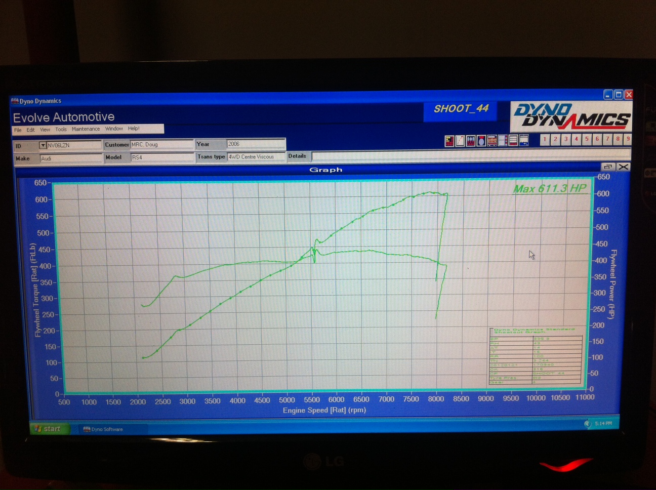

Regarding the TTS Rotrex supercharger kit. Some corrections need making.
- TTS use the C38-91 NOT the 81. The 91 makes 0.63 kg/s or 1853 m3/hr which is far more than any other system currently.
http://www.rotrex-deutschland.de/images/stories/pdf/Rotrex_Technical_Datasheet_C38_Range_V5.0.pdf - GOD states that the Rotrex is running to 140,000 rpm but its not its running to 90,000rpm and has different pulleys on the S5 to the RS4 to ensure its not overspeeding for either rev limit, so the efficiency remains high.

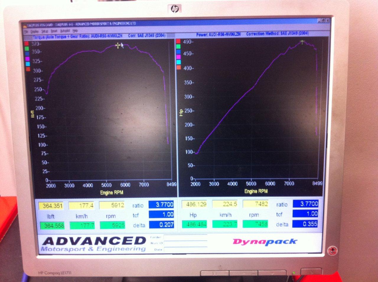

- The MRC RS4 has run on several different dyno’s and always runs over 600 bhp crank and Dyno Pak’d at 480+ hub. Go on RS246 forum to check out their figures.
- The Rotrex kit comes with fuel pump mods (the only kit that does) to give the fuel required to make 600+ bhp. which says it all.
the fact that one guy with a PES M90 kit and another with a M112 and w/m and NOS have both junked their kits in favour of the TTS kit and quote ‘the difference is night and day’ may give some credance to performace gains.
When the weather turns i’m sure there will be 1/4 mile video’s to prove a point, until then those who think dragracing is king will have to wait.
hey horsepower, thanks for posting. You’re the TTS dude right? In any event, welcome and thanks for the information. THe compressor map for that blower looks pretty awesome. HOpefully you guys are able to get lots out of it.
So the one dyno that we’d be familiar with showed 480 hub-dyno horsepower? Traditionally hub dynos are about 2-5% higher reading than wheel dynos like the mustang, so I guess we could assume the kit would be anywhere from 460-470 whp. That’s awesome power. It has been theorised that the RS4 can handle a bit more than that. Will be interesting to see how it shakes out.

My S5 has gone from 232 ro 486 hub hp on the same Dyna pak and he stopped the run at 6500rpm. http://www.youtube.com/watch?v=xpXSdrPTWQ4
