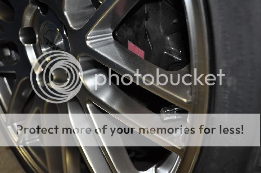

From an overall offset point of view, this is the equivalent of a 15.35 mm offset difference, or about 2/3 of an inch. So I figured…10mm spacers and it might work? Well, I didn’t even get a chance to test the offset…the barrel of the wheel itself wouldn’t even get around the calipers. So…back to the drawing board.
You can see the corner of the caliper (directly below the u in the watermark)where the wheel was nicking it…

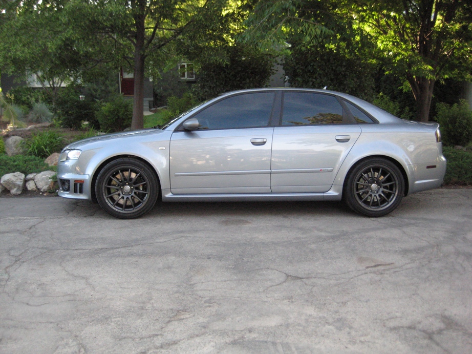

Man 18s looks REALLY small on this car…
http://audirevolution.net/addons/albums/images/283489906.jpg
Looks like I’m going to have to stick with 19s…so I’m on the lookout. Preferably another set of stockers as I think they just look perfect. Ti package would be great in case you know someone selling. Still need to do a proper photoshoot with this thing. These are all blackberry pics.
