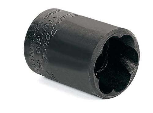

To get the transmission pan off and back on easily then the exhaust needs to be taken off. There are like Y sections that get in the way of the transmission pan bolts. Usually the nuts that hold the exhaust on are rusted and like to round by this point so I had to use a twist socket to get them off. After I replaced all the nuts with new ones and used a healthy dose of anti-seize.
The twist socket that I used looks like this:
http://public.snapon.com/R_RRD/Objects_lg/images/TTWY281A.jpg
I was afraid of that, those front connections don’t look like any fun…I should have soaked them in PB when I was under the car…were those 12mm?
