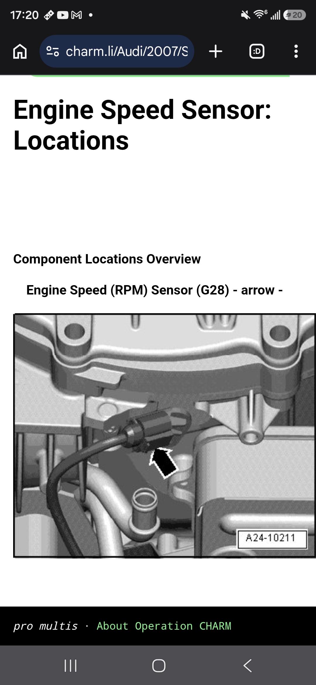

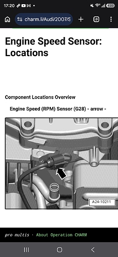

And does anybody have the precise location of the sensor? I cant find it online or on charm.li
yeah I saw that but it didnt really help when its so zoomed in and no general description of where it is. I asked AI and it gave me much better help. It ended up being right under the engine and I can see it if I crouch and look under. Seeing the 4.2L location mislead me to think it was accessible from above.
