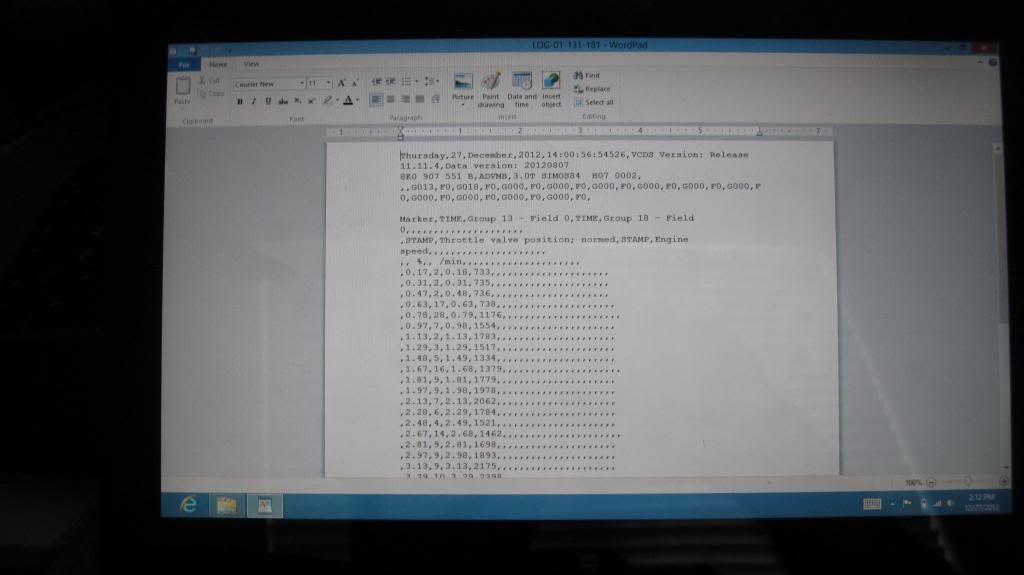

The first time I tried to install VCDS in desktop mode, it said it didn’t support NT 6.2 or something to that effect, but a windows box popped up offering some sort of compatibility mode. I clicked it and everything installed.
The app appeared to run well and I was able to do a complete Auto Scan of the car.
http://i153.photobucket.com/albums/s220/rev_martin4/Audi/IMG_2021_zps2fe58eac.jpg
Then I tried logging. I chose two fields, throttle valve position and Engine speed. I gave it varying gas for a few seconds and then had it stop logging. It created a log file with no issues and appears to have valid data. I don’t know how many fields it will be able to log at once with this low power CPU, but I didn’t see any problems with two.
http://i153.photobucket.com/albums/s220/rev_martin4/Audi/IMG_2025_zps8918a108.jpg
The buttons for all the features were large and worked will with a touch screen. However selecting the fields to log with the check boxes were a little less touch friendly.
If you can get a mount for a tablet like this installed in your car and route your vag-com cable and the power cable for it, then I think this could work well for you for logging at any random time.
-Skid
