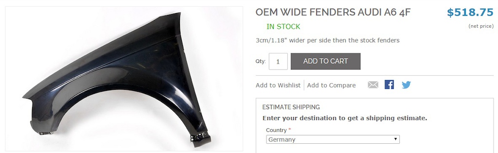

I guy in Europe has some custom wide front fenders for the A6/S6. Ill post some pics when I find them. Theyll allow you even MORE clearance up front. I just dont like the looks.
These front fenders are available from BKS-Tuning, and add 3cm to each side over the A6 (so 15mm per side over the S6).

I wonder if those are close in terms of width as the RS6 front fenders. That may be an option down the road, but need something better for the rear to match that upfront.
I also agree with the pulled fender look… not a fan at all or cambered out rears. not my style. My air ride won’t be to be extreme low, but rather not have to deal with Winnipeg’s crap roads (you’re in Toronto so compared to ours you roll on red velvet carpets) so I want the adjustability of the air ride. Like so many have said about the S6, it’s not a race car (no offense on your project…) and outmost comfort is the the goal. But I want to be able to drop her down while parked for a nice fitted look.
I’ve test fitted 19x10 with 235/35/19 and et35 and et25. The 35s tucked front and rear, 25s had the lip of the wheel flush with the fender. It will be tight, but again with air ride i’ll have lots of room for error. Now I’ll be looking at those fenders. Since I want bigger brakes upfront too!
