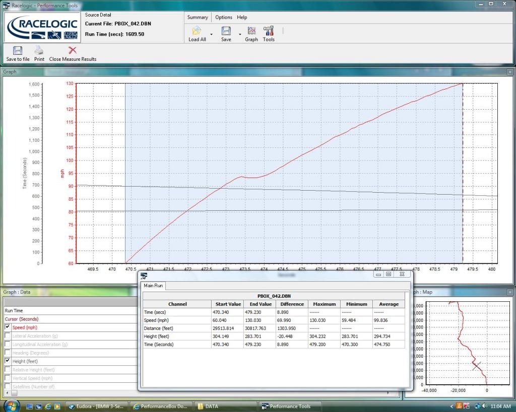

Some of you probably remember when I first came on here, and I was testing with 50/50 E85 blends. Well, we have since taken a large step forward and I now have a beta E85 file. The file has 0% fuel trims and we now have full switching available, meaning that I can change between pump gas and E85 and have all of my fueling switch with the press of a button.
I did a lot of testing of the timing maps at Shift Sector a few weeks ago, and at the time I ran a 9.43 60-130 (the fastest PJ K04 I have seen on AZ). Last night, I was able to do some more 60-130 testing with only a 1-shift run, and I put up back to back 8.8’s with a best of 8.85. This was my car in daily driver form, with the exception of the passenger and rear seats removed (~100 lbs)

The DA was 876, so I think there is a lot more in the car if I can get into the negatives one of these nights. I’m very excited to finally get this E85 project nearing completion, and the next step is a trip to Sacramento in the middle of December!
http://i805.photobucket.com/albums/yy338/temanuele91/B5S4VboxRun2.jpg
http://i805.photobucket.com/albums/yy338/temanuele91/B5S4VboxRun.jpg

These high 8 second runs were both at -1.5% decline (20 foot drop over a 1300 foot run) which is not insignificant. If the other 9.4 times were flat or at a slight incline, it could be a factor. Not sure how much, but we’ve seen 1-2 % changes influence times pretty heavily on the B8 guys who do some 60-130.
Couple with 1000 feet of DA and who knows how big the delta is.
Throw in the extra shift on the earlier run and we’ve got a threesome of fairly large variables.
Since we’re talking delta in time, we should make sure it’s a legit 6 tenths in similar conditions.

The 9.4 was on an airstrip, but the decline was about 1%. The DA was very similar there, as it was the same temperature with a 500 foot elevation (about the same as this run).
The main difference between my 9.4 and the 8.8 is that I cut out the 5th gear shift. This saved me from shifting at 127mph.
Like I said, the DA on this run was 847 (in SoCal we’ll never see -1400+ DA like the B8 guys on the east coast). You can see the elevation in the summary. And this isn’t so much a comparison of the 9.4 and 8.8, I am just showing where the car is at. It isn’t a before and after as this is the same file just with slight changes like the rev limiter.
