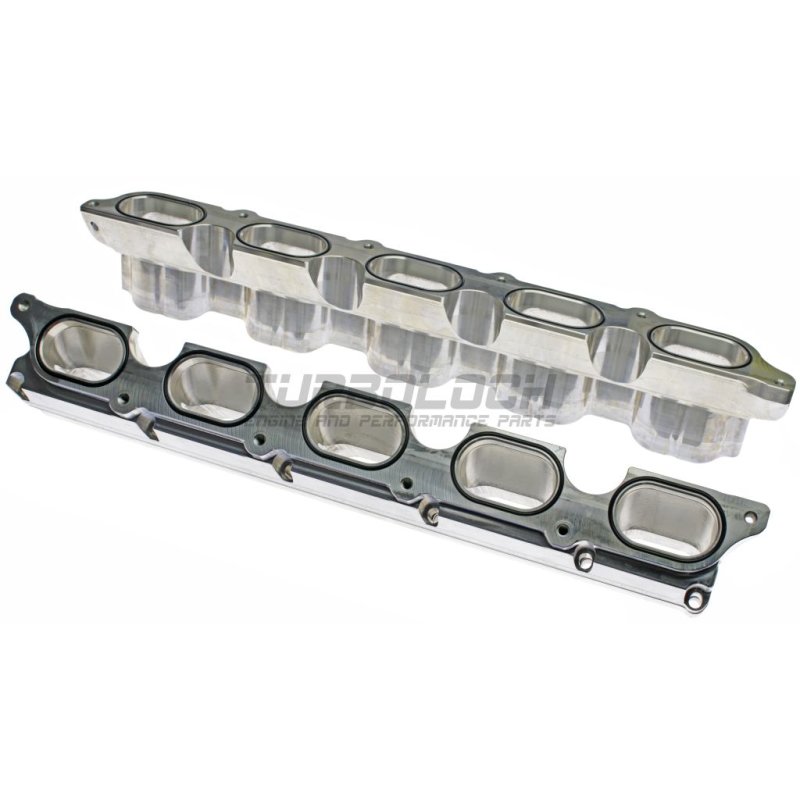

I’m currently waiting for the S6/RS6 intake manifold adapters from Germany, but in the meantime got a solid test fit (dimensionally, it’s right where it’s going to sit with the 81mm spacers + gaskets). As for the fuel rail, AMS already has one for the R8/Huracan! I just need to fabricate a solution for mounting it! I’ll update as stuff starts to trickle in.
STILL waiting on those adapters… I’m becoming restless just starring at this thing lol.
Does the intake manifold require the adapters
to fit, or are those adapters to add port injection? Really considering switching over to the rs6 intake, since my original is gutted and costing me power anyhow.
These adapters are absolutely necessary to make the rs6 intake manifold fit. They don’t have port injection already on them so I still have to create a system for that once I get them…
And goddamn are they taking forever; DHL says they just landed in the U.S.
Good to know. Do you have a link for the adapters. Love seeing something happen with the v10 platform. Keep on going.
Something like this?
Oem
@Kaclaytor You do not want to use the RS6 manifold if you are NA, if u think gutted OEM will cost you power, RS6 manifold would be waaay worse, it is explicit for FI application.
I have heard that, but have seen zero real world proof. So I think I will give it a shot with before and after draggy results. Biggest issue is lack of tuning options.
